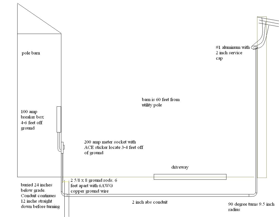

This property is 30 acres. There is my rental house in which my tenants rent from me. My pole barn I'd around 400 feet from thir meter. I say telephone poles because that is the terminology I am accustomed to. I guess utility or electrical poles would be the proper vernacular for it.
I need a second meter because I am sure my tenants that rent the house don't want to pay the electricity for my garage. If I lived herebi would not be putting a second service in but running from the rental house.
The electric company want the meter on my garage and they want to run from the telephone/electric/utility pole. I don't want overhead service because I have several tall pieces of equipment and with the line running directly over the driveway I don't want to worry about it. The electric company said underground is fine but they won't do it it's the customers responsibility. This is where this whole project came into play.

They stated numerous times that #2 was legal for service entrance cable for 100 amps. He said thated that I should use 1/0 between the meter socket and the breaker box because I wouldn't need to use conduit between them. The 1/0 service entrance cable is allowed to be exposed between them. What wire would you run the #2 or #1 betwen the utilit/telephone pole and the meter socket?
Would you run conduit between the meter socket and breaker box with the #2 individual wires or just run 1/0 service entrance cable?
   / Runnign 100 amp service to garage #49
I am an electrical contractor and we use aluminum feeder wires for supplying main feeds all the time. People haven't used copper main feeders for many years. just too costly.
That being said, i NEVER install direct buys aluminum wires...NEVER. I always install the wires into PVC conduit. Conduit isnt very expensive compared to having to redig and rebury direct burial wire a few years down the line. I have had to reapir many direct burial lines over the years and i truly believe only a fool would bury aluminum wires in rock filled dirt. As was stated previously. One nick and the wire will start to disintegrate.

Attched is my plan. Anything wrong with my plan you can see. i figured I would draw it out since there was some confusion
