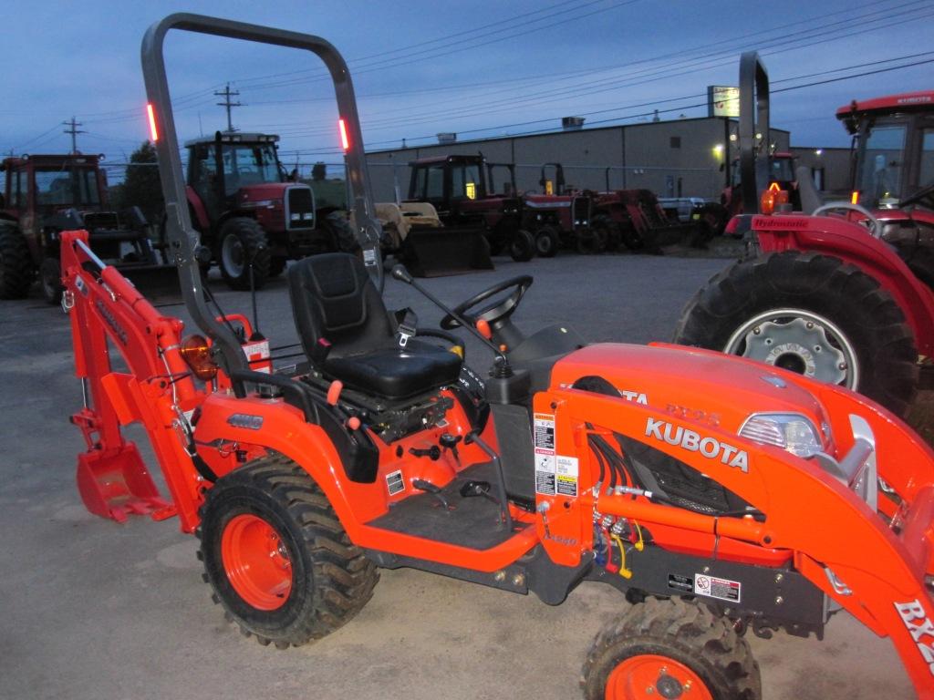

No need to rant at me, there's fault on both sides.
I should have been more particular before taking ownership, they should have either prepped the tractor better or disclosed the rust prior to sale.
I posted looking for honest feedback from the larger group to see if I was being over particular, or if this was normal.
I'd say the overall mix is 60/40 with most postings and PM's saying that this isn't normal for a brand new tractor.
Yes, I should have done a better job inspecting it, no doubt, but the rust is not in obvious spots, except for the roll bar, with the safety triangle mostly covered.
I asked the sales person before buying if they had a BX 2660 available to try out. They did not, I'm assuming that the tractor wasn't prepped yet, and was still crated out back. So I never test drove this unit prior to purchase.
In my opinion the dealership should have done a better job disclosing to me the rust and that it's been sitting out through last winter. Better than that they should have fixed it prior to letting me see it. But in their defense, there's a bell curve of owners and some would never have an issue with this. Some like me plan on keeping it forever, so cancerous rust scares me.
The fluid leak is not a checking on level surface issue. It's litterally dripping on my garage floor, and by the time I'd mowed three times, and had seven hours on it, the rear fluid level went from full to below the dipstick. When I parked it so they could pick it up, it was even struggling to make the power steering work.
I do appreciate the feedback. I am much smarter for this experience, and will know what to expect and do better in the future.
Thanks everyone, I'll let you know what comes of it,
-Jonathan

That would be a very bad dealer & you should get firm with them, .. you can see UV damage on the plastic which only means long outside stay,, maybe even salt damage,, You need to get much nasty with that dealer, ..My local JD dealer would have had another one delivered the next day if in stock. My local Kubota dealer would have swapped you out without any hassle, both the local Kubota dealers as I know them both & customer satifaaction is there # 1 priority. You have a crap dealer & you need to treat it as such, do not worry about pissin them off because you think you need them in future, you do not, take your warraty work to another Kubota dealer when all gets straightened out. I would not accept that tractor, in fact I would send the story & photos to other Kubota dealers & see what they would have done, In fact I would be so pissed about the attintude of them I would sue the SOB's.

Picture 4 looks like a bad place to see rust. I cant id exactly what that is but I perceive scaly rust on a shaft right up against a seal lip. Cant tolerate that!

Here's the latest update:
After picking up the tractor, the dealership called me and said they put a lot of time into repairing the rust and wanted to deliver it back to me.
I told them no, I did not want it returned, and explained again that I was suspect of this unit which is proving itself to be a lemon. I explained again that I don't believe that rust repairs in the field at the dealership will ever top the quality of a factory finish.
I did say I was willing to take the 2 hours of my time to drive to the dealership and inspect it.
I did that on Saturday.
The dealership put a lot of work into reparing the rust, and put a lot of new paint on the tractor, but did not go into details as to how much grinding they did... We compared this unit to a different new BX2660 on the lot which exhibited the same rust conditions mine had.
The dealership wanted to make it clear that they did not sell me a used unit, and weren't pulling anything over on me. I sincerely don't think they are, and have never thought that.
While I was there, I took that opportunity to compare it to a new "B" series unit sitting next to their new "BX" on the lot. The BX was all rusty, sun faded and looked bad. The "B" series unit was pristine and in show-room condition.
Back on "my" unit, I pulled the plastic insert molded nut off of the air inlet screen and the mower deck shroud and looked at the white galvanic corrosion on my BX and the pristine zinc trivalent chromium plating on the new B series unit.
I told the sales manager that I did not want this BX, and am still requesting a new, non-corroded, non-sun faded, non-repaired unit.
He said we'll have to wait for "Larry" the regional Kubota rep. to come back from vacation on Monday, and we can discuss this week.
