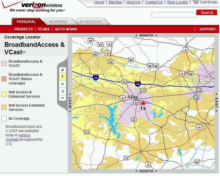

Eddie,
I wouldn't be surprised that by the time you get your park open, everything internet related will have changed. Right now, Sprint and Verizon are rolling out nationwide broadband wireless coverage. Look at this page http://www.sprint.com/business/products/products/map.jsp?map=Dallas_TX&mrkt=Dallas,%20Tx%20214 and you'll see that Tyler is not that far away from Sprint's expanding Dallas network. Yellow and gold are EVDO coverage areas (or soon to be) and green is slower (for now), but still faster than dialup. I'll bet Tyler will be orange within a year. (I have also attached a screenshot of the Verizon coverage map.)
Many RVers will likely have their own wireless card (or EVDO enabled cell phone) and account for about $60/month that will work for them at home or on the road. Coax and phone lines are "20th century" technology that I recommend you not invest in. I'll bet a single hotspot at your cafe, powered by a Sprint card and wireless router will be all you'll need. That's what I'm using now for my office, having broken my tether to T1's, cable and dsl. Sprint (unlike Verizon) doesn't have any limitations on bandwidth usage or number of users sharing a connection via card and router, and they encourage business use.

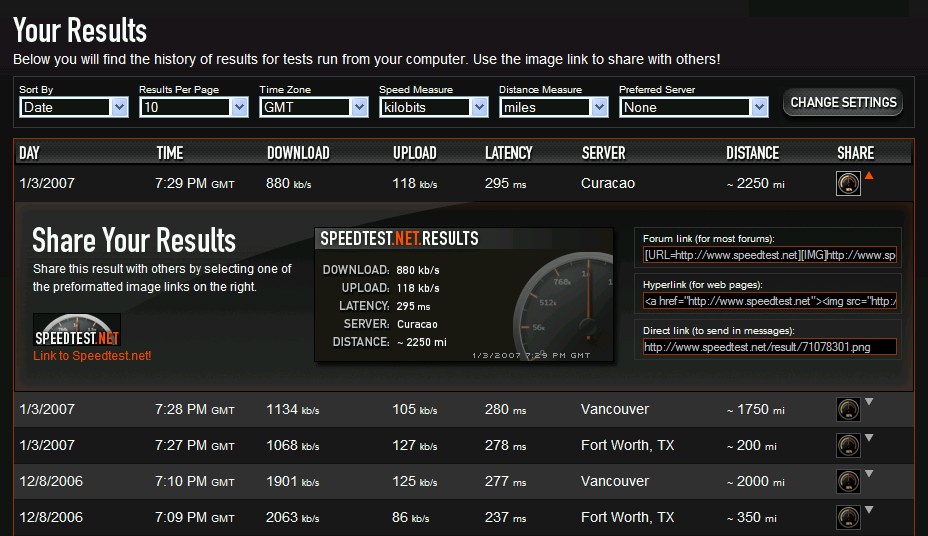

I have four computers linked to the router, 3 via Cat 5 cable and one via 802.11g wireless. There is no difference in the throughput when I use the card in the router or plug it directly into my laptop. I am using the Merlin S720 card and the Linksys WRT54G3G-ST router. Here's a page with links to both pieces of hardware - Sprint Mobile Broadband Solutions - as well as a brief description of their network.
Speed depends on several factors. EVDO is faster than 1xRTT, and Rev A EVDO is faster than Rev 0 EVDO. The closer you are to a Sprint tower, the faster it is, and the number of people sharing a tower connection also impacts the speed. Dallas is currently Rev 0 (although I understand that Verizon is now Rev A here), so the upload speed is limited to a theoretical maximum of 150kbps (I think) and download of 2.5Mbps. Rev A ups the download a little to 3.1Mbps, but will dramatically increase the maximum upload speed to 1.8Mbps (a 12x improvement). But no one will advertise those speeds, because it will be nearly impossible to achieve.
I am about half a mile from a Sprint tower, and get in the range of 1.0-2.0 Mbps down and 100-125kbps up. The upload speed isn't a problem for our applications, but once Rev A rolls out, I anticipate that should jump up to the neighborhood of 500kbps. Another big plus for Rev A is that latency will be drastically improved. Again, that's not a problem for me, but it might be for gamers or VOIP users.
Before I switched to EVDO, I was sharing a T1 line in this building with another tenant, and I have to say that I can't tell the difference except when I go to upload a big file. Also, we don't experience any (perceptible) slowdowns when multiple computers in the office are accessing the network at the same time.
Here's the site I use to test the speed Speedtest.net - The Global Broadband Speed Test and I have attached a screen shot showing some recent tests to different servers. The Sprint connection is "always on", but probably goes dormant when not being used. We don't even power down the card/router except on weekends. As far as I can tell, we haven't had any downtime in the four months since I switched. As I mentioned earlier, Sprint has no bandwidth usage limitations, and actually encourages sharing the connection by marketing the router.
