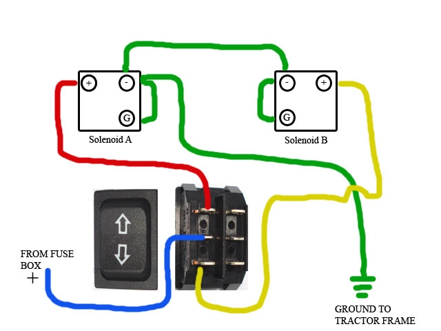

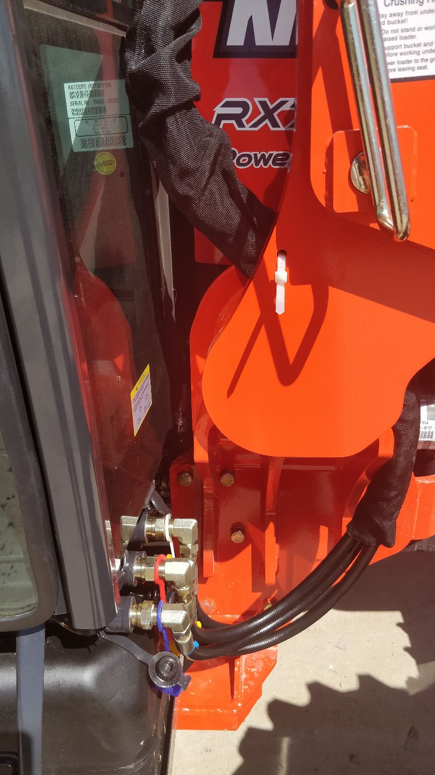

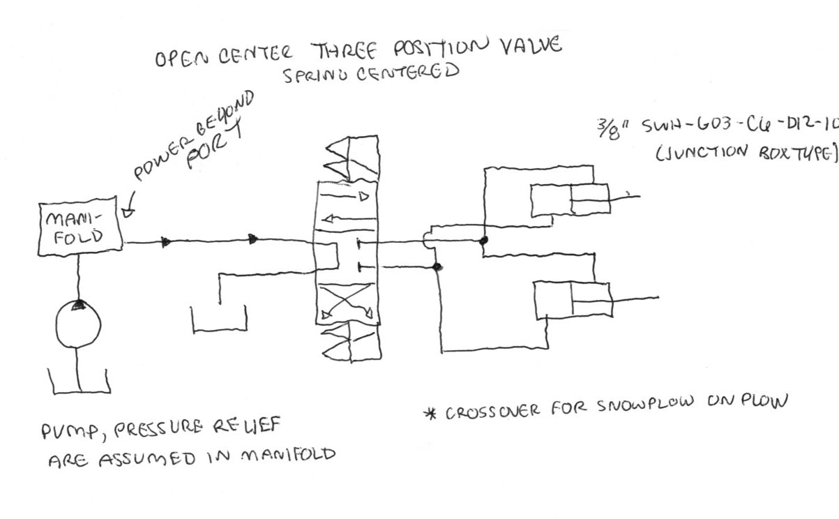

In order to use multiple functions AT THE SAME TIME, the joystick valve must be piloted, and ours are not. You can feather the joystick a bit, but under load it is pretty much one function at a time. With two buttons on the electric over hydraulic diverter valve, effectively, whatever ram has the LEAST RESISTANCE will receive the fluid. Again you can sort of feather things, but under a load, it is pretty much one function at a time. That said, I really like the home-made setup I made as it looks like the third function the factory should have provided with hardlines, custom-fitted hoses, matching hardware, et cetra, but never did.

This is from 2014.
30' of Hopkins 3/8" split-loom wiring shielding (Source Northern Tool, or etrailer http://www.etrailer.com/dept-pg-Wiring-pt-Wire_Loom-co-3%7C8_Inch_Diameter.aspx $3.89 plus shipping of $4.99
1 Metric-pack 150 series 3 conductor connector set 18-16 GA. Meripack (Delphi electrical connector.) (Ebay Unit cost $6.34)
1 Metri-pack 150 series 2 conductor connector set 18-16 GA. Metripack (Delphi electrical connector) (Ebay Unit cost $5.64)
Low-profile mini fuse add-a-circuit (source: Amazon unit cost $6.99)
Inline Bussmann water-resistant (marine style) 30amp fuse holder. $7.00
Blue Sea Systems waterproof in-line ATO/ATC fuse holder (source: Amazon unit price $9.98)
2 solid state Relays
2 Relay sockets. AGT five pack 30/40amp relay harness SPDT 12v Bosch style, five pack (Amazon $13.95)
1 relay bracket
2 Rubber grommets. $8.00
John Deere Control grip handle. Part number LVA13698 (Unit cost $165.00)
2 6x1mm bolts
2 6x1mm nuts
1 6x1x16mm bolt to mount relays.
2 rolls of 3M Super 33+ electrical tape.
Daman D03 Subplate. Daman part number AD03SPS8S unit cost $79.01 from the hydraulicstore.com
Suggest using Locktite 545 or 5452 on hydraulic line fittings. (5452 Amazon Unit cost $54.80)
2 sets of 3/8" NPT Agg Coupler nipple style
2 45° NPTM to NPTM elbow.
1/2 NPT Agg coupler. Fleet Farm $17.49
2 1/2 NPT male to 3/8" NPT female adaptors (Fleet Farm unit cost $1.99 each)
3 SAE 6 o-ring male to 3/8" NPT female swivel 90° elbows
1 SAE 6 o-ring male to 3/8" NPT female swivel adaptor.
2 3/8 NPT male to threaded locknut JIC adaptors.
one custom loader bracket.
4 3/8 hoses.
Soft loader hoses
I used a length oh hose dropped where I wanted it to get the length and had my local hydraulic jobber shop make my custom hoses.
3/8" x19 female swivel BSPP to 3/8" female swivel NPT on 55-3/4" overall 3/8" hydraulic hose.
3/8" x19 female swivel BSPP to 3/8" female swivel NPT on 58-1/4" overall 3/8" hydraulic hose.
1 M6 x (1.00mm) x 85mm flanged stainless bolt (source: Amazon pack of five $28.60, unit cost $5.72)
3 M6 x (1.00mm) x 70mm bolts. (via BoltDepot.com 12@ $12.43 = $1.04 unit cost)
4 Kioti hardline spacers. M7530-85111 Tubeline clamp (4 @22.00 each totaling $88.00) These are way, way cheaper from everywhere nowadays.
1 2-line spacer (Custom Hose Tech, unit cost $11.98) line spacer to be painted.
John Deere 4000 series front fender kit LVB25685
That said you may need a D05 open center sublate and solenoid switch so look at your tractor's hydraulic flow.
  • brackets copy.pdf
