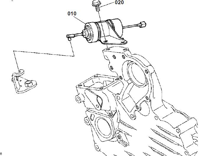

:thumbsup:LD1Found it! I took the side panel off and sure enough there it is. It is a spring loaded lever. I turned the tractor on and moved the lever over and Walla! The tractor shut down immediately. Now that I know where it is, it will be easy to reach under there and turn it off. I may put a small extension on it and paint it redso It is easy to see and locate. Just in case I have to tell someone else how to shut it down in an emergency that may be using my tractor.
Thanks for helping me out.
I also did call Kubota at the Northern branch in Ohio. I am happy to report that the assistant manager of service, Dave, called back and was very knowledgeable and helpful regarding this whole situation. He did reaffirm that the HST switch is not put in the tractors in the USA, but use the same wiring harness and suspects that there is a short somewhere in that wire. I am now going to go out to try and find that. Thanks again for all the help on this forum. This is very valuable.

Is this it, or is there a lever that pulls on this? It's identified in the parts manual as the Stop Solenoid.
