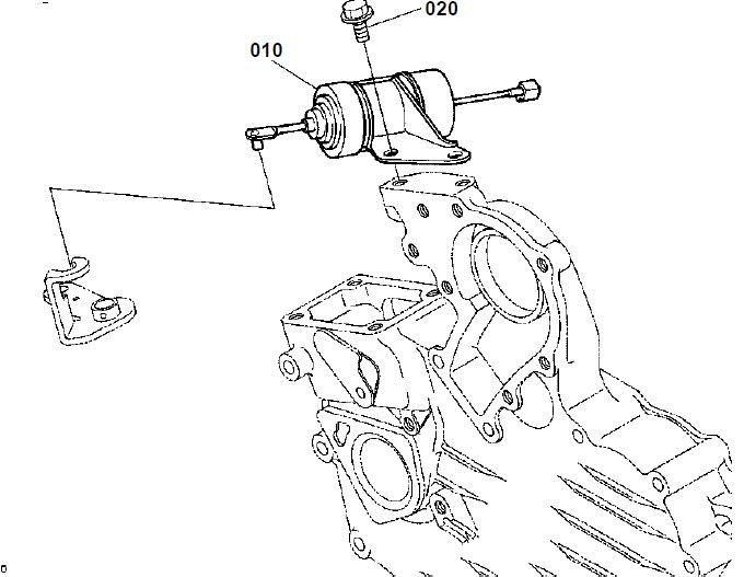

Is this it, or is there a lever that pulls on this? It's identified in the parts manual as the Stop Solenoid.
No I don't think that is it. I will try to get a picture of it and try and post it on here. I have never posted a picture on here, but will try to do that tonight.
This may be helpful for others that need to shut down the machine quickly. It definitely works instantly. It would be very simple to put a little cable on here and be able to control it from the seat in the tractor. It is strictly mechanical and requires no electricity. My motto is KISS. It works for me.
Thanks for responding. This forum is great.

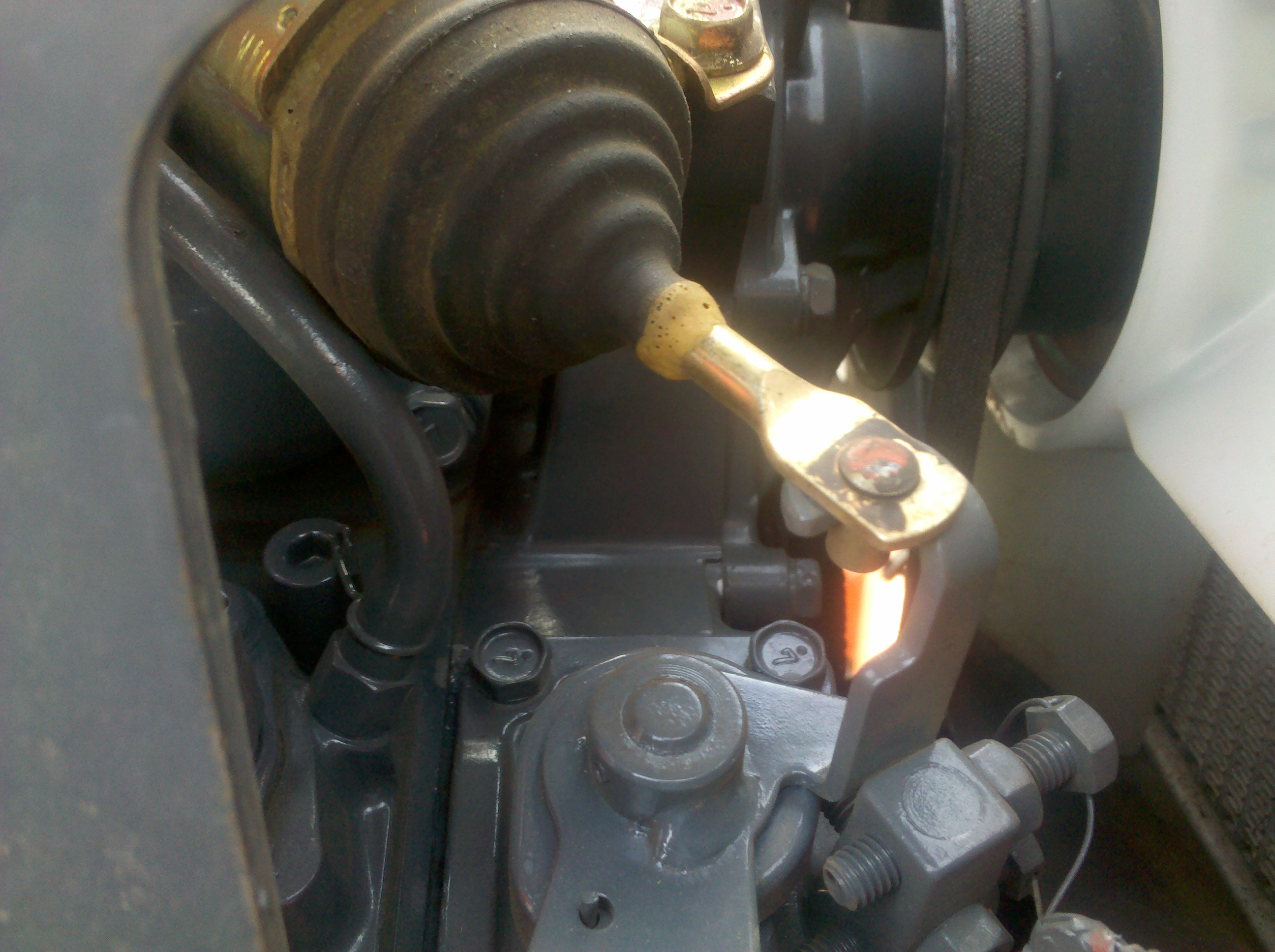

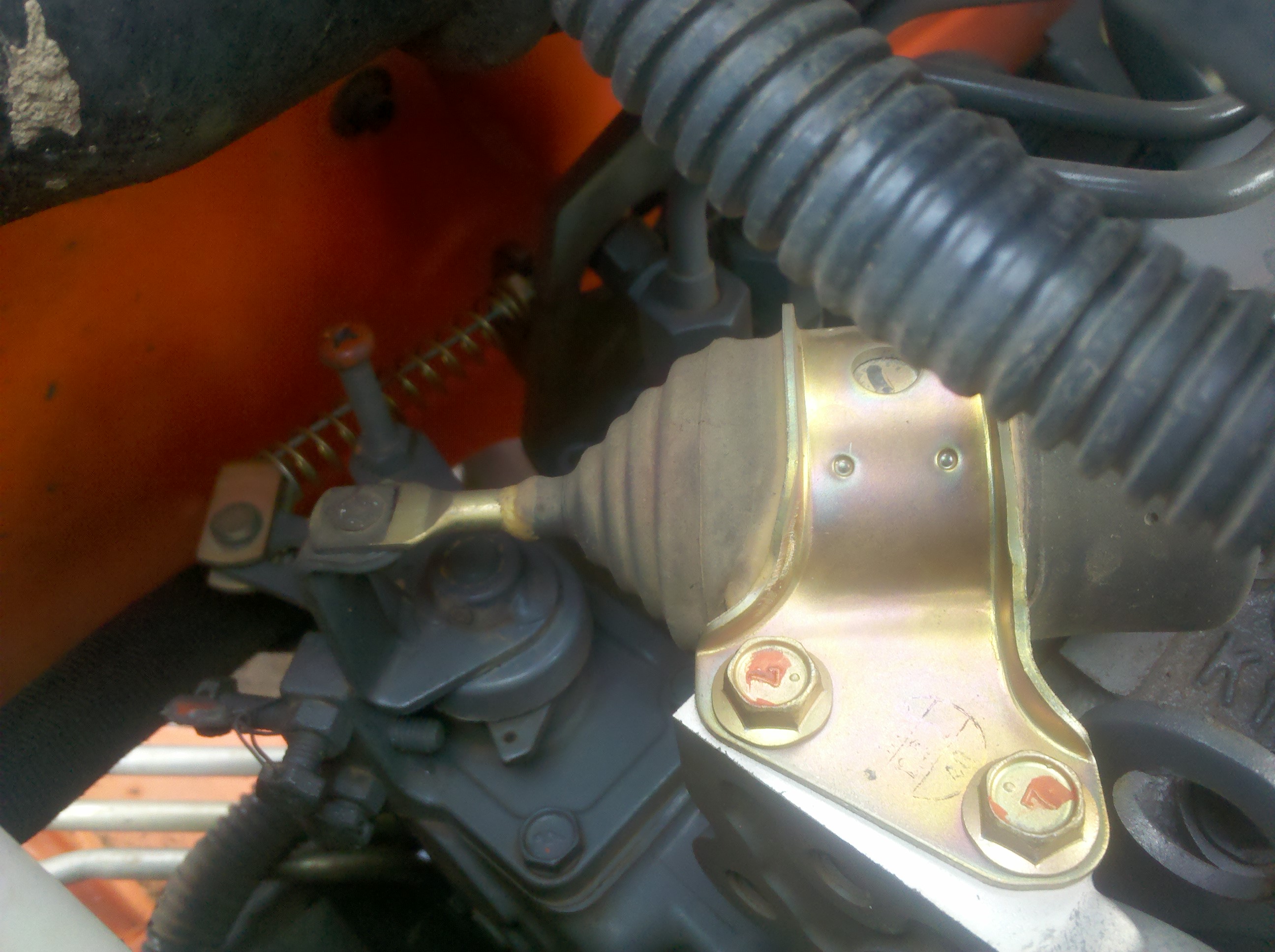

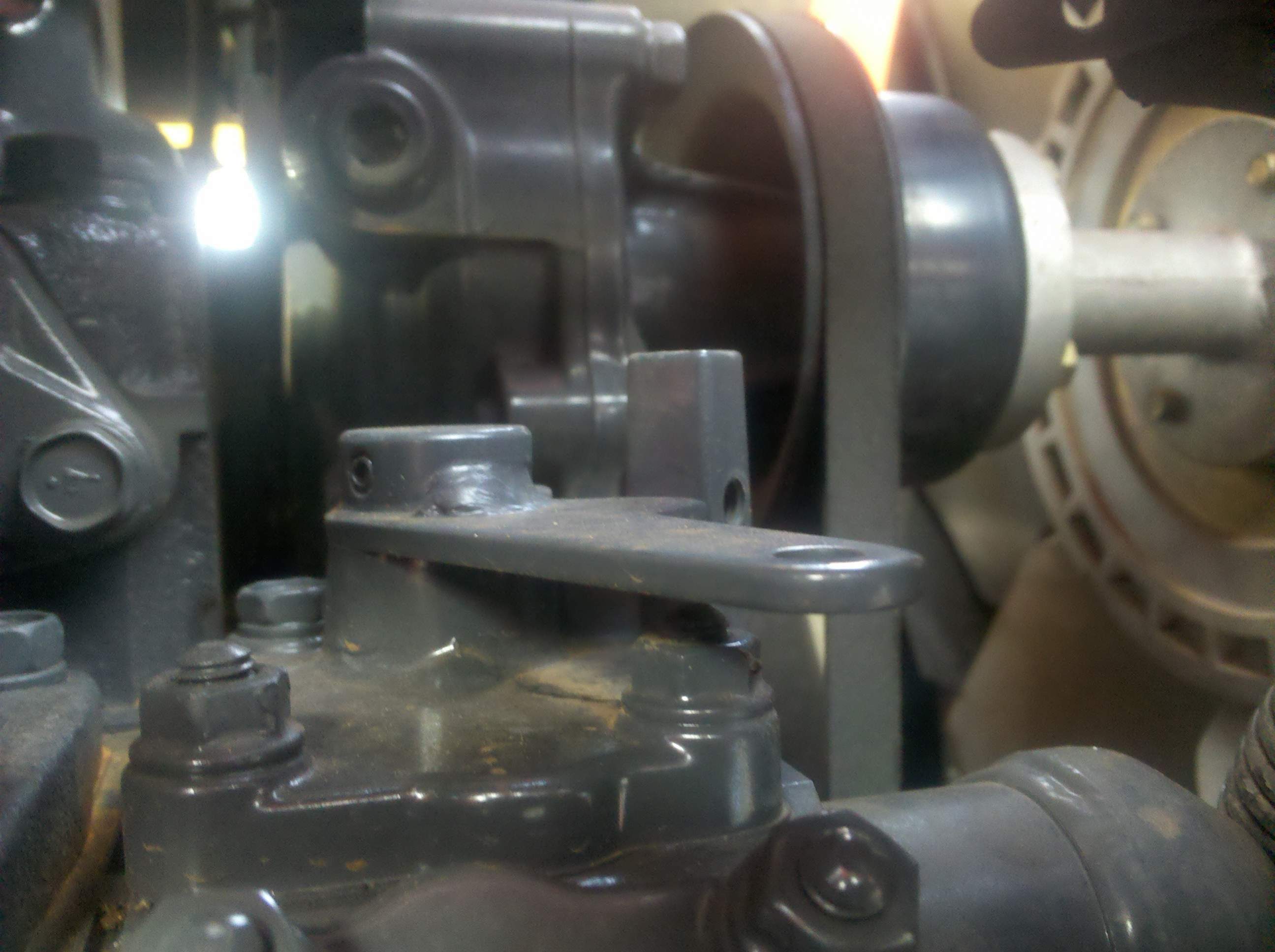

Anyway here are the stop levers for a BX2230 , G2160 and Grand L3130, the RTV has a load of wood so I cannot get it.
