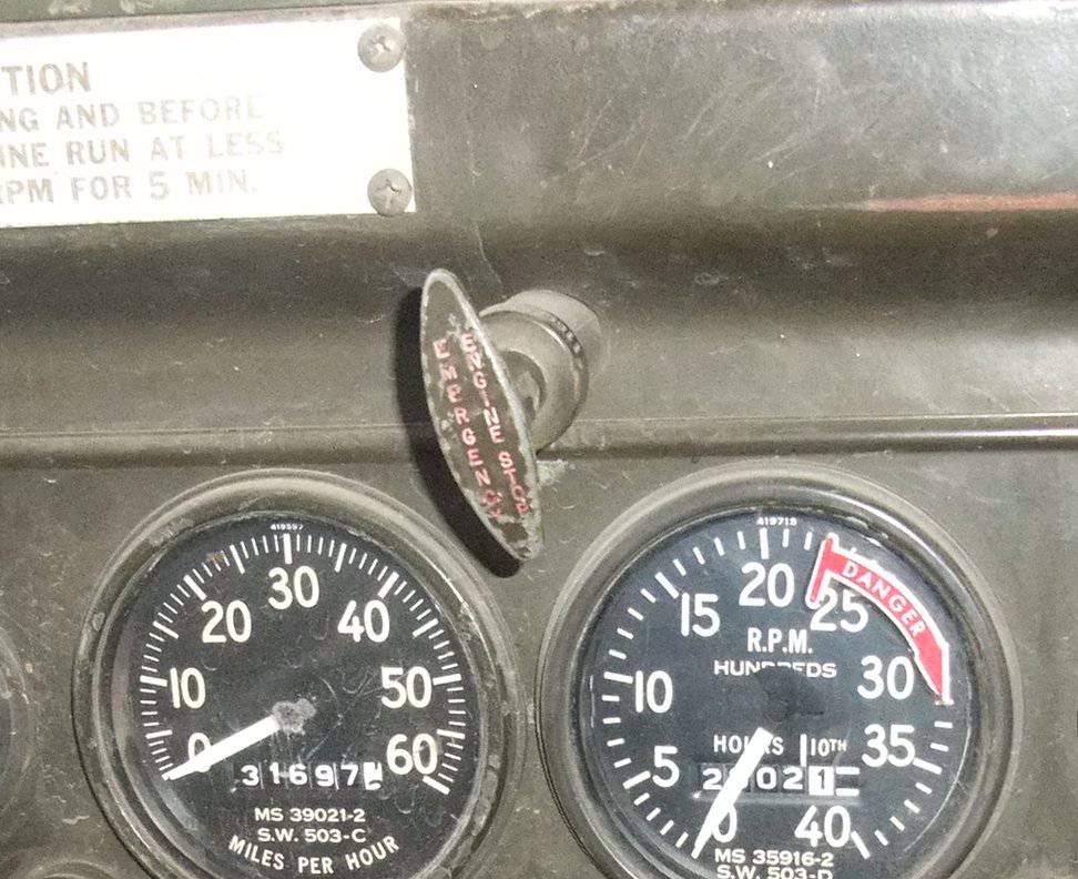

I'm a little late to the discussion, but if anyone is worried about shutting down their tractor in an emergency, find one of these pull levers and wire it up to the I.P.'s cutoff lever.
attachment.php
