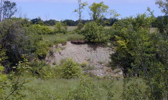

Re: Safety Tips- Brush Hogging with hidden hazards
Case Report: 02NY023
Steep hidden bank of occurrence
“…On Tuesday, April 16th, 2002, a 72-year-old part-time farmer died as a result of a tractor overturn. The victim had been brush-hogging the outer edge of a pasture when the tractor was driven onto an embankment that gave way, causing the tractor to roll over. The tractor rolled down the embankment, crushing the operator during the initial 180 degrees of rolling. His brother, who heard the crashing sound of the tractor rolling down the embankment, discovered the victim soon after and had someone call the emergency squad, which responded within minutes. The county coroner was called and pronounced the victim dead at the scene… “
“…The victim had been involved in agricultural work his entire life…
…As he turned to the right, the right side of his tractor came dangerously close to a thirty-five foot drop embankment that descended at a 75 degree angle…
…There was no rollover protective structure on the tractor…
…Upon overturn and contact with the ground, the operator's chest and back were crushed between the fender of the tractor and the ground…”
The rest of the tragic story…
