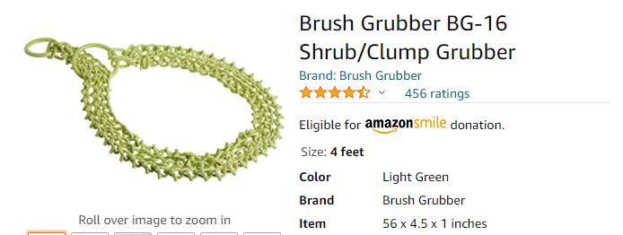

New tractor owner looking for some advice. I have an issue around my pond with some plant I can't recognize that likes to grow right on the water's edge. They can get quite large if left unchecked. I let them get a bit out of hand last summer and had to spend many hours with the chainsaw addressing the issue over the winter. Now there's small stumps and the freaking buggers are starting to come back again. I'd rather not have to back a bushhog up and down the bank over and over and larger the batwings seem like a bit much for my needs. Anyone have any suggestions? would a flail work well?
Note, my tractor doesn't have remotes or a 3rd function, but I've considered adding them, if needed.
Also, I'm aware of the laneshark, but I'm seriously wondering if it's worth the price. For most of my cutting needs, a bushhog would work very well. I only need something like this for the pond banks.
The pond is roughly 5 acres. Some of the bank edges have a ~1 - 2' drop to the water.
You may have too much to do with a pond that size, but here are a couple things I was looking at for use with my very small tractor...
or
   / Saplings and brush around pond banks. Suggestions? #93

My experience with the propane weed burner does little to reduce re-sprouting, especially of woody brush. I've used the backhoe to loosen soil around larger olives and honeysuckles ... to be grappled/grubbed with less dirt among the roots. I do a lot of seat-hopping when working the shore, cheat by having three machines vs swapping implements as often.

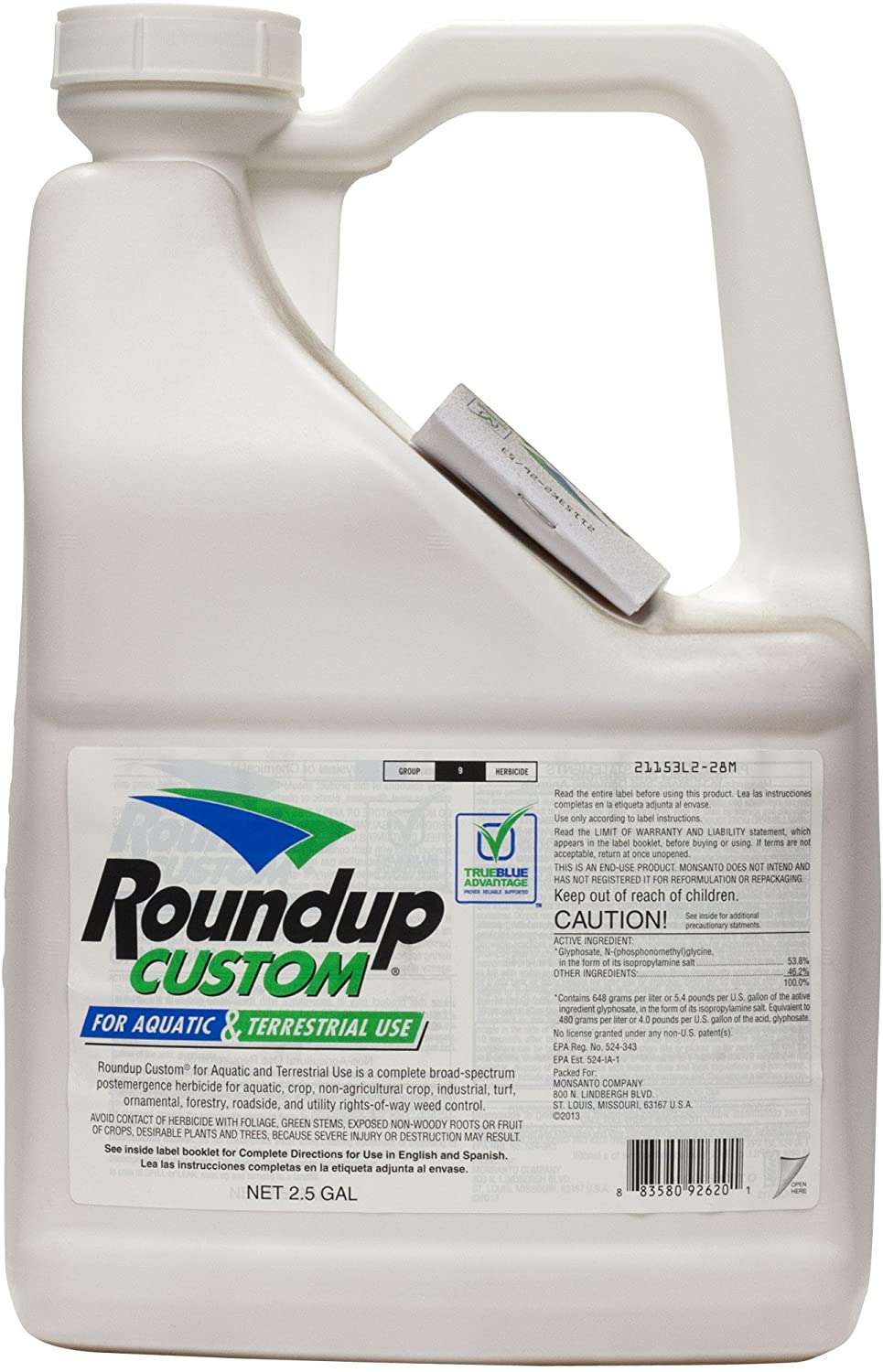

I agree on Remedy / diesel for cut stump treatment. I put some in a quart spray bottle and treat each stump as I cut it off.
My red dyed off road diesel .. makes it easy to see treated stumps.
BTW .. Roundup Custom is approved for aquatic use. Always use a non-ionic surfactant with it.
