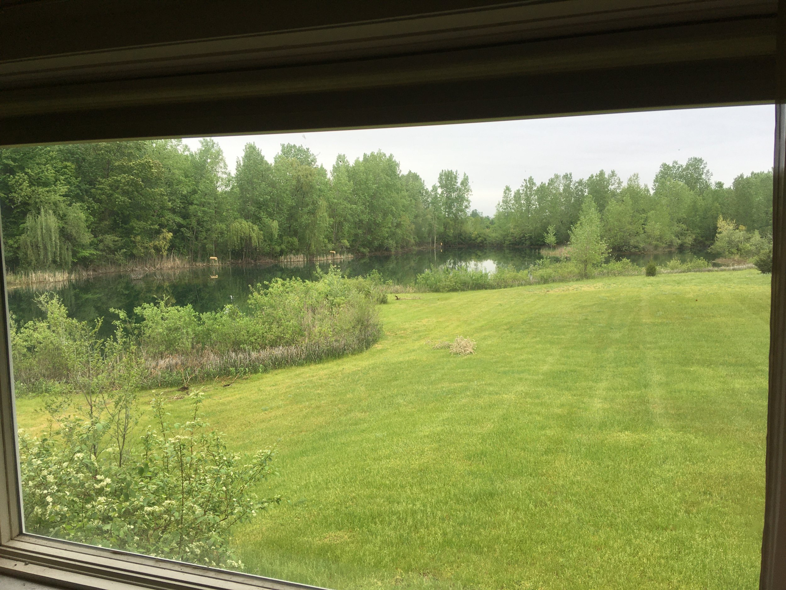

Here's what I have today looking North, with a few gribbed olives on the lawn that didn't make it onto the last fire. Most all of the East shore is shown here where I grub, dig, or cut with tractors, grapples, and the Terramite. Not far from the near mallard tube is a bit of remaining phragmites. It once covered the entire West shore before I learned to manage it by spraying from the water. A different profusion and a different method than grappling. It would have shown at the left of the pic at one time.
When I moved in ('01) there was just a patch of phragmites by the wood duck box way in the back. By the time I retired ('06) I had to learn what is is and how to deal with it. Were I not pulling willow and poplars there would be no view of the water from the house by now. btw, I do mow down to the water in a few places, one flail-width for fishing access where we seniors with bionic joints can walk down to the water and set up a folding chair. Anything >1" diameter or so is grubbed out first.
