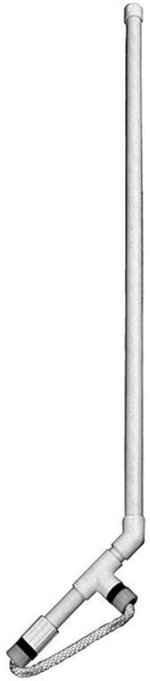

I paint ALL cuts with 2-4D and or Glypho. Just took down half a dozen 3"-6" poplars from the island before ice out. There were several stumps I'd cut years ago that had re-sprouted, I cut 'em off again below the sprouts and painted them too. Willow will be the toughest to pull and I recommend grappling or cut and spray. btw, this guy is a pet tool when clearing an area, esp if cutting brush with a lot of small stumps. Works good to wipe on leaves (vs spraying) in tight quarters what isn't easily pulled.
