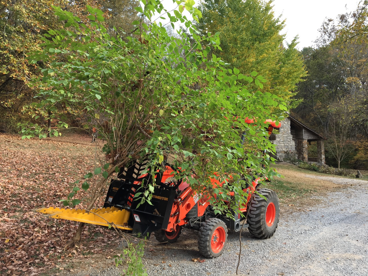

Mine is on a FEL for the Summer. (y) Pulled half a dozen olives from shore last weekend and tossed 'em on the fire.
It has quickly become one of my favorite implements out of a dozen or so I've got.
I can use it to move small boulders without having to put the rock grapple on as well.

Danuser Intimdator makes easy work of olive, privet and rose. Willows have root systems larger than their crown. Tend to take a bit of the shoreline with them. Roots break pretty easy. Once clear the cutter of your choice will maintain.

My point about willows. You have to be judicial when pulling trees. Cut and kill sometimes the best option. Big advantage with the Intimdator is the ability to excavate and break/cut roots prior to pulling trees leaves less ground disturbance. Made to back drag filling the hole. Expands the ability of low hp tractors.
Just one of many options.

Smokydog - looks like your tractor is trying camouflage. How has the Intimidator been working for you. Went to local dealer web site to see how it works. If you don't mind - what was the cost? Thanks - Oosik.
