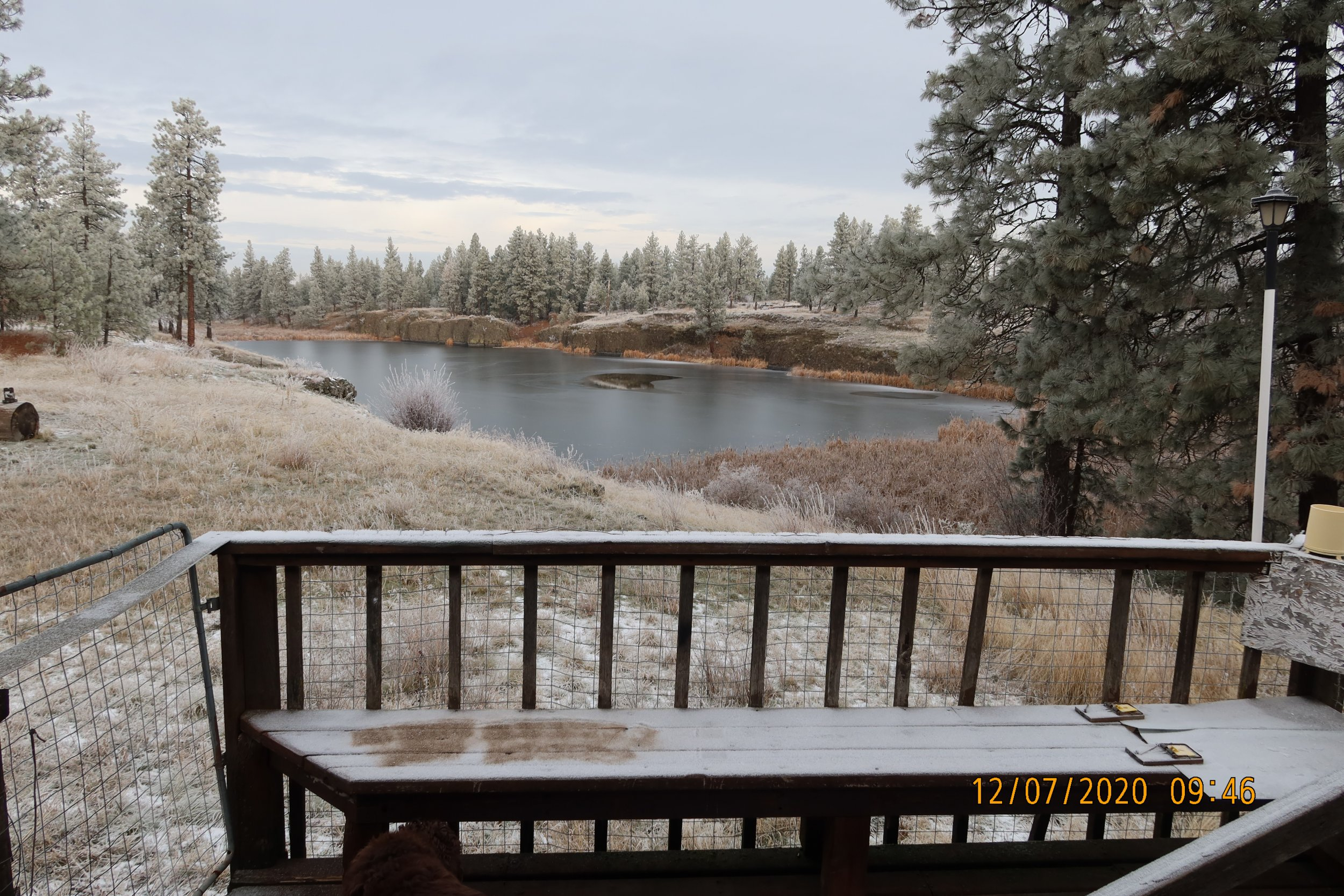

A picture would really help. This is my ten acre lake. There is a 35 to 40 foot vertical drop to water. The water at the cliff face is 45 feet deep. I have a 50 foot set back in those areas where I can even get near the lake. I keep "whatever" trimmed down with my chainsaw.

Dayum, thats one beautiful lake. I used to love high diving/cliff diving in my crazy days.
Got any good high dive spots with deep enough water?

A picture would really help. This is my ten acre lake. There is a 35 to 40 foot vertical drop to water. The water at the cliff face is 45 feet deep. I have a 50 foot set back in those areas where I can even get near the lake. I keep "whatever" trimmed down with my chainsaw. View attachment 699553
First photo I've seen of your alligator.

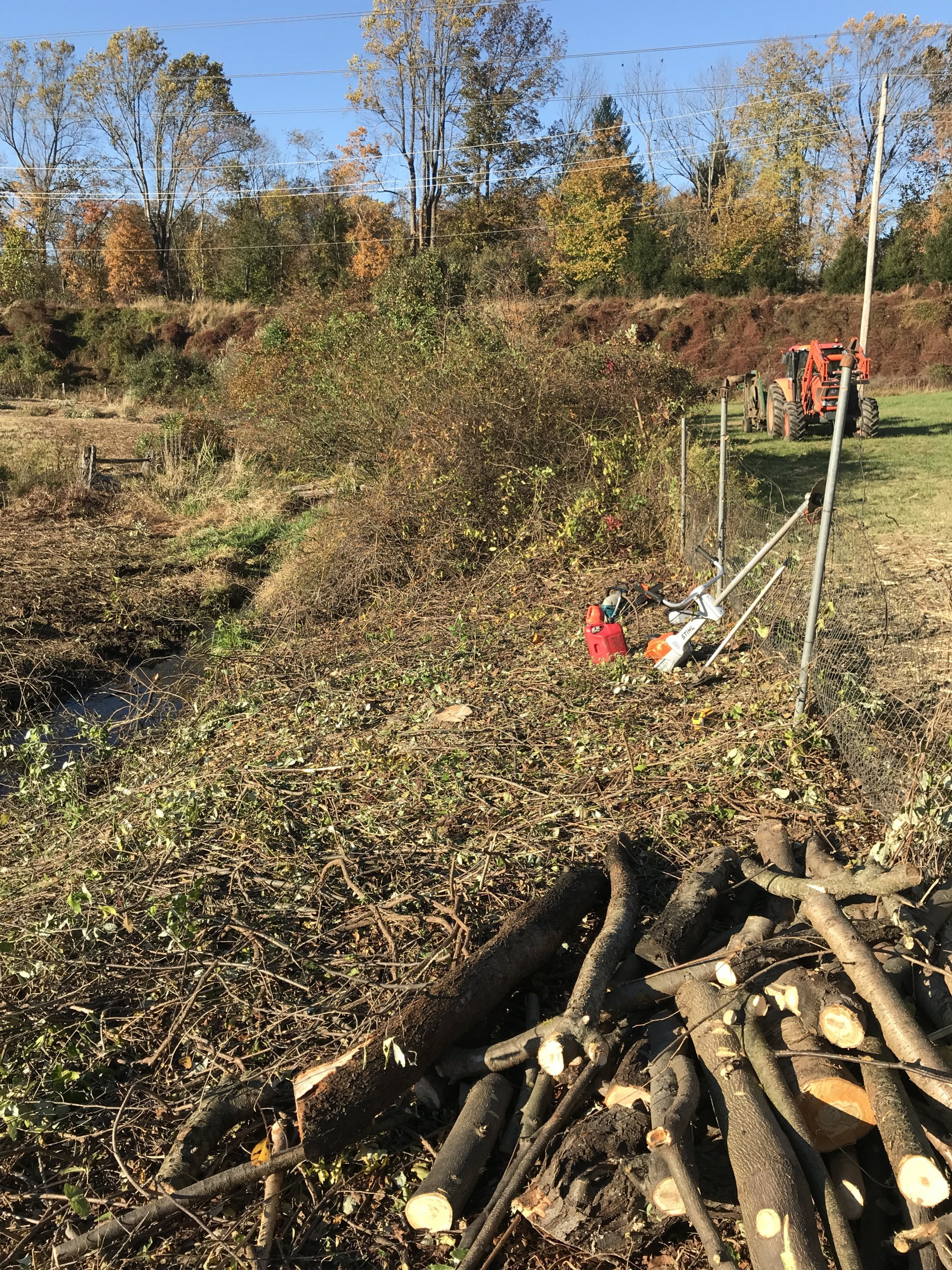

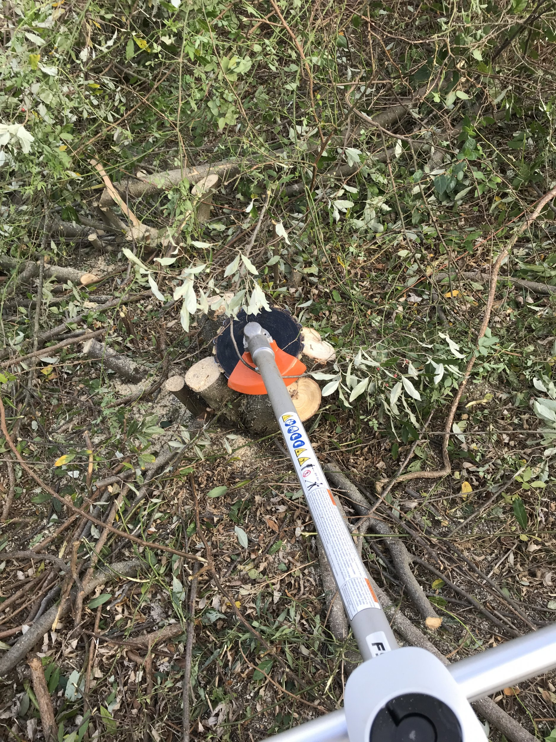

Thats exactly what I’m suggesting. A weed wacker, even a Stihl FS91 with a blade can clear acres of small stumps. I have an FS550 forestry saw.
You thought I meant a circular saw blade? Lol
And BTW, the brush saw blades fragment, too. I had a piece of one removed from my neck last year when my brush saw struck a rock. Surgeon removed it for me.

I had no idea what you actually meant. But a weed whacker is not a brush saw, though there is a lot of resemblance. It is now clear to me that you are aware of the difference. I just wanted to make sure the OP (or anyone else reading this) did not misinterpret your post. There are those who have seen a brus cutter and tried to convert their string trimmer by using a table saw blade.
I've had a carbide tipped blade shed some chips when using it - but I don't like their cutting performance, or the fact that a typical user can't resharpen them, so after that one trial, I don't use them anymore. I've never has a steel brushcutter blade have pieces snap off
