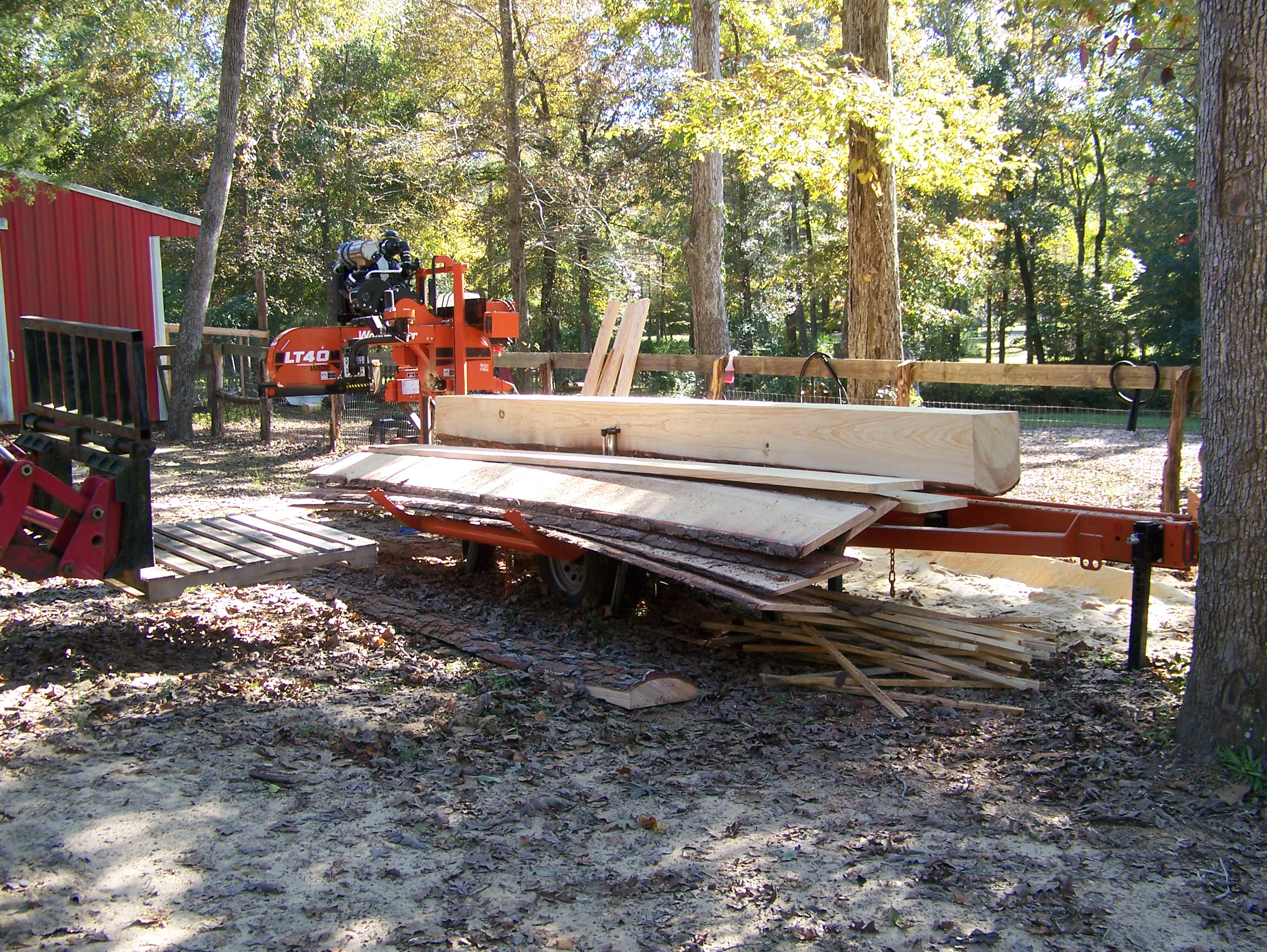

How about some photos of your Hudson sawmill. I love sawmills. Mine is a bit newer. 11-10-19 Cutting Premium Yellow Pine.jpg
hugs, Brandi

How about some photos of your Hudson sawmill. I love sawmills. Mine is a bit newer.View attachment 673339
hugs, Brandi
Brandi,
That is a fine looking mill. Is it a woodmizer? I have heard some pros and cons as far as the bandsaw blades coming into contact with metal objects? Not good for any type of blades but is it one and done? How much for a blade? Thanks!

It's a Woodmizer LT40HD Wide (cuts 36 inch wide) with a 35hp Yanmar diesel on it. I have ate nails before. In SYP, for me, one nail doesn't kill the blade ,but you want to change it because the blade starts to wonder in the cut. It basically kills the blade. Usually when I think a log might have metal in it, I run my metal detector wand over the log. It's just like airport security uses to check you for weapons.
I am just learning how long to leave the blade on before changing blades. Too long a duller blade zaps the blade life. Better to take it off and put a new one on. Woodmizer's Resharp service has a fast turn around. I have about 45-50 blades. They cost about $12 to 20 or so each. Depends on what tooth type and material blade you get. Also different blade thicknesses and blade width. I haven't sawed that long and have been sticking to one type of blade that works for me.
