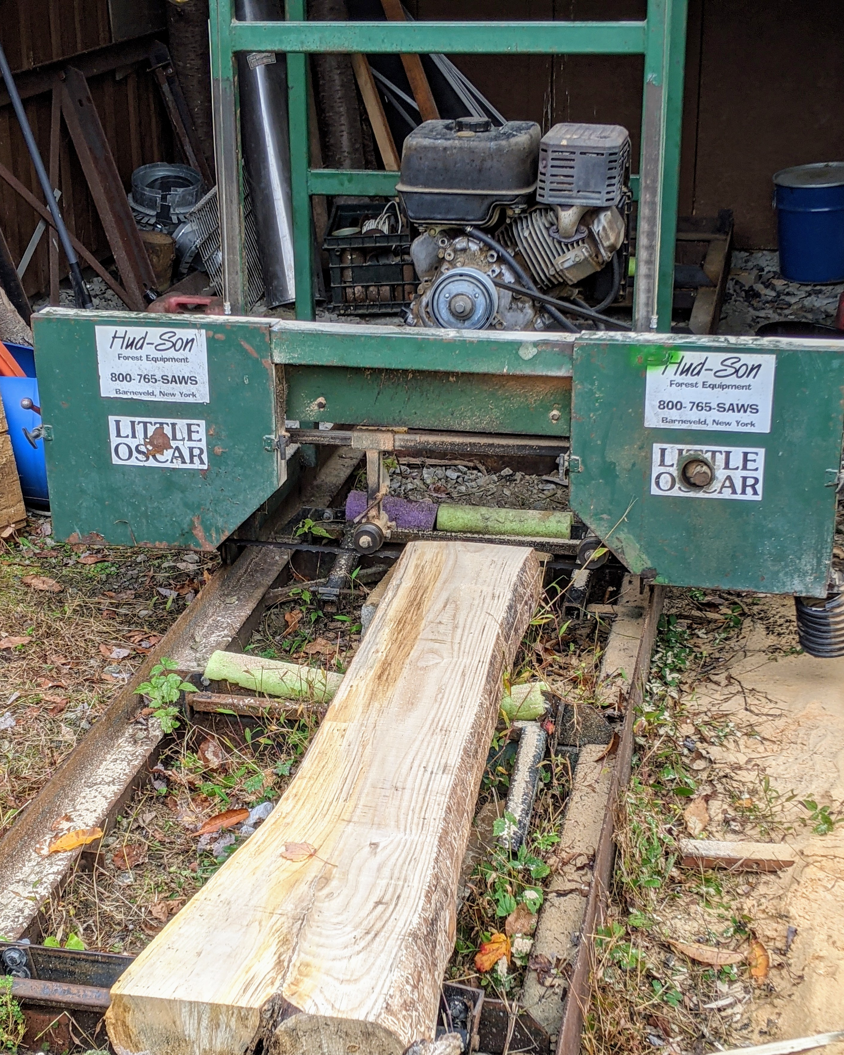

Here's a picture of the sawmill. Its a much older hud-son, but works great. Once I leveled the base it cuts like a dream. I just wish I could load a larger log to mill.

That sawmill looks like it cuts just fine. I have always wanted Runners, but stick to just flying Mallards.

The mill took some tweaking, I had it all leveled but after cutting a few times the weigh of the logs pushed the frame down into the modified. I was getting boards that were a bit off. So back to leveling and its back to squared up logs. I have a floor jack that fits right in between the sections and I can jack it up and add some gravel where needed. Do you mill a lot? What is the majority of your milled wood used for. Right now we are building a maple sap house, but its going to be as much field stone as possible on the base. Going to take a while but it will be worth it.

I bought the mill to build my log home. But I have cut 2x6s and 2x4s for the guy that brings me logs, lumber for my friend's deck, a base for my off road diesel tank, framing lumber for another friend's storage building. Red Oak shelving. Just started planing some stuff, so eventually sell some. Also barn purlins when I enclosed the barn's shed.
Have started cutting 16 foot 6x6s for sawmill shed posts.
Tweaking and leveling way less is what lead me to buy a Woodmizer mill. I don't move it, but after moving, you can be sawing in 10 minutes.
