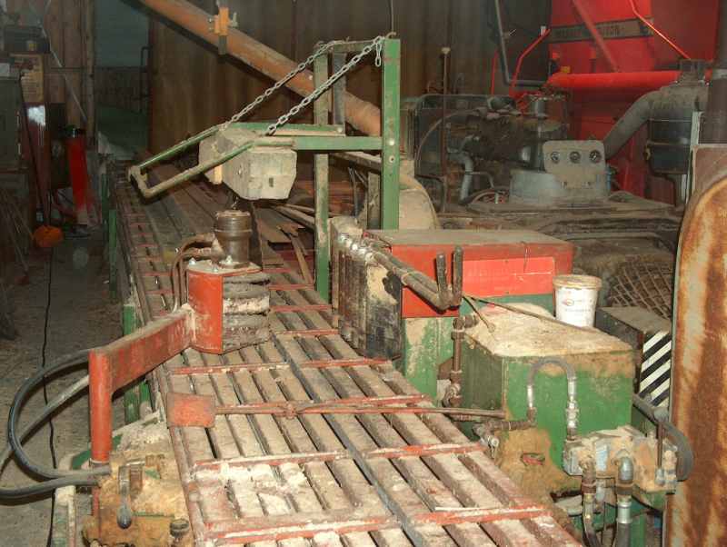

My mill is powered with an old Scania Vabis bus motor, it is fed wit a hydraulic motor and a wire. The oil that feeds the movement is the same that goes through the "push roller", syncronicing them that way. I bought the mill, just made the power equipment myself

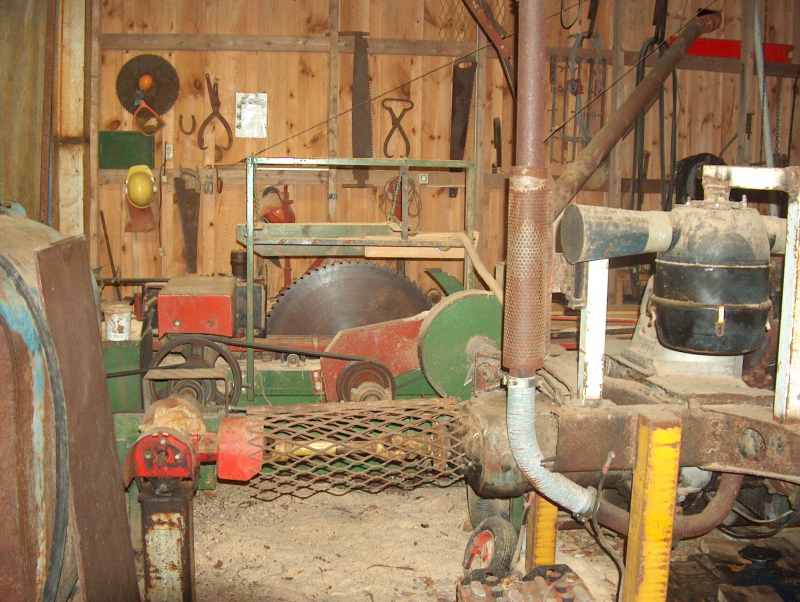

one more pic
