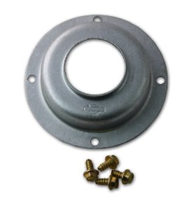

I'd say both:
A bunch of the guys trying to quiet down generators user a deflector that screws on to the regular muffler (at the four threaded holes we see in yours) as a starting point to weld on another exhaust pipe and muffler, either from a compact car or small tractor. Some autoparts stores have 90 and 180 degree bends of exhaust tubing in various sizes, might make for a little cleaner look than the cast iron elbow...?
Deflector style some people start with:
Tractor supply has flapper caps down to 1-1/2", and even if that's too big you could look at what they have and base yours on that.
I'd suggest leaving a way to allow for a little flex and expansion in the exhaust if you add another bracket, to help keep the welds from cracking or busting off the original muffler. Something like one of the universal muffler hangers that uses a rubber strap might work.

I'd say both:
I ended up doing that. I bought a piece of 1-3/4" j pipe from jegs and a cap from farm and fleet. Made a flange like the picture. Problem is, vibration was too harsh and the screws pulled out very quickly. I will have to make an additional mount. I'll figure it out later.
