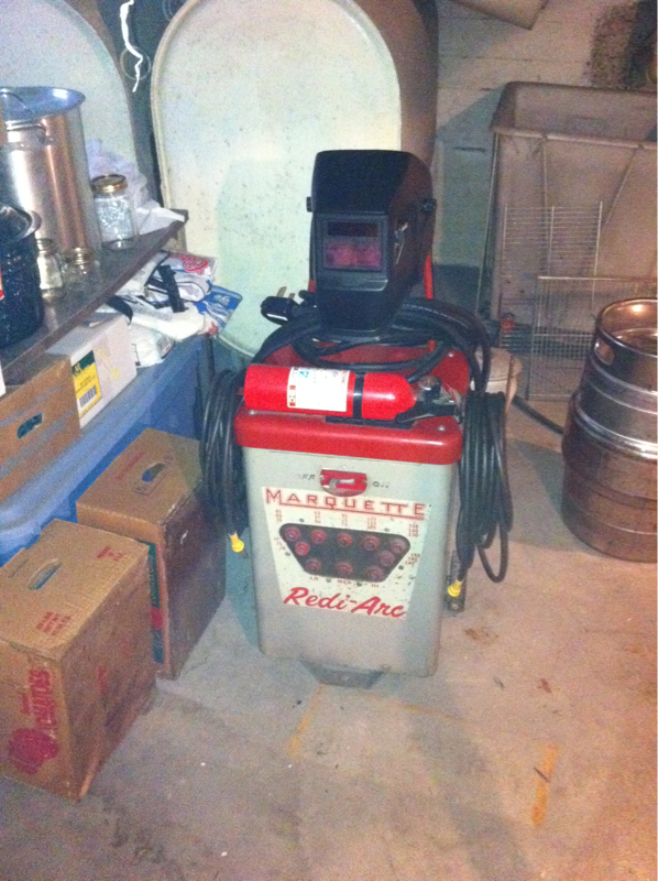

   / School me on the Tombstone #25
An old ac works fine and the price can't be beat.Dc just gives you more options,it's all in what you need.
   / School me on the Tombstone #26
I started off learning to stick weld on a machine almost like that one - maybe a wee bit newer. It was free - although I had to custom make the lead plugs to fit the sockets on the machine as the standard ones are too small - but that's another story.
I practiced and practiced and got quite decent with it, although it wouldn't run 7018AC worth a hoot. I then ran across a Dayton AC/DC machine (mfg. by Century) for $110 in mint condition on Craigslist. The only time I've plugged the leads into AC is to test it. ;) Otherwise it's been on DC for everything. DC is just a bit more stable and more forgiving with easier arc starts and better stability.
It boils down to how much you think you'll be welding and how much money you have (or have not). There are people who blow $2,000 or way more on welding gear because "they have to have the best", but they couldn't stick two pieces of steel together if they were covered in Crazy Glue. Conversely, give a real welder some old douche-bag dumpster-dive AC buzzbox and he'll lay down welds just as pretty as can be. It's not the machine that does the welding, it's the dude holding the stinger.
Any welder is better than NO welder. Get something you can afford and LEARN all you can. It's fun and satisfying to practice and see how your welds improve over time.
