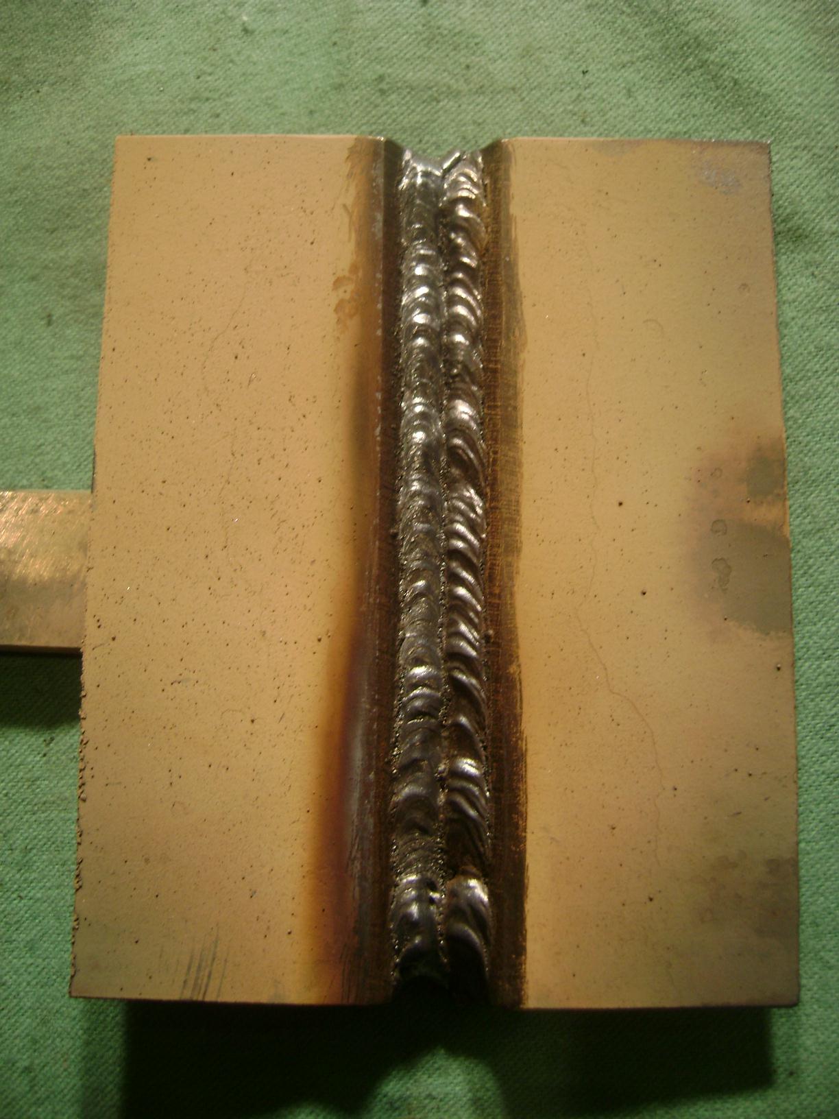

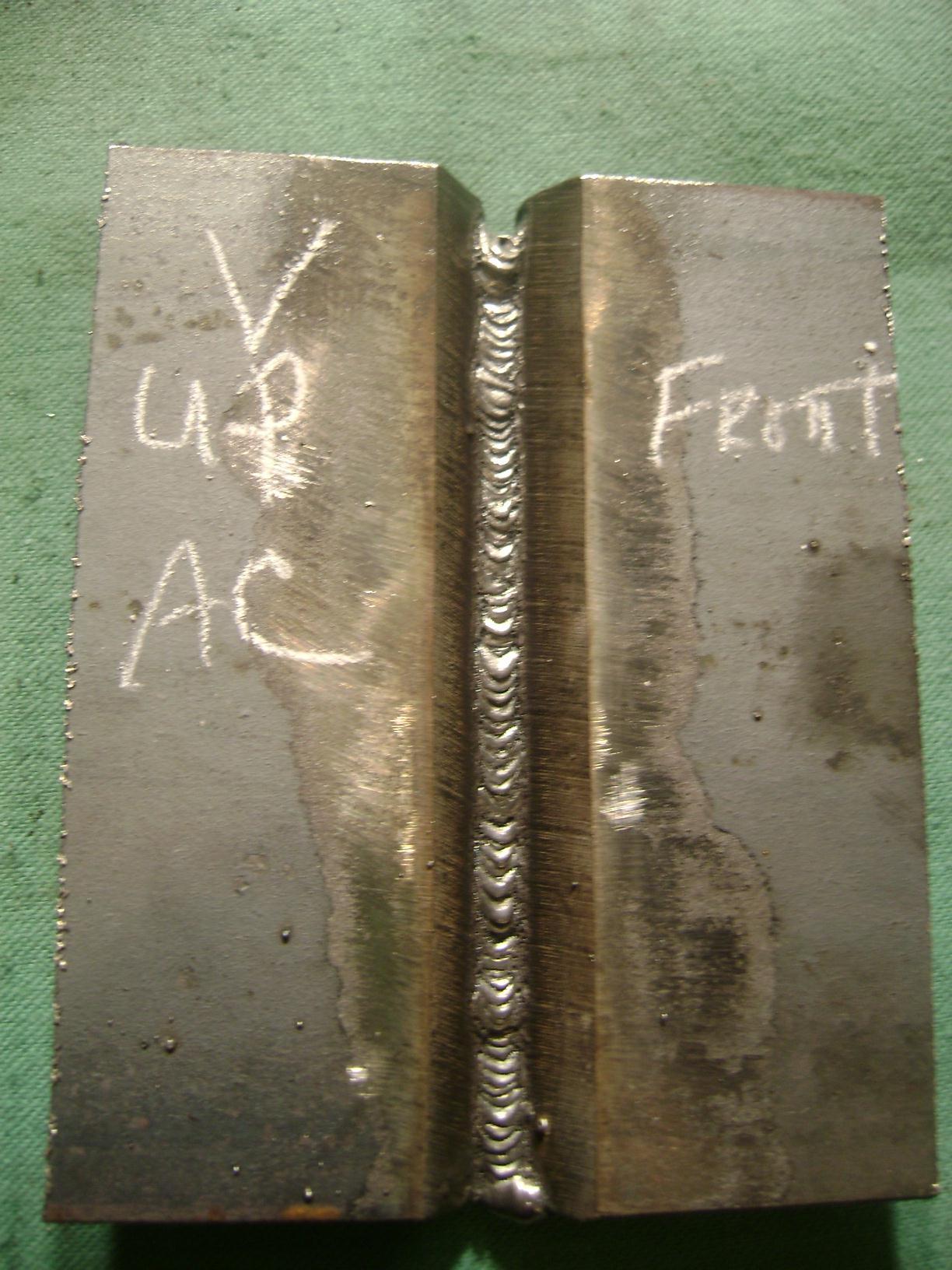

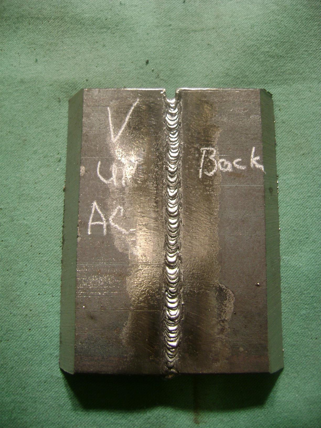

   / School me on the Tombstone #25
An old ac works fine and the price can't be beat.Dc just gives you more options,it's all in what you need.
