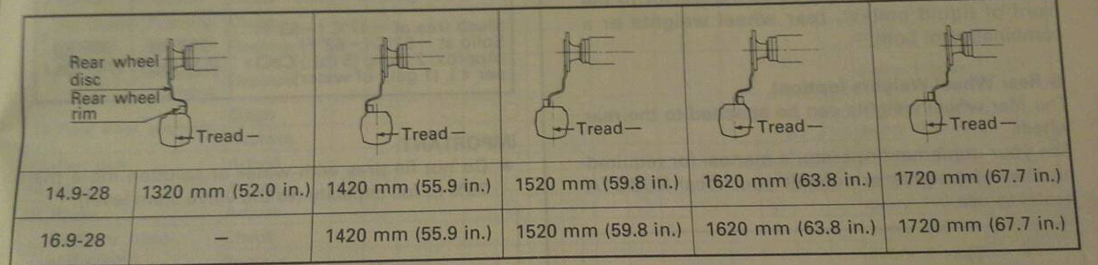

attachment.php
On my M4700 I've 5 settings to adjust distance between tire centers. From 52" to 67.7".
/ School me on tractor/tire width #11
5. Most "standard" tractors do not have adjustable rear tire widths.
Most tractors with R-1's, are adjustable via wheel center & rim position.
With 8 possible positions, quite a bit of adjustment is available.

/ School me on tractor/tire width #13
Yep, most ag tires are adjustable.
If you are thinking along the lines of spin-outs....no most basic tractors dont have that.
But dish in or dish out
Hub inside or outside the loops on the rims
And since the hoops are usually offset, which way is rim turned?
So 3 variables....2 possible positions with each variable....2 x 2 x 2 is 8 possibilities. (though some of the combinations may equal the same spacing overall) Probably why the manual for a M4700 pictured only shows 5 combinations

Its nothing new. Look closely at the pic of the section in the manual that someone posted.
You can see the hub is dished. So its a HUGE difference between dish in vs dish out. And the wheels are 2-piece. Meaning the hub and rim are separate pieces and bolt together.
The "loops" on the rims where the hub bolts is ~2" thick. So simply mounting the hum to the inside or outside will make a 2" difference each side.
And those loops are usually offset on the rim.....so turning the rim around usually gets 2 more possibilities.....
This "method" of adjusting track width has been around since the 1940's. And while in todays scale of farming, adjusting rims isnt something most farmers do anymore. But in the days of pulling plows, and row-cropping.....had to space the wheels to accommodate whatever width rows you were planting and for plow setup.
I looked at the M4700 bit that newbury posted again. With 5 possibilities it seems the 3 not show are the narrowest 3. Perhaps there is an issue with fender clearance.
But just in general....here are the 8 posibilities
http://www.oldfergusontractors.com/wp-content/Resources/Wheel Spacings.jpg
