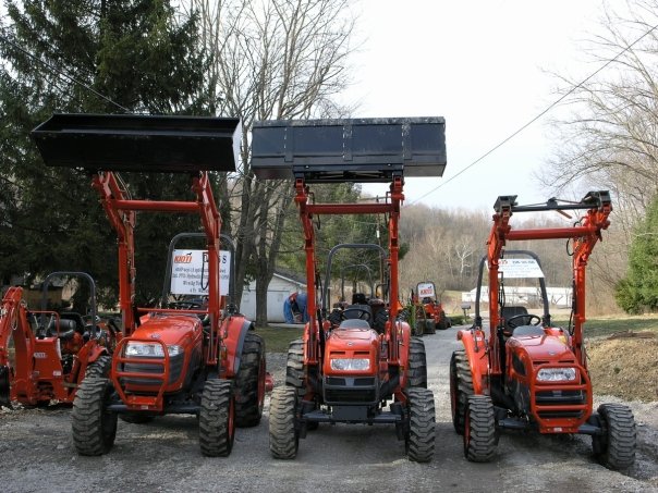

The DK45S is a larger frame tractor with larger tires all the way around.
That being said the operators station was a bit smaller than the SE
Pic shows DK45S on the left, then DK45SE then a DK35SE.
Sorry such a bad pic. Couldn't find a bigger one.
