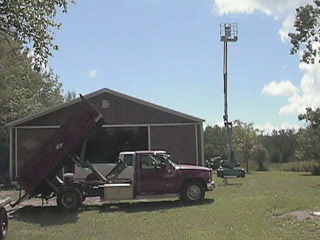

Great minds think alike.. I have the same config barn perimeter lined with pallet racking and wire mesh decking.
I bought a small gas Towmotor hard tired 12' forklift. 3K lbs lift & matches my tractor FEL capacity with pallet forks for outside toting.
Anything not on wheels is palletized and stacked. Even the snowmobile spends off season on a OSB pallet on the top of a rack.
Found a used rolling stairway (about $10/step) to access small stuff over head high - no stepladders. Bought it from a used retail store fixtures shop.
A scissor lift is verticle - consider getting a boom manlift - you are able to fly over a parked vehicle or other equipment in the barn to reach items on the walls. Also fly over bushes-porches etc. to get to 3nd floor dormers:D
I have a Genie Z30 battery powered self propelled rated 500 lbs and weighs 5 tons. paid $5K on Ebay. Considering the sheer mass, safety interlocks,(deadman, tilt, motion, etc) and failsafe engineering against collapse, plus backup hand powered hydraulics.
WAAAAYYY cheaper to buy vs build.

BarryinMN , I must say you are well equipped with hydraulic items. Love your lift... it even flys over your building... bet it's good for bird watching:D
