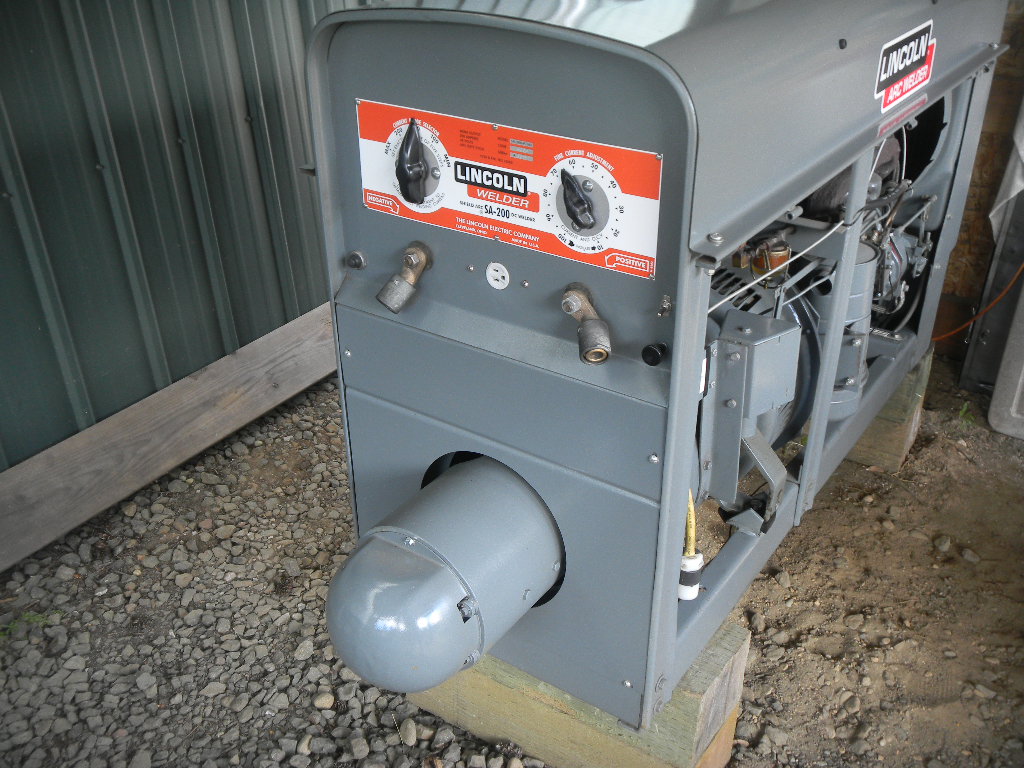

One of these days I am going to getroundtoit and finish up my sa200 build. I have already had all the engine machining done, sandblasted and primered the hood and frame. Now its just setting in pieces in the back of my shop. I need to fix it or sell it, but having a hard time making up my mind which I want to do.
   / Scored a few goodies today! #12
I had the engine rebuilt for my 1966 Red face beginning of the year. Took the generator into the repair shop in Seattle to have dielectric baked on the inside. Took 35-weeks for that little task:irked::muttering:. Got it all back together a month or so ago. Boy she welds so sweet!:thumbsup:

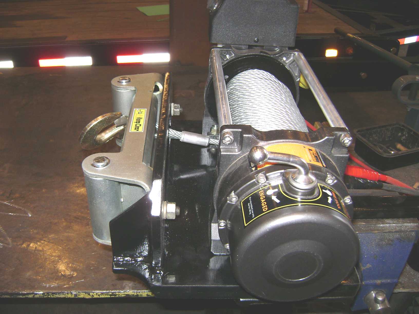

Btw, I'm going to try to find a receiver mount winch tomorrow to try and extract my truck. I have a warn 12000lb on the front but I've got to come backwards before I can use the front winch. Any recommendations on a winch setup for the rear? I should have never been in that bad spot to begin with but I have learned my lesson. If I ever get it out it's staying on the street from now on lol.

If you weren't half way across the country, I'd let you use mine;). I through it together a few years ago, but haven't used it yet.

Yea that's just the tool I need, I wish you were closer too! I may have to bite the bullet and buy another winch today. I've got the M12000 on the front but I may get the cheaper VR12000 and put it on a receiver mount. Then I can put receivers on the front and rear of my tractor too and not get my truck stuck getting it out next time lol. TSC has a 10,000 lb winch for 329$ that might work. I have 2 snatch blocks, but this heavy azz truck is sitting on the frame at the moment...

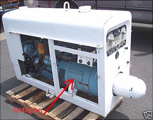

Are there any major differences between a short hood and a later SA200?
The only real difference is, the Short hoods have a 4-gear main amp selector. The Long hoods have a 5-gear main amp selector. In mid 1973 Lincoln started using aluminum in the generator, and to have enough room the generator was made into an octagon shape. I've had both models, and it's very obvious in the arc. Nothing beats 100% copper!:cool2:
