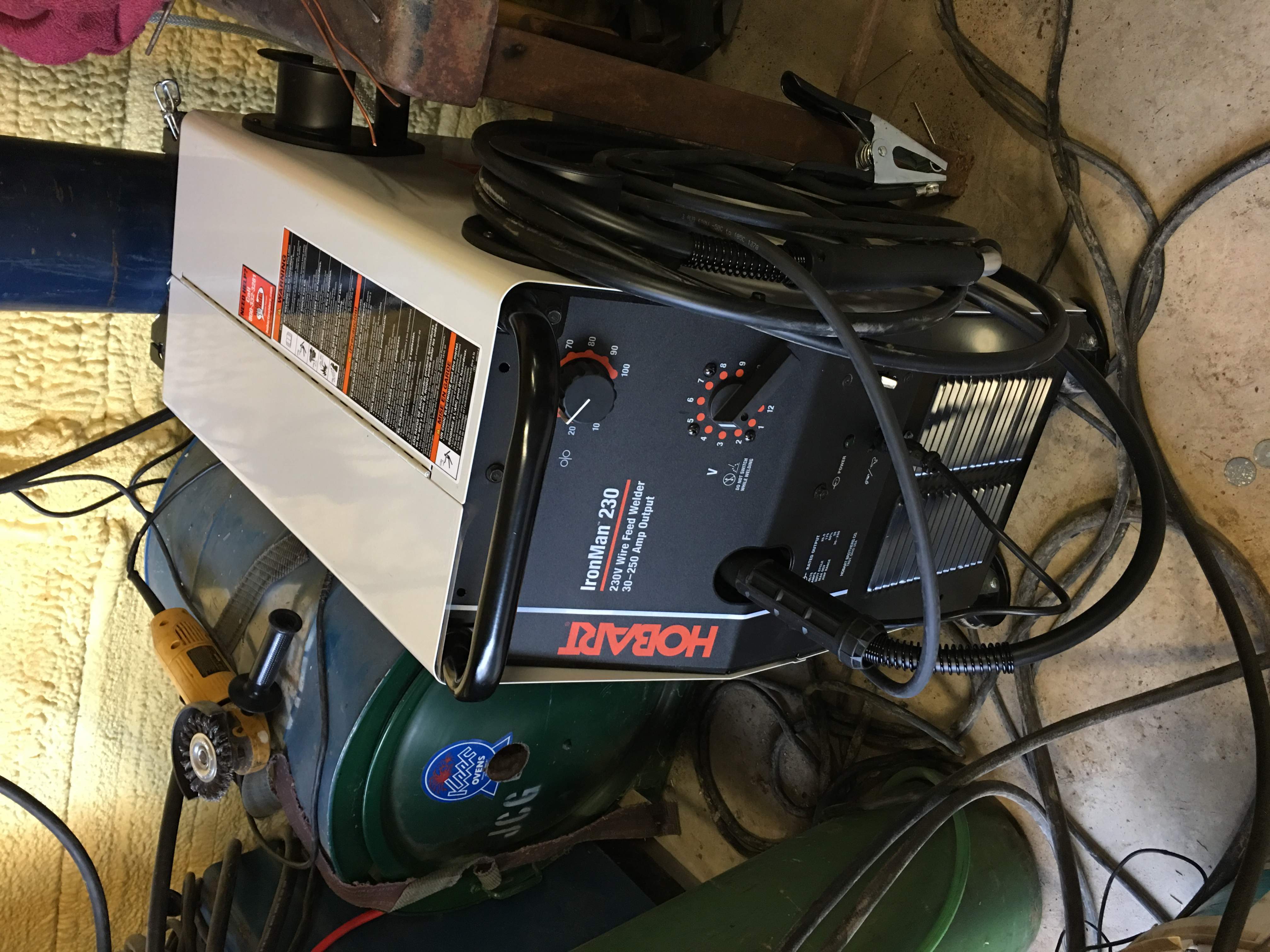

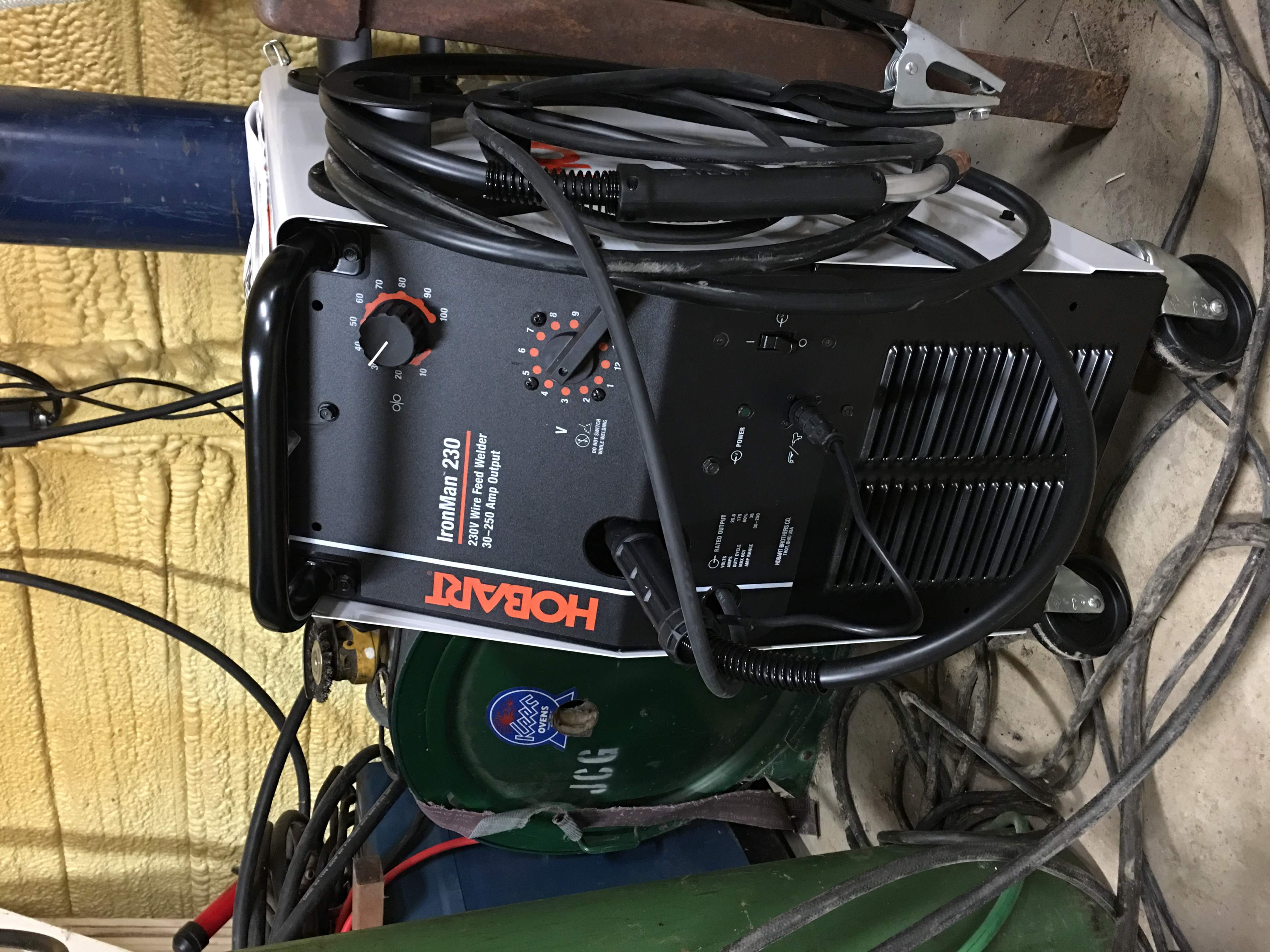

I added a new one to the fold. I've been thinking about getting a new inverter TIG welder but I've gotten use to my old Dialarc so for now I decided to hold off on the TIG. I'm still waiting on a reply for info on the Everlast units anyway. But for my main shop welding I got a little tired of fumes and smoke from stick welding so I decided to go with a decent sized MIG. I've been researching different models and had read only good things about the Hobart Ironman 230. I happened to stop by TSC and with the sale they had going I got it for less than 1400$ and 12 months zero interest. I couldn't pass it up at that price. Ideally it would have infinite voltage control but the 12 taps haven't hindered me at all yet. Besides the Miller version would be twice the money almost. It welds great, extremely smooth arc and no spatter. For most of my welding it will do fine. And for my outside stuff the Sa200 and ln25 will handle that. I really don't need the ln25, I may just sell it.image.jpgimage.jpg
   / Scored a few goodies today! #44
Good deal! I'm sure you'll be fine with the 12 tapped settings. My TA has the same.
Terry
   / Scored a few goodies today! #45
I wouldn't sell the LN-25. It's a perfect match with your SA-200. Some .045" or even 1/16" self shielded wire for big outside projects.;)

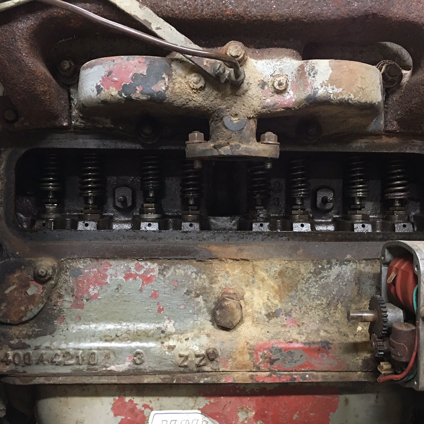

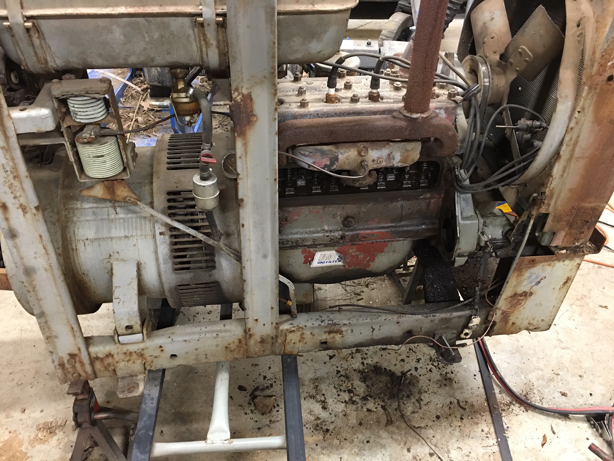

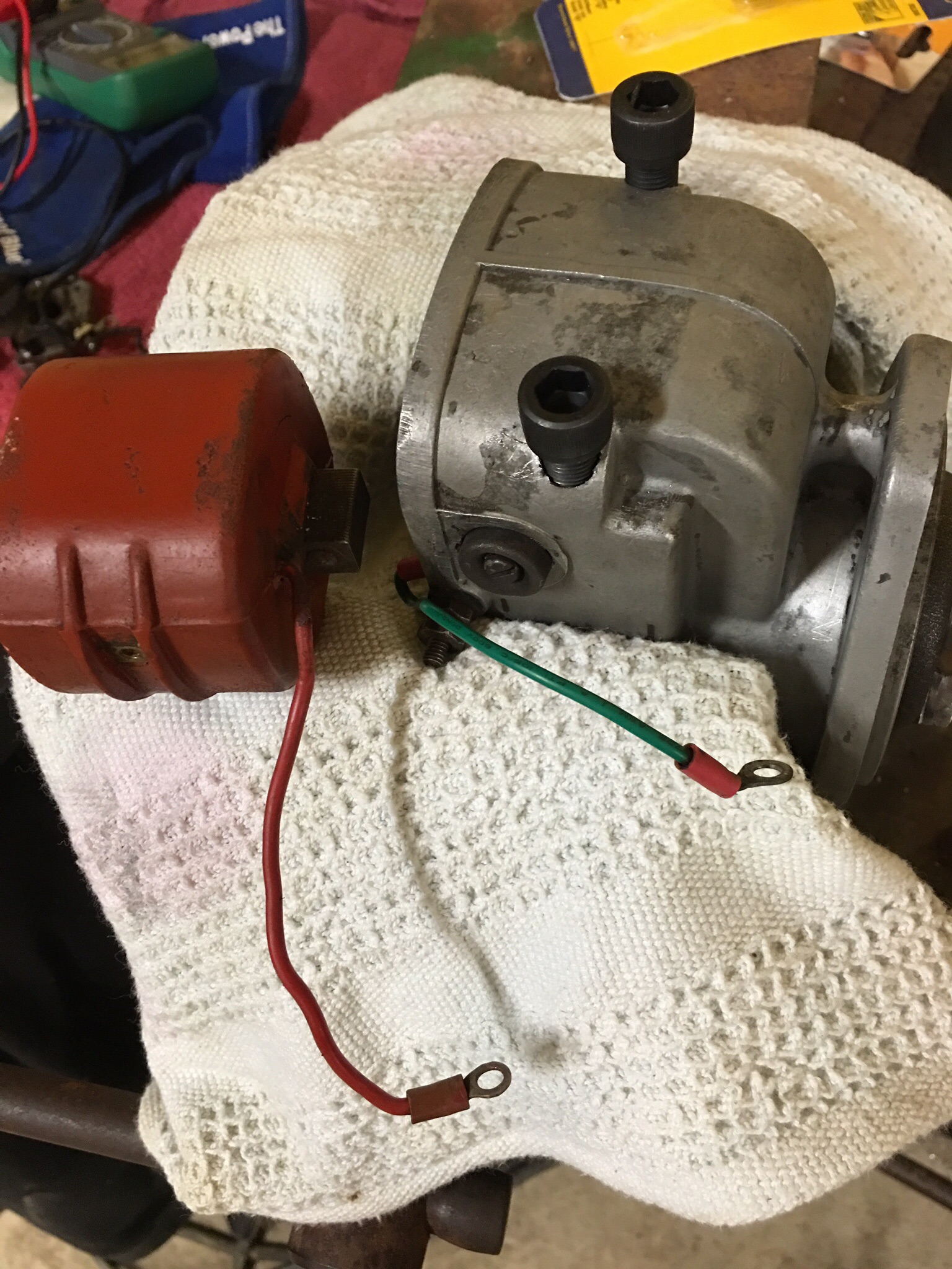

I've been tinkering with the shorthood in my spare time. The carb has been soaking in cleaner for a few days now and I just got a kit for it today. I also began looking into the no spark issue, turns out the magneto coil is shorted so I have a new one and a mag rebuild kit on the way as well. I had heck removing the coil mounting screws and I ended up having to drill them out and tap it to 3/8". I snapped a pic of the replacement Allen head lugs, and a pic of the welder as it sits now with the valve cover and panels off. The motor seems pretty clean and healthy and the compression checks out good. I'm hoping to have my parts in a few days and maybe have the ol girl running by a week or so. Then I can focus on the welder side and begin to clean everything up. I discovered that the code on the generator is a few years newer than the faceplate, 1954 or 55 I think. Not sure the story there, maybe it was replaced early on? But hopefully she'll weld and I won't have to replace coils or anything too expensive.:drink:
