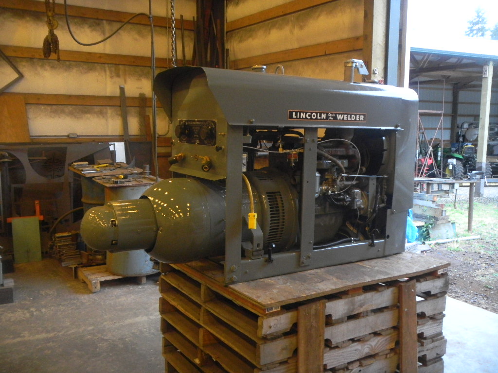

March of my senior year in high school I went to work in a welding fab shop full time. In June when I officially graduated from high school I went into construction. All you seen on construction sites was Lincoln Short hoods, and Red face welders. Years latter all you seen on the jobs were Miller engine drives. Until I went into management I never under stood why. Miller engine drives are cheaper, thats why!:rolleyes: After retiring I wanted an engine drive welder. I made the mistake of buying the 1974 SA-200 in the picture above. When I went to pick it up, I tried it out. It welded so I bought it. When I got it home, and the more I used it, it hit me! This isn't the same arc I remember! Then I learned Lincoln put aluminum in the generator!:mad: The aluminum SA-200s weld just like Millers Big 40 welders! All you can say for them is they weld, but that's about it.:thumbdown:
After buying several SA-200s, and parts for SA-200s. I took the engine out of that 1974, connected a 1970 generator to the engine, and placed them in the frame and sheet metal of a 1948 Short hood, and came up with this. I'm not so sure it doesn't weld better than my 1966 SA-200 Red face!
