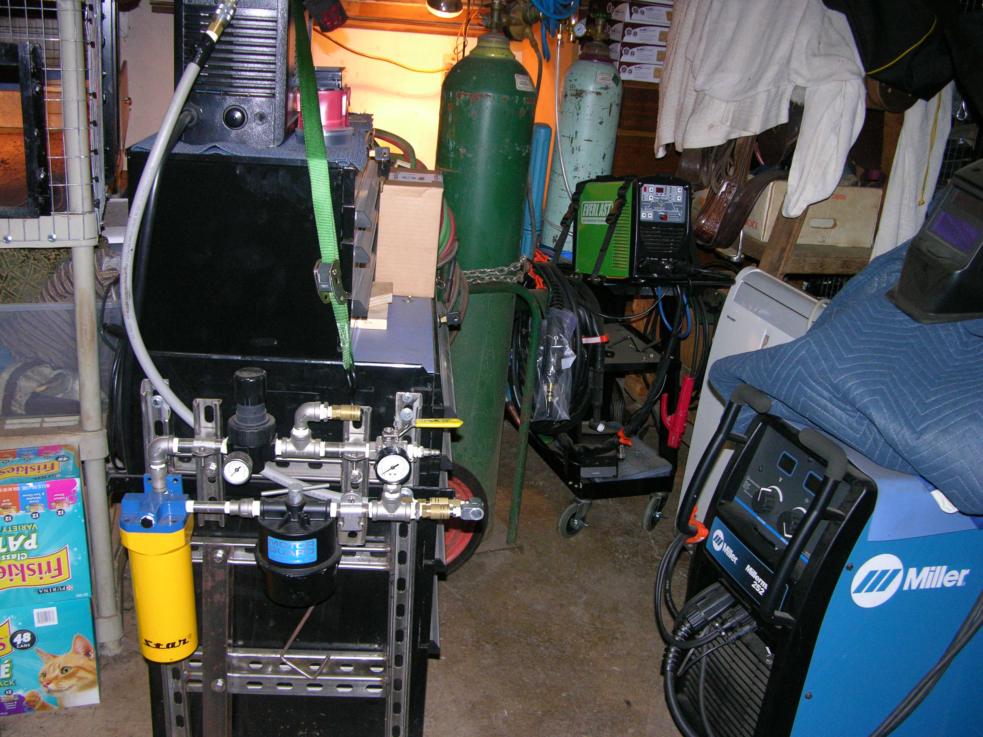

"Steve's (Buckitcase) Plasma Cart Plumbing Extravaganza"
Wow, what an honor - first of all I'd like to thank my former pipeline welder Bob, both for getting me started in arc welding and for the loan of his SA-200 til I got permanent power to the home I was building back in 1975. Next, I'd like to thank my (then) local auto parts guy LeRoy for alerting me to a sweet deal on an ac/dc 250 amp welder in another branch of his organization. Then, there was this guy...... :D:D:D
All seriousness aside, I still stand by my design - I don't think it's extravagant when every component serves a purpose (although they may not have needed to be stainless :laughing:)
In fact, there isn't even a refrigerated moisture separator involved (yet), but only for lack of room at the time :rolleyes:
I've re-posted the pic Terry alluded to for my not-yet-indoctrinated fans ;)
Gratefully, shiny (but denying any allegations of extravagance)... Steve

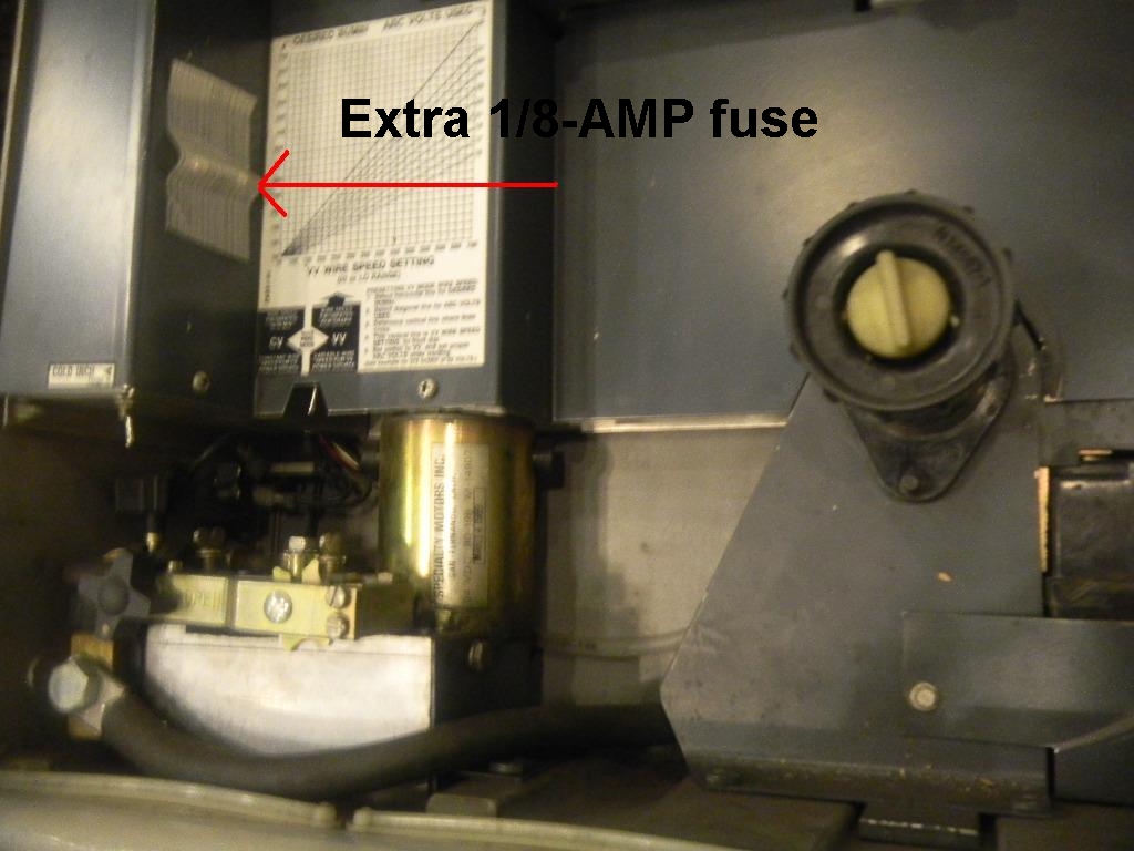

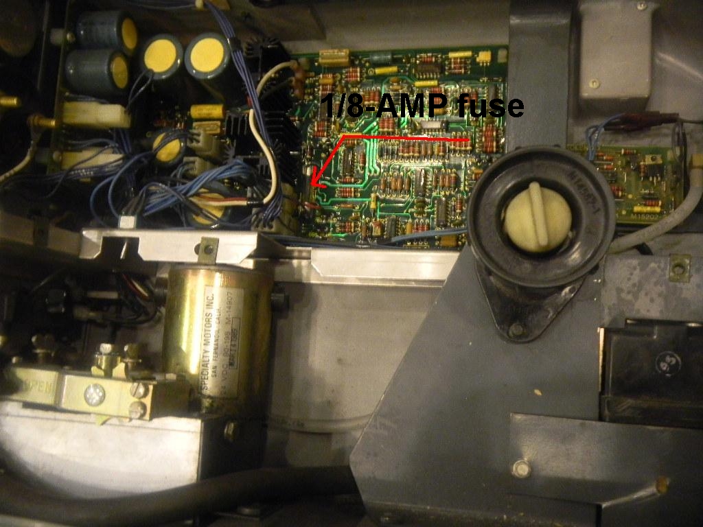

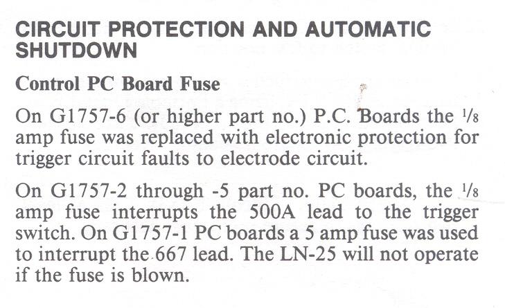

If your LN-25 is part number G1757-2 through G1757-5, there is an 1/8-AMP fuse under the cover inside the machine that can burn out. Good idea to get an extra one. ;)

   / Scored a few goodies today!
#35
Good call it is popped! I'll pick some up this week. What does this control? Hopefully the contactor, my wire is hot all the time. In function though it's not bad at all being hot, just like stick welding really. Thanks for the heads up SA!

And I scanned this right out of the LN-25s manual about the fuse.

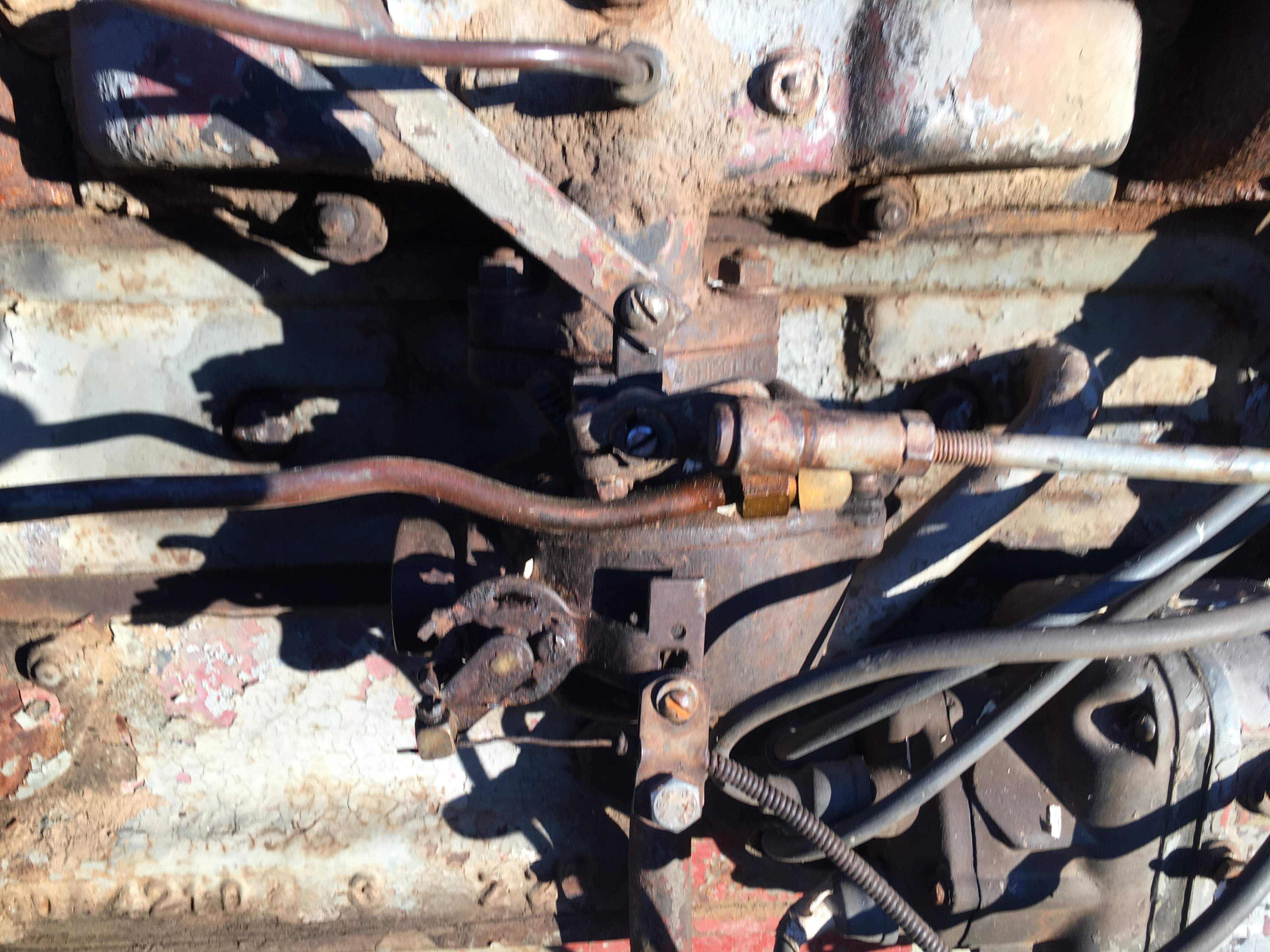

image.jpgI got the shorthood in the shop and snapped a couple more pics. Rats nest and dirt daubers under the cover. Besides weathering, doesn't seem to be too bad actual wear on the gen side. Probably less use on a farm vs a professional welder. The bearing was pretty dry but it took grease, quite a bit in fact. Guess I'll check compression then start with a carb kit and a look at what the mag needs. The oil looks good anyway, and the starter turns over. Looks like someone welded the exhaust pipe to the manifold..

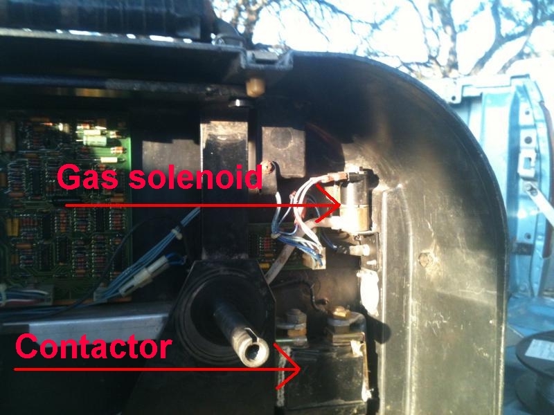

Ok thanks, I had seen that page in the pdf manual but couldn't find the number anywhere until I checked the board under cover. Mine is a 1757-3 so the fuse "interrupts the 500a lead to the trigger switch". Does that mean it interrupts the contactor function or what exactly? I'm still not sure I even have a contactor or what it looks like. I'll see if I can locate a replacement fuse today.
   / Scored a few goodies today! #39
I think all that fuse does is protect the circuit board. It shouldn't have anything to do with the contactor. You can remove the metal cover inside, if there is a little black box between the welding lead, then most likely you have a contactor. If the welding wire will arc, with out you pulling the trigger, you don't have a contactor.
