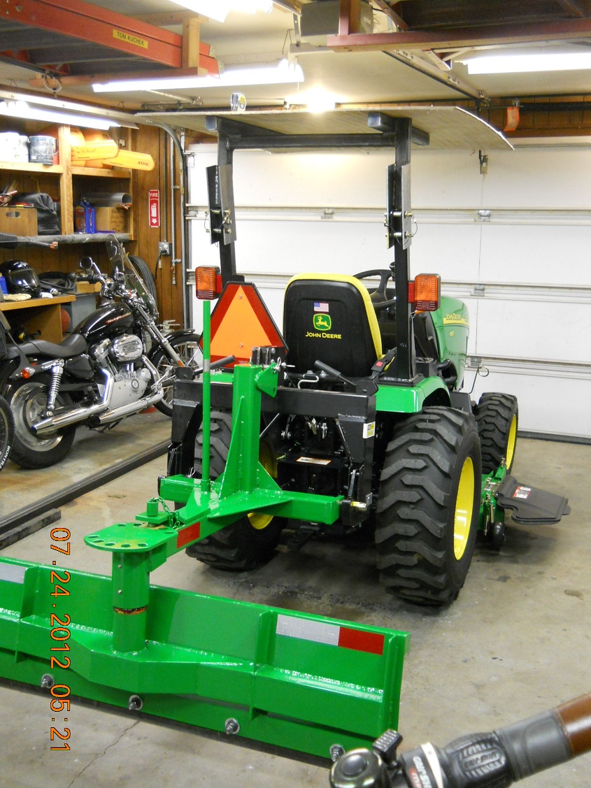

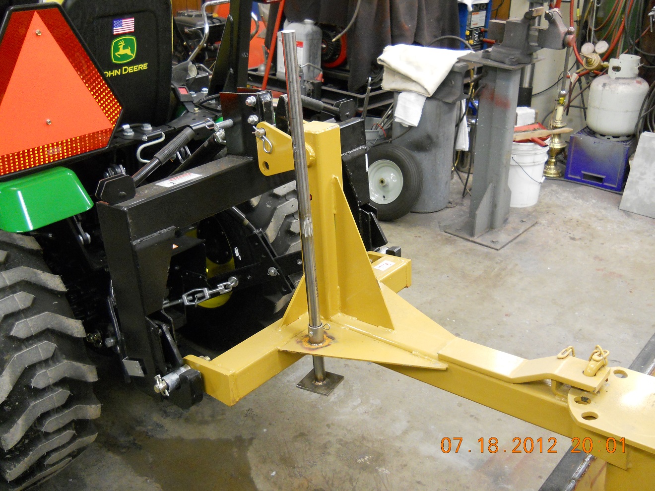

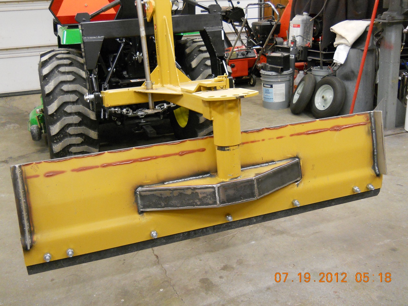

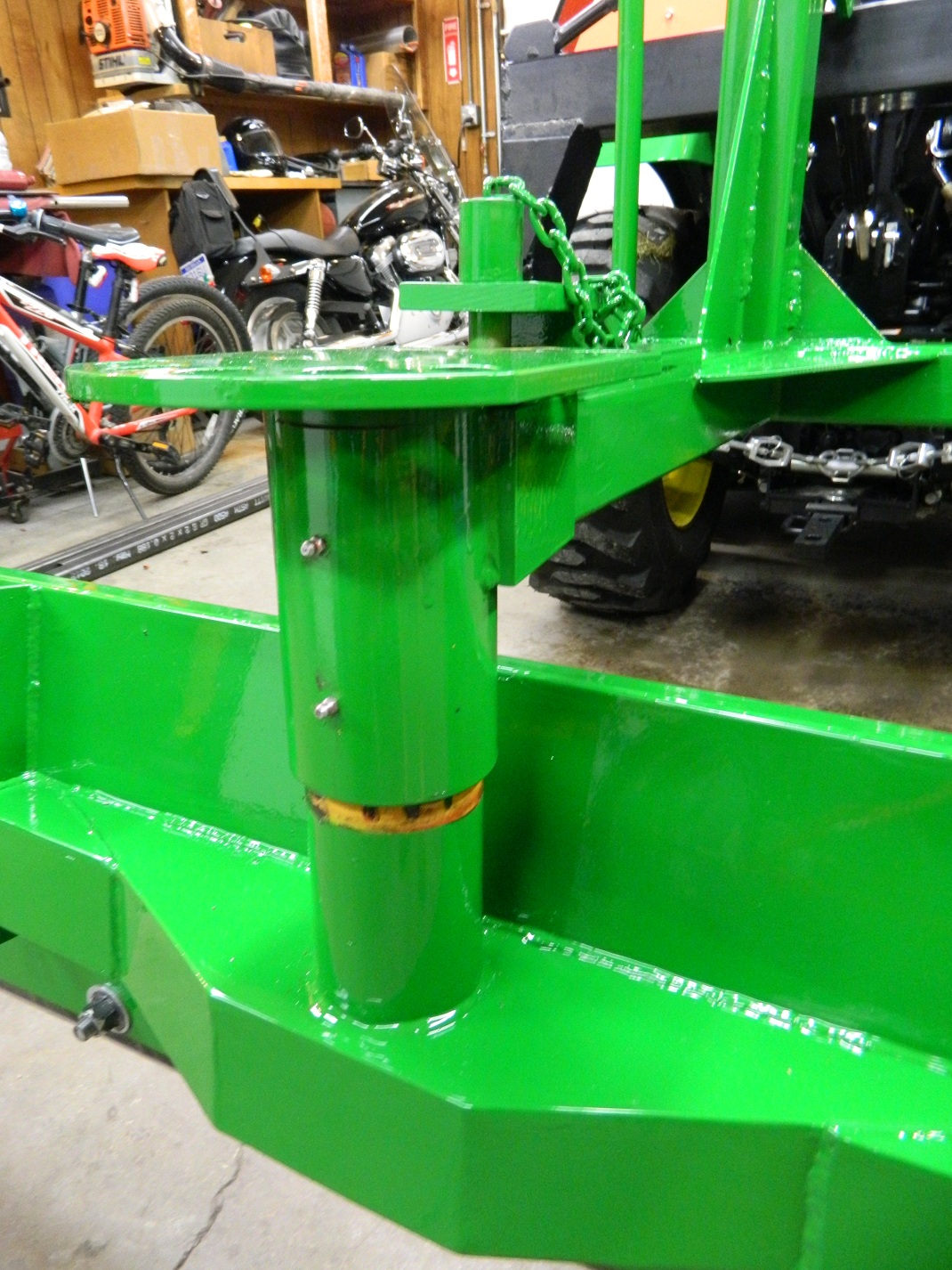

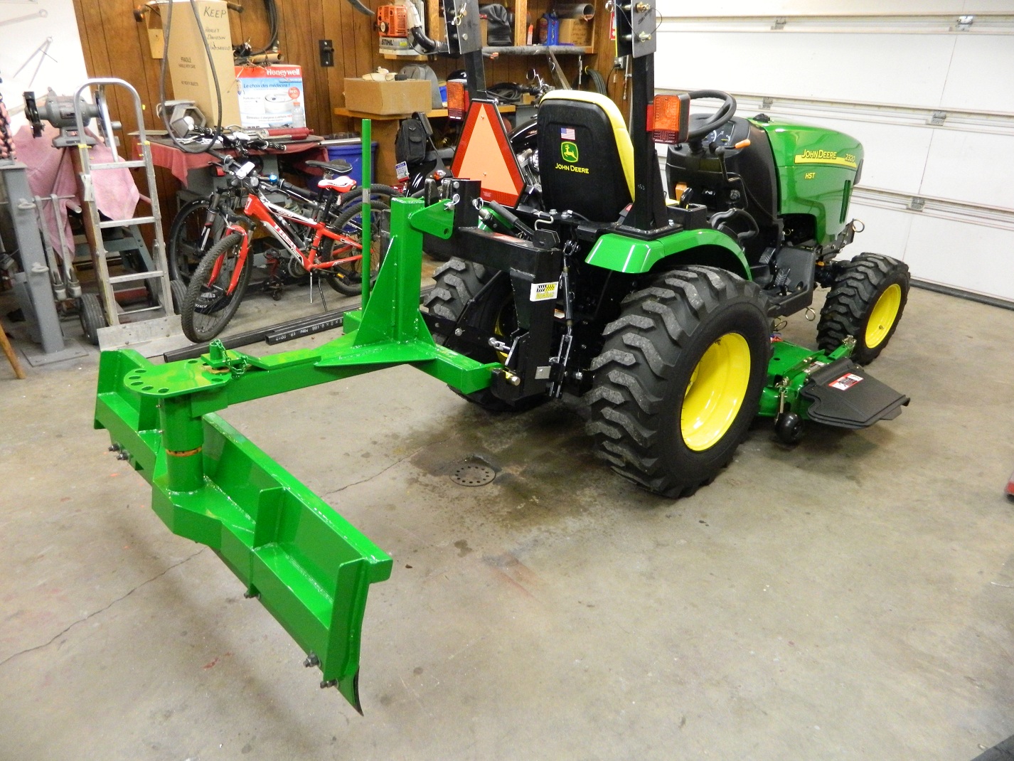

I bought my rear scaper blade first because of cost and i wanted it for snow removal this winter.
I wanted the option of being able to angle it.
My plans are to fabricate a cylinder set-up on it this winter after I add 2 sets of remotes next week.
While the blade was less expensive it is not very heavy. I have been using it to maintain about 600' of gravel road for a few neighbors trying to keep the potholes down.
It is not the ideal blade for thet type of work with a heavily packed suface. I have roads to improve this spring on my parents property and will most likely be getting a box blade for that work in the woods.
A scraper blade can be strenghtened but it has a limit to its usefullness.
new tractor 028.JPGnew tractor 029.JPGnew tractor 032.JPGnew tractor 048.JPGnew tractor 065.JPGnew tractor 066.JPGnew tractor 097.JPG
