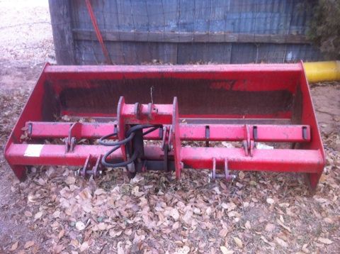

Well i think i found one that will work for me and its in budget at $900, its a used Cammond industrial 2C2 6' which according to their website weights 860 pounds. The only problem with it is that it has hydraulic actuated ripper teeth and i currently dont have any rear hydraulics. I am not even sure i can add them? Or how to add them if its possible.
   / Scraper blade or box blade? #35
That is a good find and would work good with your tractor. :thumbsup: Hydraulics aren't that big of a deal, just a little money is all.
   / Scraper blade or box blade? #36
You can always replace the hydraulic cylinder with a solid bar, one for teeth up and one for teeth down. Or if you has the tools needed you can make a replacement out of two pipes, one that slides inside of the other with holes for different positions of the teeth. Just save the cylinder so if you ever do get a rear remote you can reinstall it.
