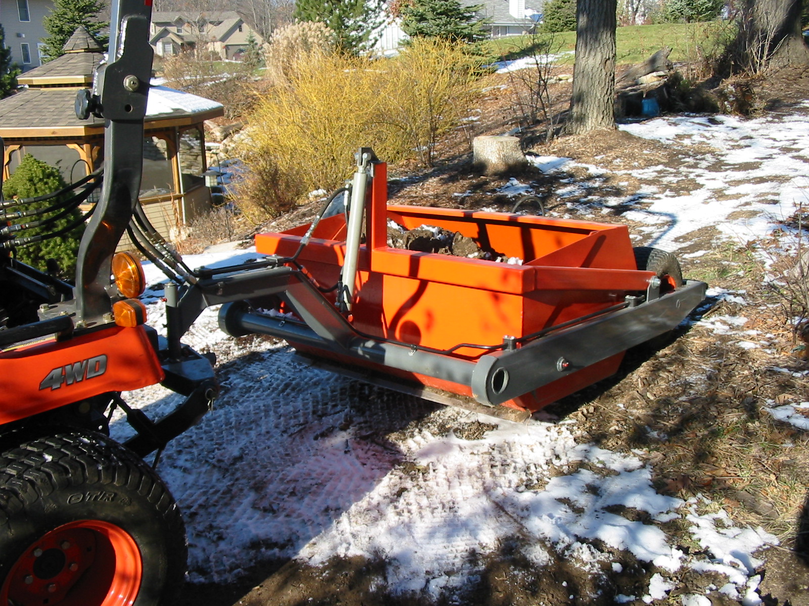

I used a parker 1/2 tube bender. I flared all the ends with a hydraulic crimper. 1/2 tube with wall thickness .049. No brazing, just 1/2 sleeve and 1/2 nuts all JIC fittings.

OK, I was basing my assumption of brazing on using ORFS (O-Ring Face Seal) fittings from Parker. Thanks for the info.

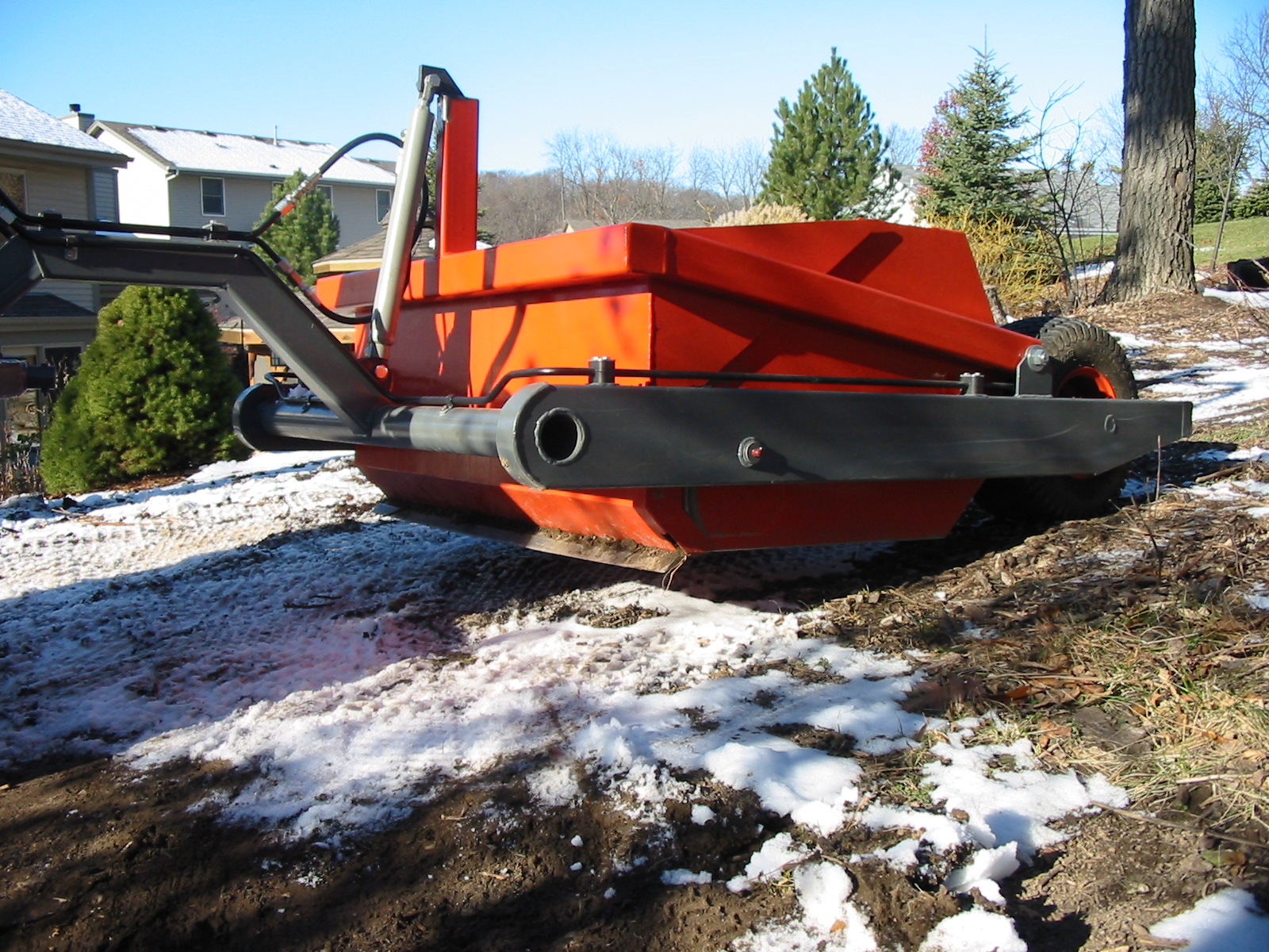

Here are some new pictures of the cylinder I had to change . Now the arpon open's 14" instead of 8'' works much better.

/ Scraper pan #35
That **** thing is beautiful!!
/ Scraper pan #36
A great deal of skill and time must have gone into this scraper, but the picture looks like your scraper is located in a fairly well established subdivision? And you're already starting your second scraper? What's the story?

I'll bet scraperpan's land borders a typical suburban neighborhood. If so, he can just sit back and smile that he isn't crammed into a 1/10 acre lot like sardines in a can, or cube rats in a cube farm.

So how does it dump?
Actually he has a single cylinder behind the bowl that picks up the back of the bowl and tips it forward to dump. You can see that on the first page and the first post about picture 3. it is very similar method as the company with the german sounding name that makes scrapers--Hoelscher or something like that.
