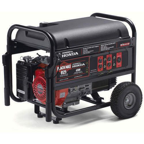

Sears used to have a good warranty, I don't know about these days. I bought ours at Samsclub it has a 13 HP Honda engine and has over 6,000 watts running and like 8,000 starting and its was something like $899. Ya may want to check with them if you can't get any satisfaction from sears
I check ours lots with a digital volt meter and we only use it for hurricanes, It sounds like they may replace the whole unit.
And most of these new generators are NOT putting out the correct voltage.. Its usualy higher like 130/ 135 volts
