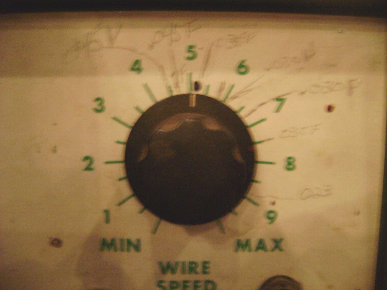

Yep. I had never tested mine. The wire speed is off by 15%.
   / Seeking advice on welding hook to FEL bucket #65
All you need is a pencil, or soap stone. Once you find your numbers, what works best for you, then mark the face plate.

I marked mine with different colored paint depending on thickness of metal I was working with. I used the chart inside the spool cover of my welder. Now I realize that guide doesn't suit my technique. I get much better results using the chart SA linked me to on Miller's website. So I made a new chart and fastened it to the side of the welder. :)

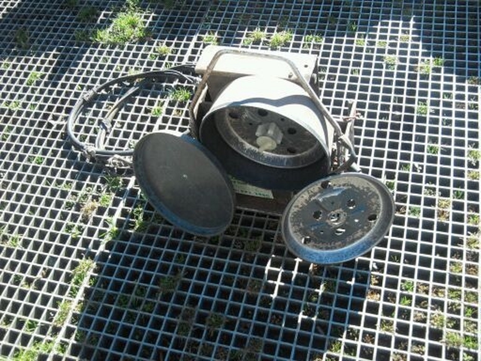

When I started, all you seen on construction sites were these welders. Then in the early 1980s Lincoln came out with the LN-22 wire feeders. By the Mid 1980s the LN-25s came out. That's when the structural welding world changed. I would go for years not seeing welding rod on the job. It was all wire.

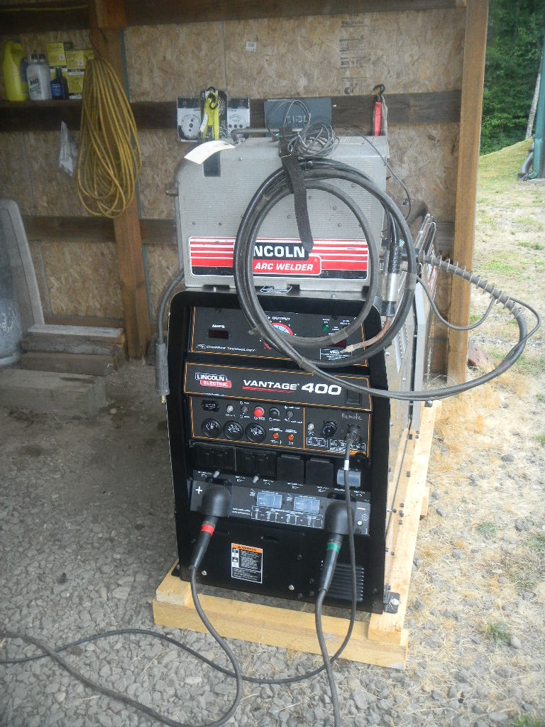

I have an AC/DC Lincoln tombstone welder for rod use. I keep it at my farm. I have to burn a little rod before the proper technique comes back to me after welding with wire. :)
Are the welders in your pics yours?? Very nice restored Welders!!!!!
In Iraq I watched an Iraqi use an old diesel powered generator for a welder. Also used a piece of cardboard with slits cut in it for a helmet. I am ashamed that I didn't get a picture. :)
   / Seeking advice on welding hook to FEL bucket #70
Yes, they are all mine. My wife says I have a tool problem!:confused::confused: I don't think so, what do you guys think?:D
