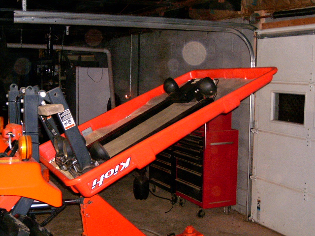

/ seeking opinions #7
My DK 35 fits in my polebarn fine. But I need to fold the ROPS and canopy when I want to put my tractor in the garage (7' high doors).
If I fold my ROPS 90 degrees the tip of my canopy is around 6' high.

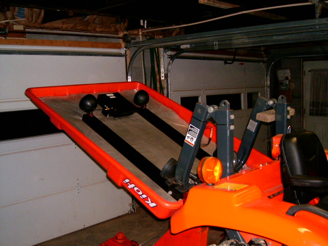

/ seeking opinions #8
In this picture you can see the 2x4 I wedge between the folded ROPS bars to keep the canopy from hitting/rubbing my fenders when folded.
/ seeking opinions
#9
Thanks alot for the pics, and very nice angles to view the rops. The only problem I see is that my 45 ROPS don't fold in half, they pivot at the base. My last tractor they folded in half, but not these. At the base there are two plates, with pin holes at the 90, 45, and flat.
