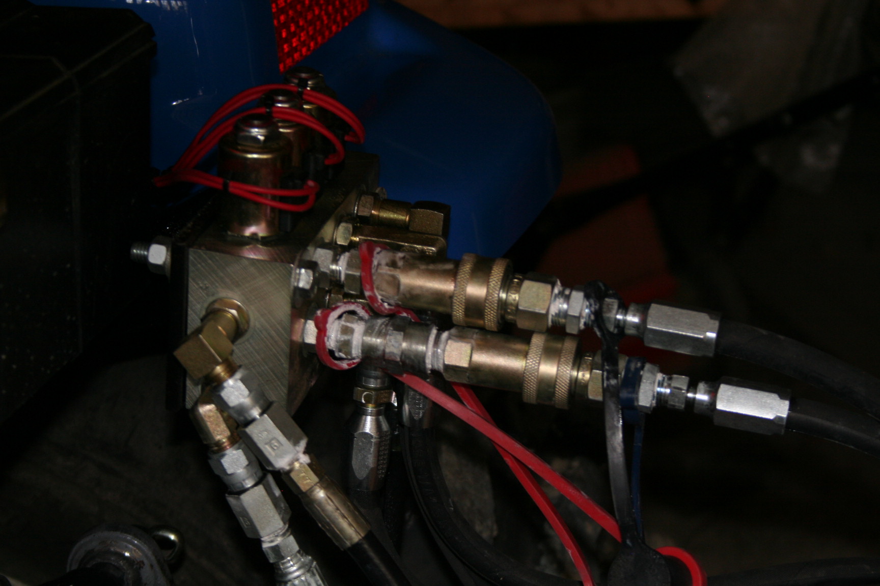

I got my tripple selector valve today. When I was looking it over I noticed that the oil ports in the valve are only 1/4" dia. My plan is to plumb this valve in to the curl and dump function of the control valve for the FEL. to operate a grapple and run lines to the back for a hyd. top link. This valve is rated at 12 GPM. I think my tractor puts out around 7GPM. I guess my question is, at what pressure it GPM calculated. I am wondering if this is going to slow down the bucket functions. One more thing if anyone else is looking at this valve. You can not put 6m to 3/8npt 90deg swivels in all the ports. The ports are to close together. I am going to try getting the fittings without the swivel and see if they clear.

Kenny You have so much Hyd knowledge it's ok if you miss something once in a while.
Hooked I used a combination of el long els and longer els and straights.
If I was doing it again I might come straight out with the a,B and c ports.
I had posted a picture of part of it previously. post 58 Tomorrow I will post the whole thing.

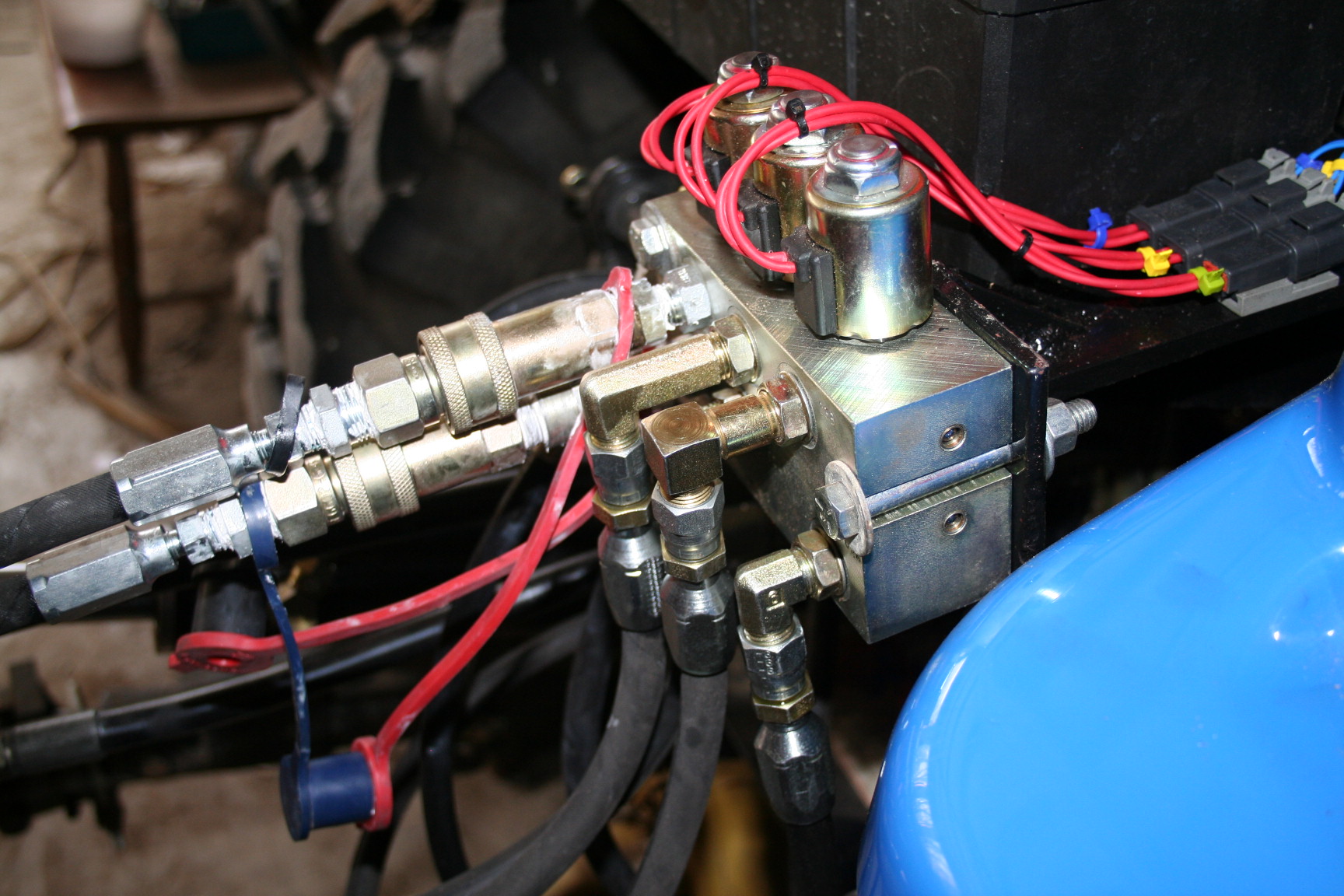

Here are pictures of the fittings, I had to stagger the QD out they were too close to work. Probably too big a loop on the tilt cylinder hoses , I can always shorten them, I have some trouble with the chute tilt hoses as they have to travel 270d. Thats why I put the sleeve on them. I will see how it works,

Bob, where did you get the longer L. I didn't find them on SC's site.
