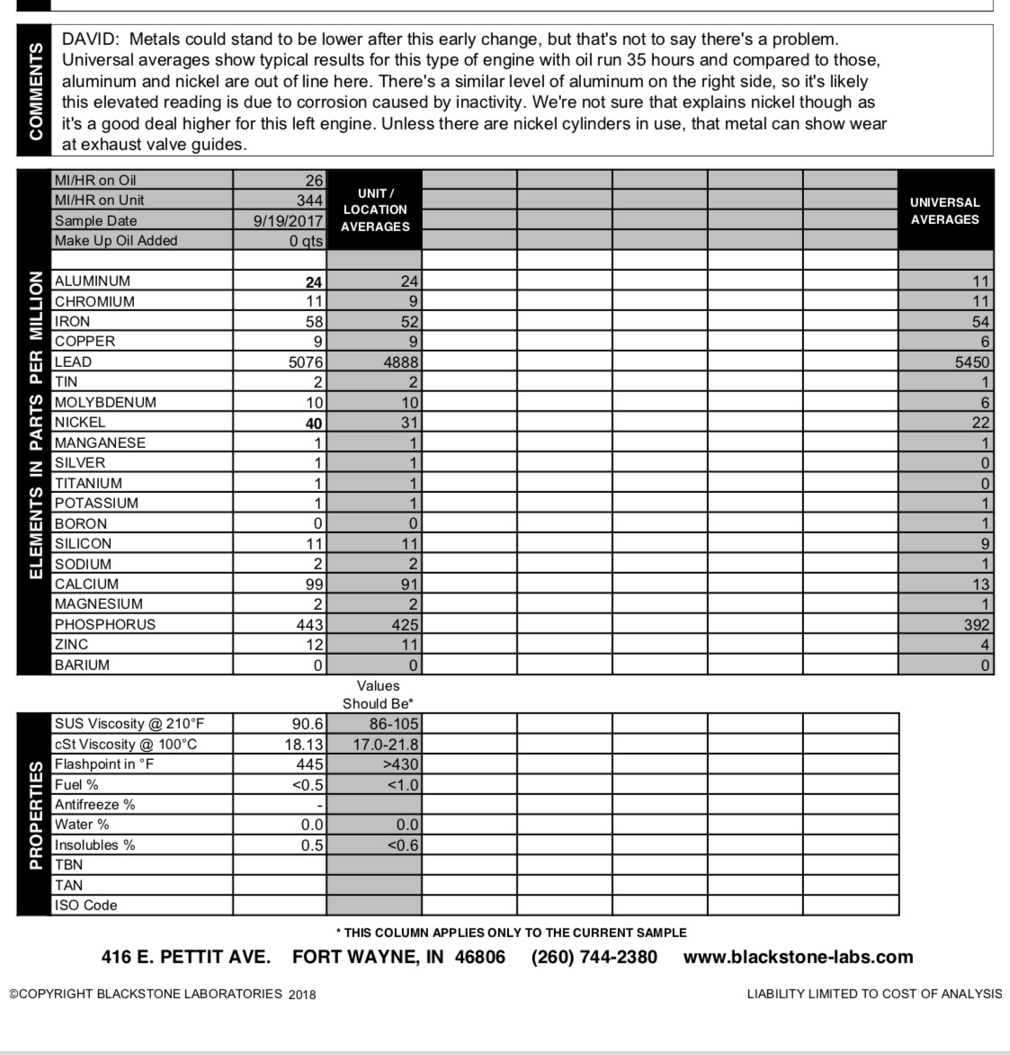

I can speak from an aviation perspective. I use blackstone labs on both piston and turbine engines. They can flag levels that are above the “norm” for a type of engine or numbers of hours of use but to truly establish good data you should be sending in a sample each oil Change. We do this with aircraft engines and it establishes a baseline for your specific engine. The general averages for a type of engine are great and will let you know if something is really about to go but to have truly great data you need a trend established form your own engine. Well worth the $30 for the sample on aircraft engines that range from anywhere from $50,000 - $300,000 to overhaul on tractors this is a little less common but as blackstone can tell you they do get a lot of samples from trucks, tractors, etc. I will pull up a report and post it so you can see what you get.

Here’s a sample report with the top section with personal info cropped. This was on the first sample for one of two engines on a piston aircraft that had never been sampled before.
