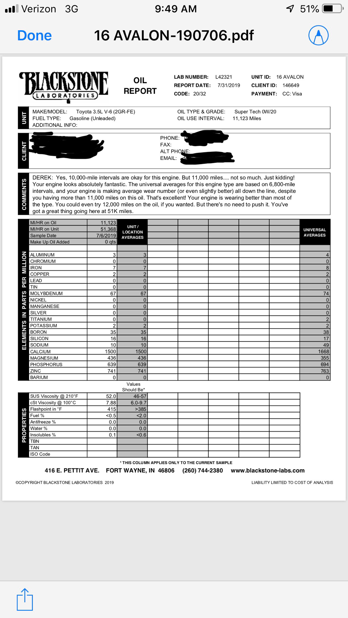

My neighbor and I got into a heated discussion about Toyota recommended 10,000 mile oil changes. I believed that if Toyota recommended this in their owners manual then it must be fine. He believed that it was crazy to go 10,000 miles between oil changes.
Blackstone settled it, it and confirmed that the oil sample I took with 11,100 miles on it was still in very good condition and I could even go longer if I wanted to. Clears up some of the mis-information out there. IMG_2585.JPG
Blackstone settled it, it and confirmed that the oil sample I took with 11,100 miles on it was still in very good condition and I could even go longer if I wanted to. Clears up some of the mis-information out there. View attachment 619573
Years ago I bought a VW and the manual said change every 3K miles, while the european manual said change every 10K miles.
Same vehicle, same engine, etc. etc.
No funny business there people!. Buy more oil and waste your mony in the USA.
For the last 50 years I change my oil when I feel like it, not by time, miles, age, anything and I've never ever had an oil related engine problem, and that's with a couple of dozen vehilces and a half dozen commercial trucks in my business.
Longerst engine oil/hydraulic fluid change on a tractor was 15 years NOT A TYPO 80's Kubota M4500.
Longets oil change on a vehicle a 1998 For Exporer - 60, 000 miles. Same filter some added oil as needed.
The Explorer was a dealer buyback and I swore I wouldn't put a dime in service in that vehicle as they were going to give me a replacement any way.
As a kid my first car was a 1969 Camaro RS 350. 60K miles on her before I sold it and I bet I only changed the oild three times that I can remember.

You must be one of those people that when you pull the drain plug, chunks come out.....:mur:
