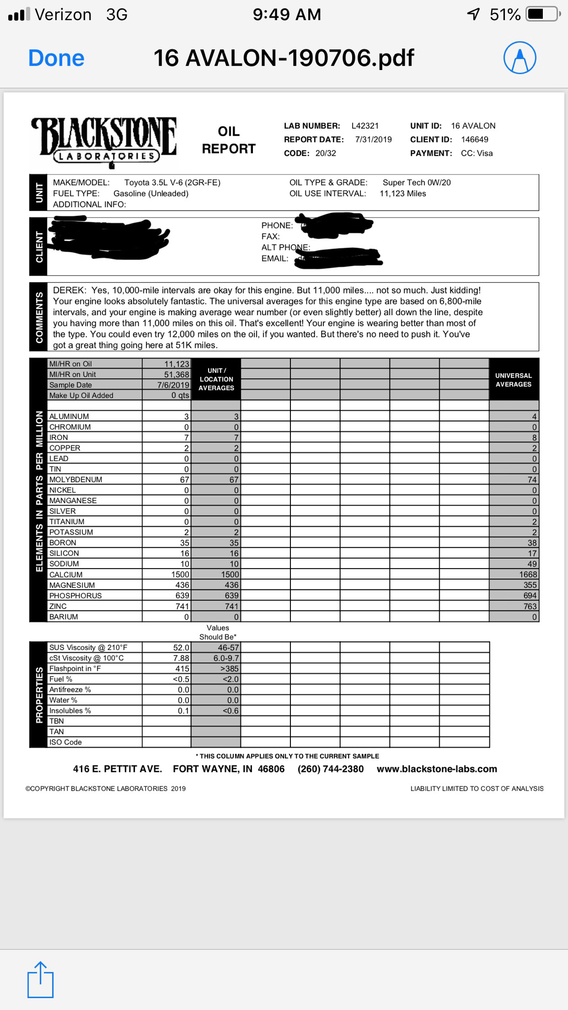

My neighbor and I got into a heated discussion about Toyota recommended 10,000 mile oil changes. I believed that if Toyota recommended this in their owners manual then it must be fine. He believed that it was crazy to go 10,000 miles between oil changes.
Blackstone settled it, it and confirmed that the oil sample I took with 11,100 miles on it was still in very good condition and I could even go longer if I wanted to. Clears up some of the mis-information out there. IMG_2585.JPG
