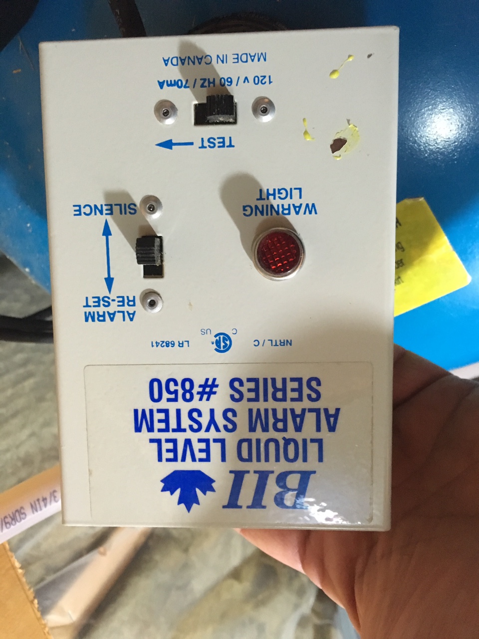

OK, went up and did a few tests this weekend. The two switches (one for "Test" and one for "Silence" both showed the correct impedence when using the switches. And now the warning buzzer seems to work intermittently when all switches are off/open. (Actually, it kind of hums like it wants to come on but can't.)
And Boshart was not open this weekend, so I will have to call tomorrow. Seems like a lot of money for a box with 2 switches, a lite, and a buzzer! ($173)

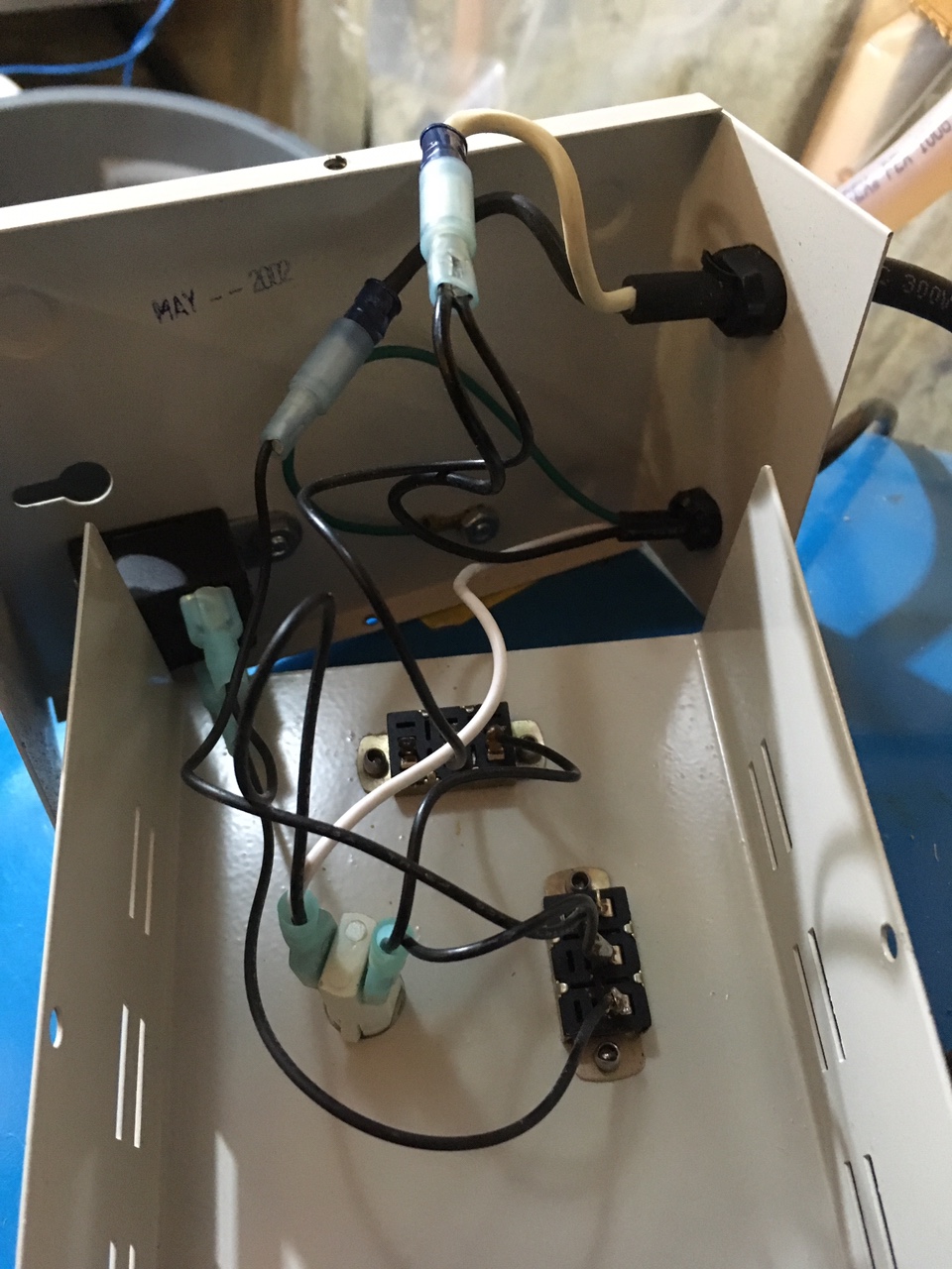

Yup. Most likely one of the switches. One has a post that wiggles a bit, so that is the suspect.
No schematic necessary, however. It’s just two switches, a light, and a buzzer. It might not be that obvious in the photo, but I can tell where every wire goes, no problem. Here it is again.
View attachment 597419View attachment 597420

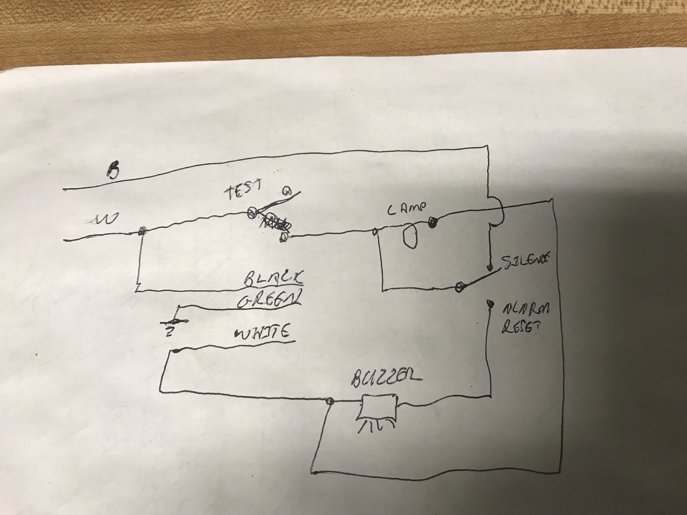

I saw your pictures the other day and sketched out a schematic yesterday afternoon. Either I've drawn it wrong, or it makes no sense to me, or the center pole on the back of the switches are not the center poles electrically. When it's in the silent position, there's no complete circuit to the buzzer. When it's in the alarm/reset position, both sides of the buzzer are shorted together through the lamp, and there's no complete circuit anyway, unless the test button is activated.
Hopefully, I've just drawn it incorrectly. ;)
Moss, you have drawn it correctly. The two wires going out to the left are going to the float switch, and so as long as the “silence” switch is set to “alarm” (which it is not in your diagram), the system is armed and ready to go in as soon as the float switch is activated.
The problem, of course, is that one of those internal switches in your diagram does not seem to be working properly. I did check both switches for continuity, and they are as expected. Resistance is infinite when they’re open, and less than one Ohm when they’re closed.
When I had another look at it this weekend, the buzzer would hum like it wanted to go off, but did not always work its way into a full buzzer mode. However, if I activated the test switch, the buzzer would come right on full.
I think I may be dealing with some sort of intermittent electrical short, so I’m going to find a couple more switches and see if they will do the trick.
