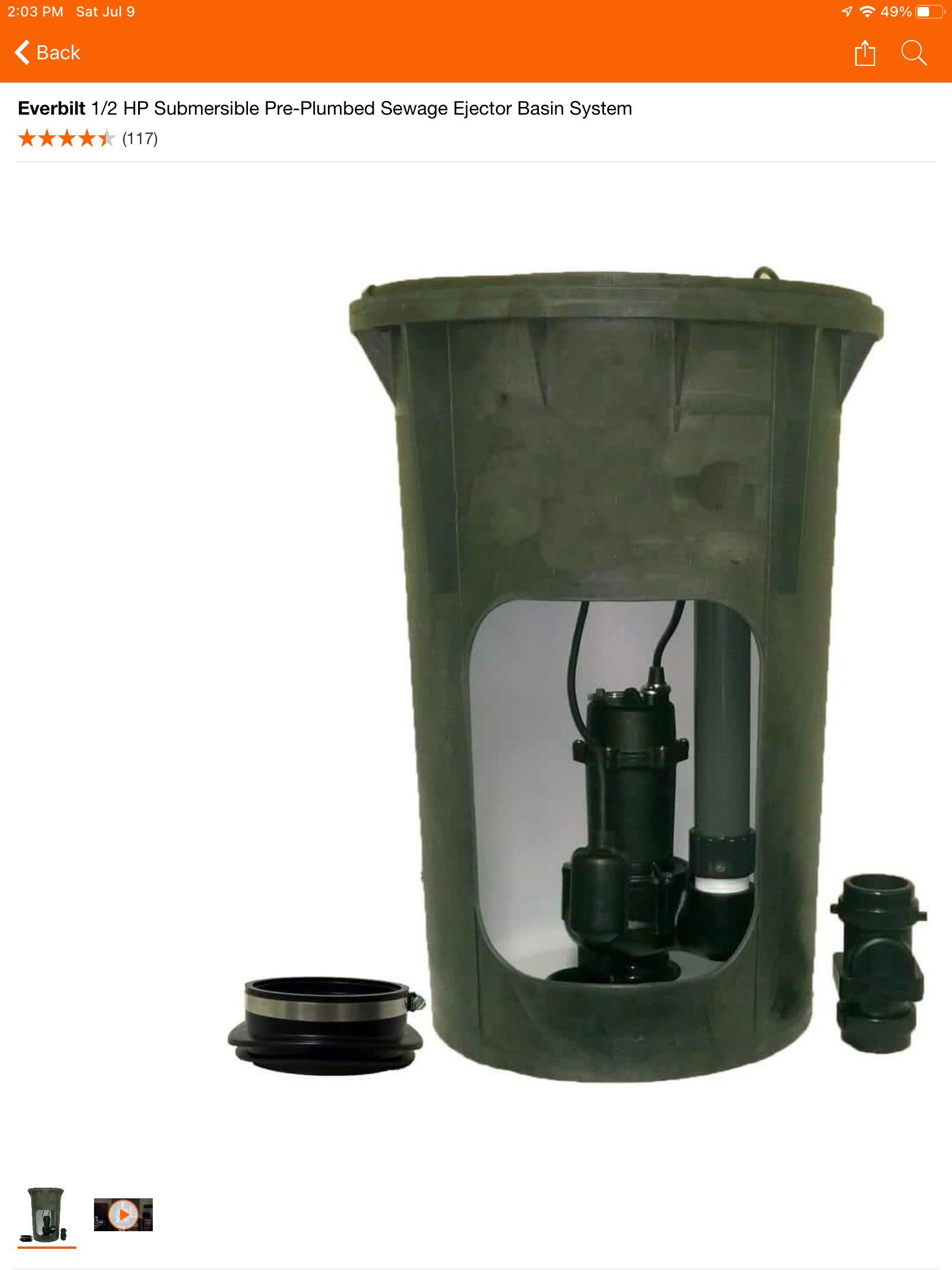

I put one of these in next to my shop when I built 17 years ago. It pushes through a 2” line to the septic tank about 125’ away. I originally installed a salvaged pump which lasted about 10 years and replaced it with a new. I bought the basin only since I had a pump. Since the pump is right next to the shop electric was minimal.
Cost is $600 at HD.

i have helped a contractor install leach fields far, far away from septic tank, but every one of those systems included a electric pump to move effluent. Usually thru 2” pipe to a distribution tank next to the field. They HAVE to be engineered or you can have a system that doesn't work. I know, as this guys main job is repairing other peoples screw ups.

Ed, I think I'd only be concerned with whether it was a distance that would permit me to keep a very slight downhill run to the septic system. Maybe someone else can refresh my memory; was it one inch or a quarter inch per 10' of lateral line? And there's another possibility also that you might consider, or talk to septic installers in your area. One of my brothers built a home on 10 acres and had one of the aerobic sewer systems installed at the time. Later, they fixed an RV parking site for the other brother to live on. The RV was about 75' from the septic tank, so the guy who installed the original system installed a 50 gallon underground tank with a macerator pump and a 2" line to the original septic system. Of course you'd have to wire the electric power for the pump, but it worked well for them.
