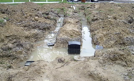

Here's a picture I took on May 12 right after the septic system failed the inspection. We moved in on April 24. It was quite a shock to us to find out a couple of weeks later that the inspector failed the system!
I bought the digital camera when we started building. I encourage anyone having a house built to take pictures every step of the way-- just in case! /forums/images/graemlins/crazy.gif

We used to put in engineered fields around here, but the red tape in dealing with the county plus the state just got to be too much.
From looking at Andy's front yard, I am really surprised that an engineered field wasn't part of the original building permit. I can't see how that particular piece of land would perk.
The bad thing about an engineered field is they actually have a life expectancy and that life can be appreciably lowered by the use of high phosphate detergent as well as household chemicals and kitchen grease and the introduction of as I call heavy toilet paper.
The toilet paper as well as the detergent and grease scenario also applies to conventional buried tanks and leach field systems.

Me thinks the drainage and soil type for a much larger area have to be looked at in this case.
And yes, I do not see how a conventional system would be allowed for installation.
Hakim gave some real good advice as this is one that will require detailed knowledge of the area and systems.
It could almost be alledged that a popular builder may have a little help in getting approvals.

When I looked at Andy's picture of the water logged yard. I thought to myself 'no one in the trades with an ounce of knowledge would put an in-ground system in that area'.
I see the inspector scenario played out around here on numerous occasions. There is a large amount of the good 'ole boy inspector/contractor crap around here as well as about any rural setting. That's one reason we got away from installing engineered fields. In more than one incident, the inspector had about as much knowledge of the item he was inspecting ie: electrical, plumbing or structure, as a toothpick. It all boils down to who is friends with whom, what lodge they belong too or family ties. The problem with incompetence is that the homeowner, in the end, bears the brunt of their inability to perform the inspection or for that matter the actual work, properly.
I know those are harsh words and I probably rilled more than one TBYNetter, but that's how in works in rural America.
To Andy, I'd get the opinion of a Sanitation Engineer, board certified and get it in writing. Secondly, I'd get a good mouth piece, one of those $250.00 per hour ones and let him lay down the law or should I say lay down the suit against the township, their inspectors as well as the general contractor for punitive as well as compensatory damages. At that point, after you have built the fire, I bet the township and the contractor will be pretty happy to resolve your problem.
