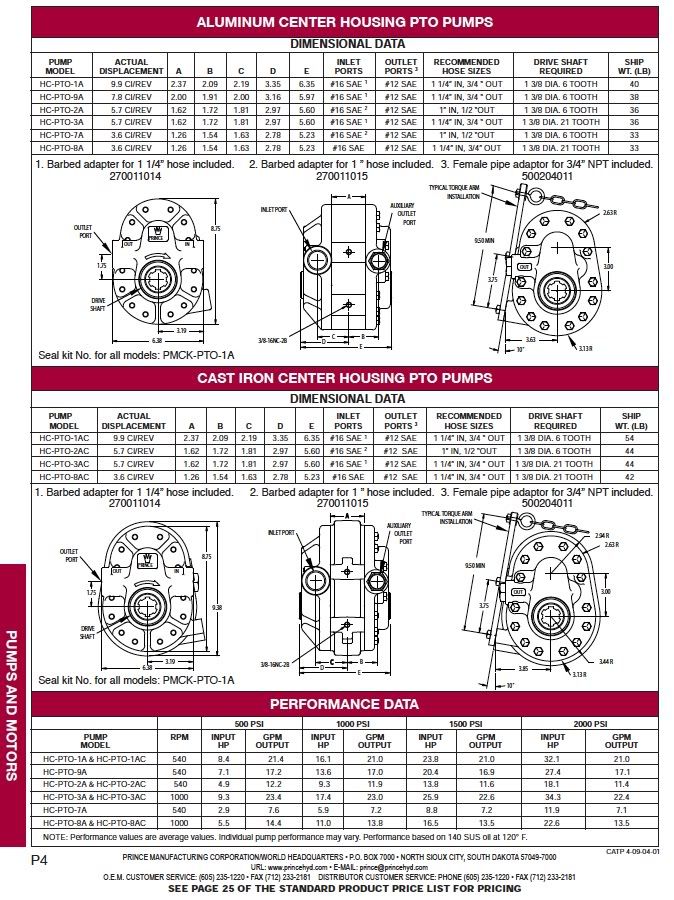

The Prince PTO pump is about $500 , then you need a reservoir/tank. filter, etc.

Might be more expensive but simpler using something like this:
I'd probably go for the 540rpm 4.9 ci pump so I wouldn't have to have the tractor running pto speed while splitting but rather a fast idle. If you did want to use it to power something else later you could use up to most of your rated horsepower.

If you need lots of GPM's, and have an extra reservoir at a 1:1 PTO gal to tank size, then the PTO pump will work.
You have to match up the GPM that the pump produces with the PTO HP your tractor has. The pressure on the PTO pumps is usually around 2250 psi
Your tractor has 20 HP rating for the PTO.
