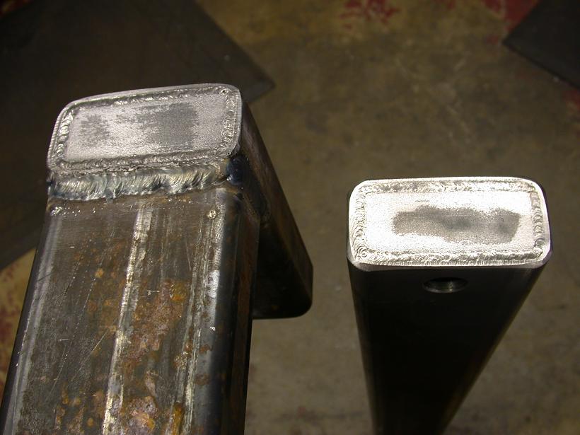

Here's a picture of the ends that I capped off to keep the dirt out. I fitted some ¼" thick plates in there and then TIG welded them shut.
