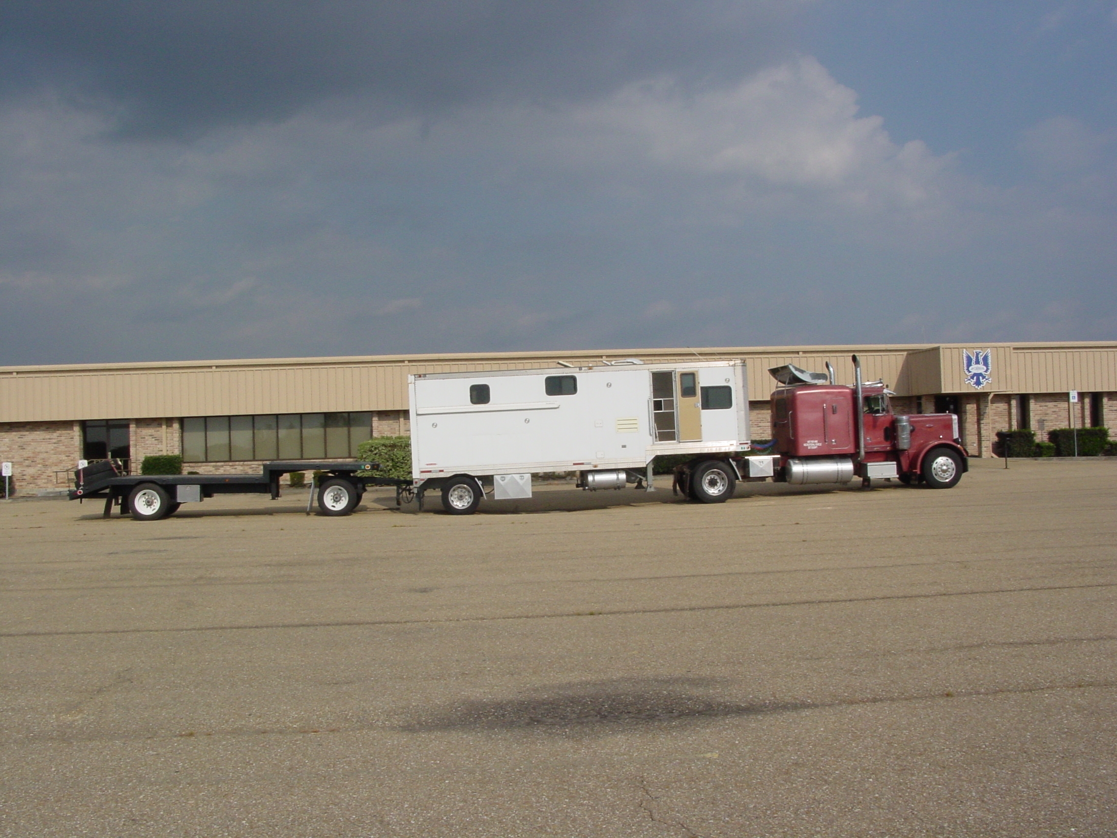

So, you’re saying a landscape trailer is a “semi trailer”?
Yes, it is.
It's not the size of the trailer that makes the difference, it's if part of the load is supported by the tow vehicle or not.
Simplest way to provide examples is probably to look at the commercial setups, even thought commercial or regular has nothing to do with it. The pictured tractor is pulling a white semi trailer, and it's obvious that the tow vehicle supports much of the load.
So what is the second (black) trailer then? It's also a semi trailer, but, it has effectively been converted to a pull trailer, using a so-called converter gear. Now it has an axle in each end handling the entire load. From a functional standpoint it's no longer a semi trailer.
As mentioned earlier, pull trailers are fairly rare. Semi trailers are the vast majority, and that includes landscape trailers. Put a permanently mounted smaller version of this con gear under the front of it and take the load off the tow vehicle, then it's no longer a semi trailer.
i can only hope that I didn't create even more confusion here, trying to explain that it's the front axle that makes all the difference. Without one it's a semi trailer.

So what do you call a converter gear (last picture) that has no trailer on it, but is hooked up to the bac of a trailer or a tractor. Jon
   / Share Pics of People Hauling or Towing Something Wrong #20,583
It's still legally a converter gear, or dolly, or whatever you want to call them, but technically it's a semi trailer even when by itself. Complete with its own license plate.
They have a very low tongue weight for being a semi trailer and is one of the few that you don't need to have the brakes hooked up on if there's no semi trailer attached to it.
PS. I was kinda prepared for that question.
   / Share Pics of People Hauling or Towing Something Wrong #20,584
The term missing in this conversation is "Pony Trailer”
A Pony Trailer has one or more axles in one group, usually near the centre of the trailer. It can be pulled by just about anything equipped with a hitch.
A Full Trailer has two or more axles in two groups one at each end of the trailer. The front axle group has to have some kind of steering ability, normally a turn table above the axle. It also can be pulled by just about anything with a hitch but there is no way to transfer weight, so the towing unit must have substantial weight to do it safely.
A Semi Trailer has one or more axles grouped at the back end of the trailer. It must be pulled by a Semi Tractor, the weight at the front of the trailer is transferred to the tractor through the fifth wheel which also gives the Tractor/Trailer the ability to turn.
A converter can be used to convert a semi trailer to the equivalent a full trailer. The converter is technically a Pony Trailer but is normally called a Converter or Dolly.
A Semi Trailer can also have a hitch on the back of it to hook up a Full Trailer (or converter / semi trailer). Which makes the unit a “A” Train. It can also have a fifth wheel on the back to hook to another Semi Trailer to create a “B” Train. It can also have 2 hitches on the back to hook a “C” train converter to make a “C” Train.
I think when you translate to private vehicles, the term “pony trailer” is changed to just trailer or bumper pull trailer, goose necks and fifth wheels although are technically semi trailer are simply goose necks and fifth wheels – probably because they want to call the towing units Trucks rather than Tractors, and the full trailers become farm wagons.

Yeah, I left out a few things in the interest of keeping it simple. Just including a con gear was a stretch, but it seemed like an easy way to show what a pull/full trailer is.
I have no photos of so-called Jeeps, for example, but most have probably seen them between tractors and semi trailers hauling very heavy stuff. Basically a really manly version of a con gear, with four or more axles.
But with those the idea isn't to make a pull trailer, rather to put the high weight (more than the tractor could handle) on a lot of tires to get the necessary load capacity.
