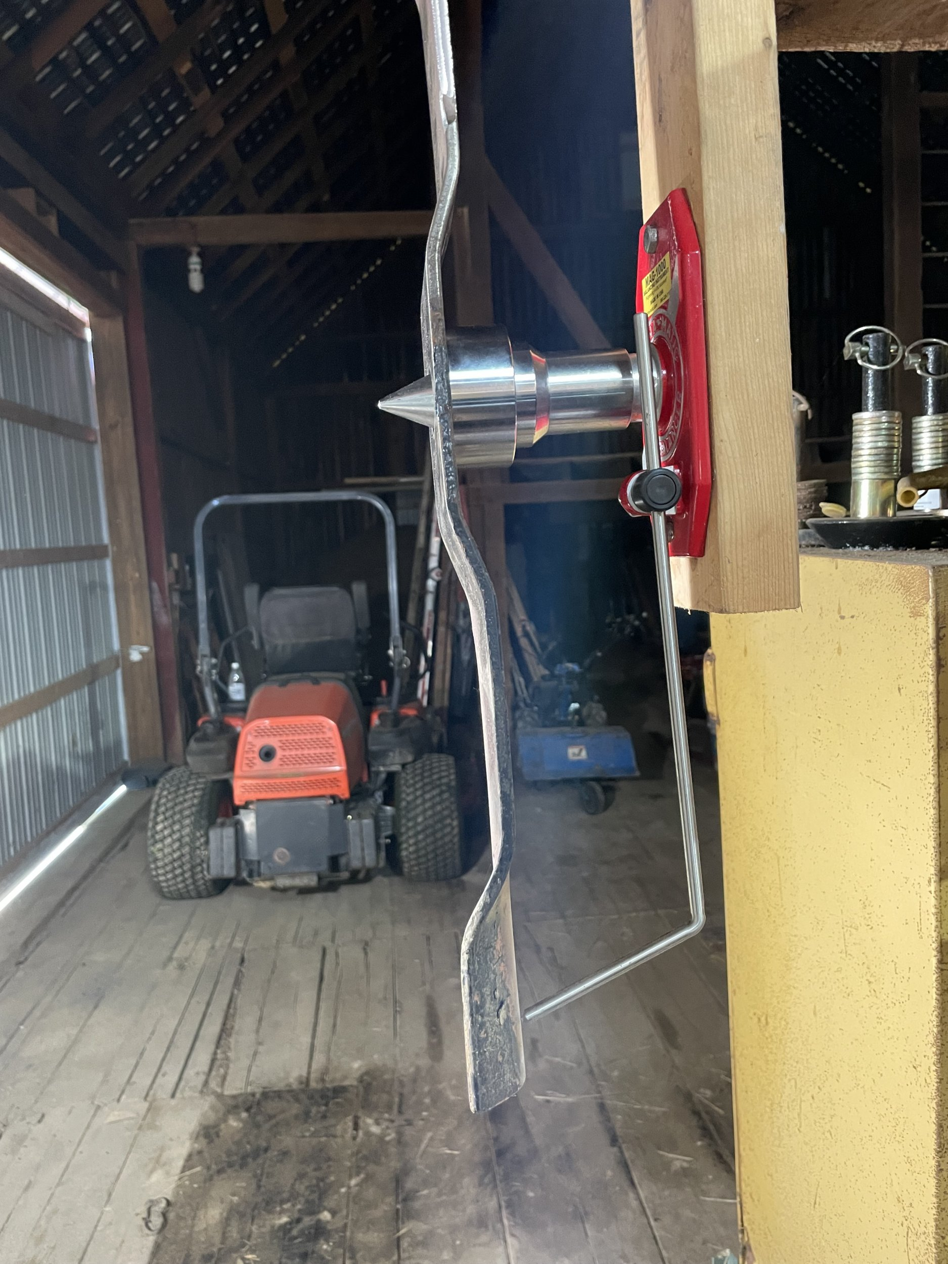

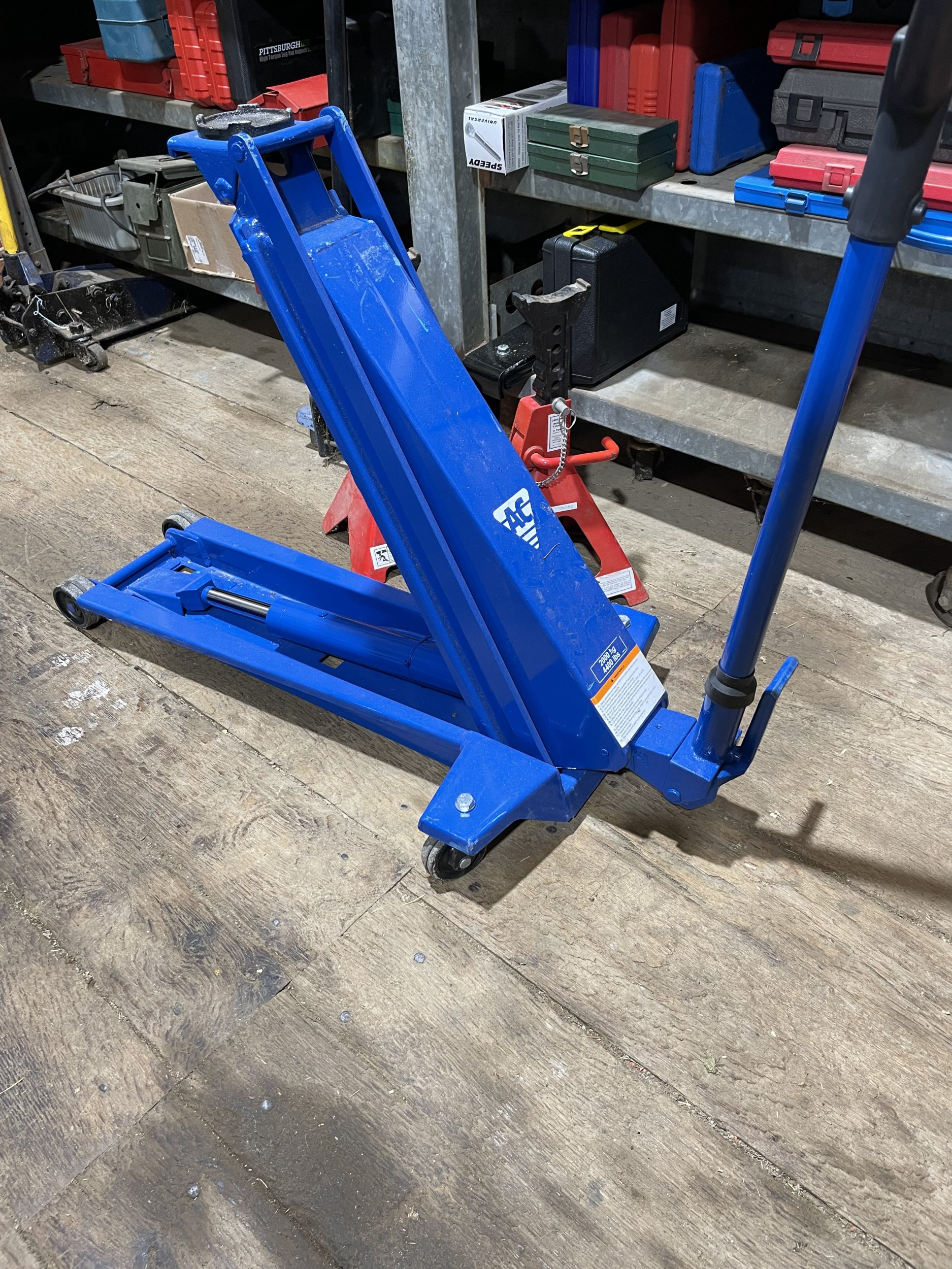

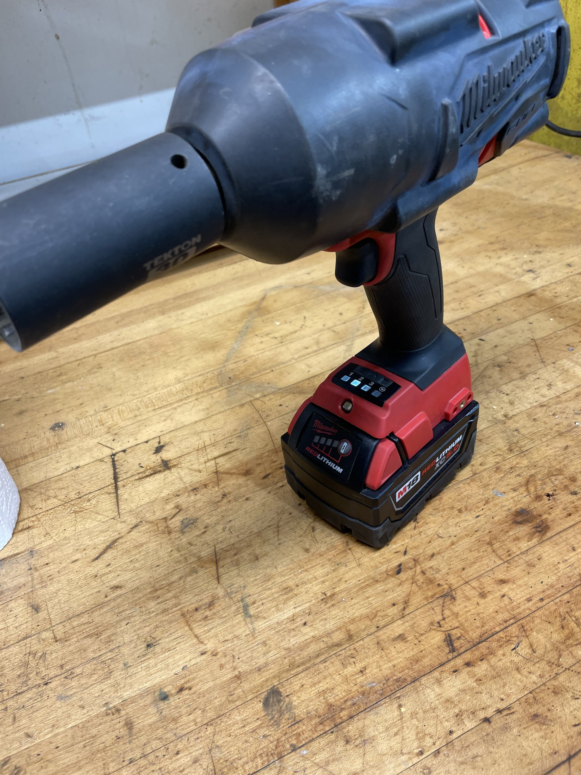

I have set up a way to sharpen, balance and check for bent blades that works well for me. A jig that is adjustable for the angle using a 4.5 inch grinder makes perfect grinds on the blades and a rotating hub with magnetic sleeve holds the blade to check for balance and check for run out to see if the blade is bent. Also a high lift floor jack and stands gives quick access to the blades underneath. An impact wrench set for the right torque makes it easy and quick to take the blades off and torque to spec so there is no rotational slips. Makes for smooth running mower and saves fuel and gives a good looking cut
