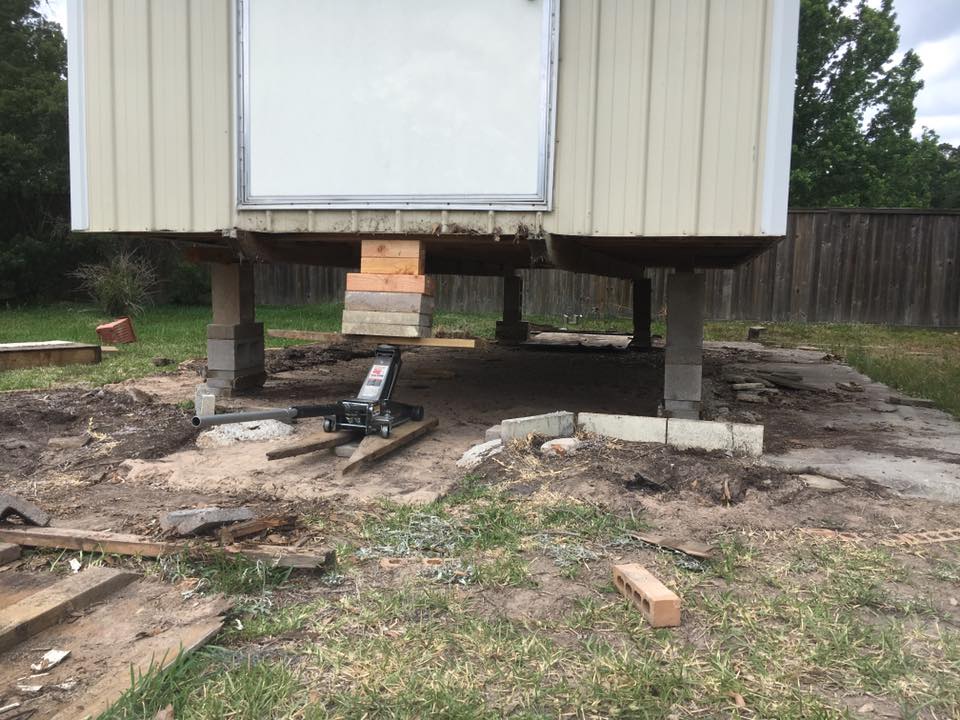

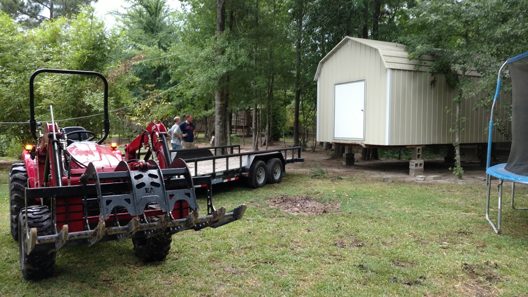

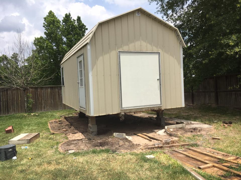

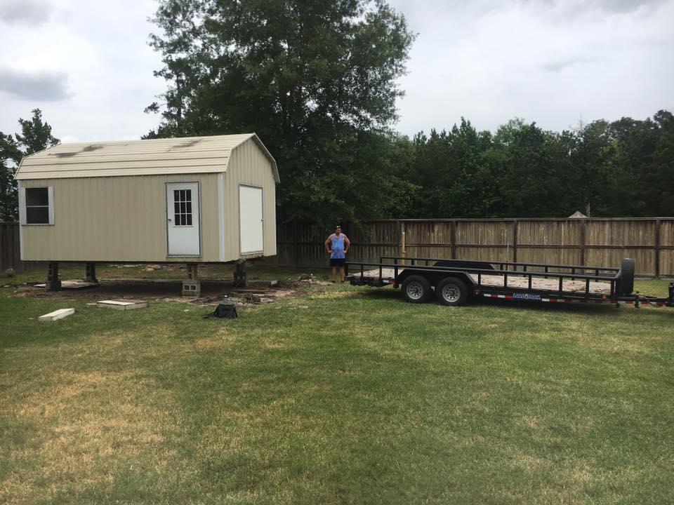

"I assure everyone that extreme safety protocols were enacted after I showed up with the 2538 and trailer."
That may very well be but you still used cinder blocks as cribbing. If one of them would have let go....

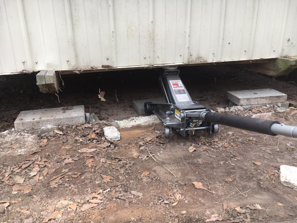

Totally agree. Having moved 3 buildings, I would have walked away from that one. Even the stacked blocks on top of the floor jack was stupid dangerous.

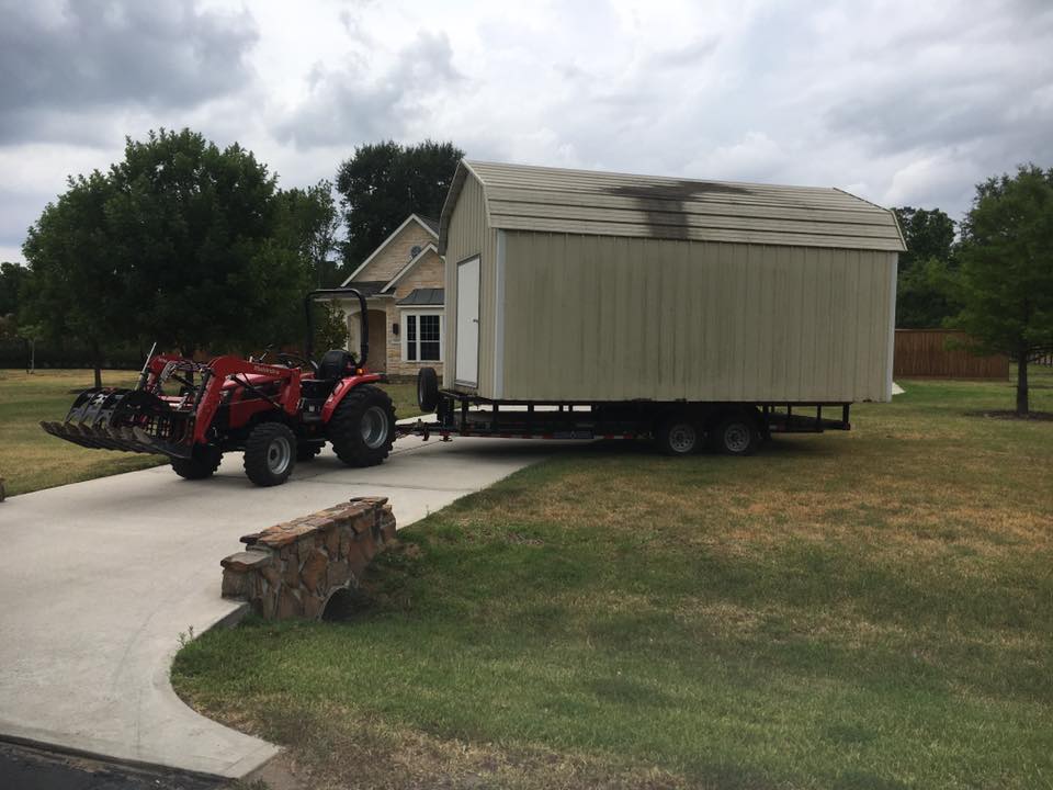

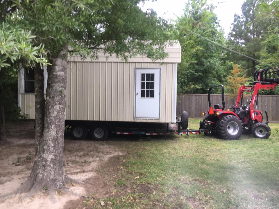

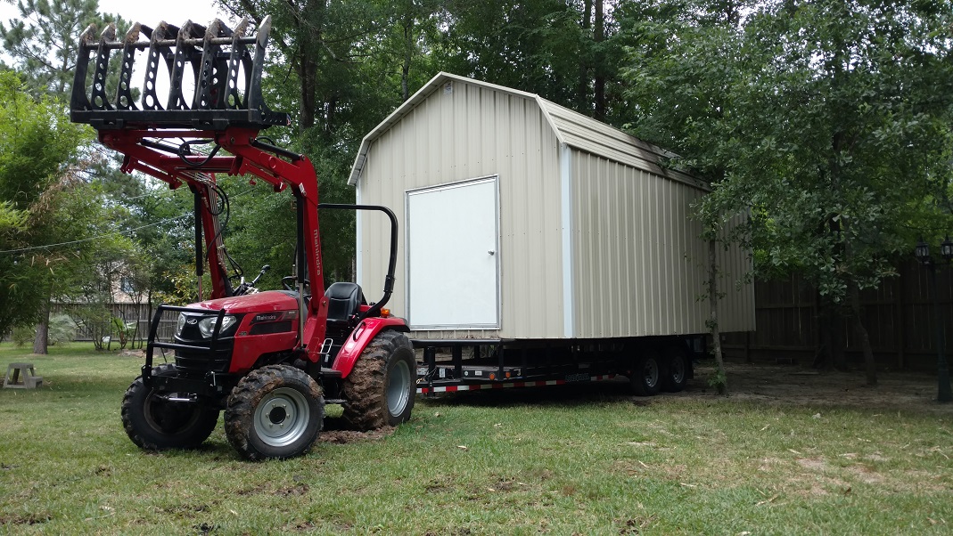

No SMV sign - No OVERSIZE LOAD sign - No lights - No Pilot cars...totally unsafe. This should go into the the Hauling Wrong Thread.
All totally in jest :drink: I can't see how a truck of any length would have been able to maneuver back there. Great job.
Did I forget my sarcastic face emoji? :D (Yes - you are right. The extreme safety protocol was mainly me yelling at people to get their heads and hands out of certain places...)
The thought of turning around the tractor and heading back home crossed my mind once as I showed up. That floor jack setup was the situation as I arrived. They had a 12' trailer there that was the original gameplan to haul it out with a truck. (Not sure how that would have ended.) Although I knew my wife would be upset that this was not in fact going to be a "30 minute" operation like I first told her, I decided that helping these guys out was in everyone's best interest. They are good people and I like helping folks out when I can.

I didn't see anything thing wrong with that move, I mean how much weight is there, how much lumber is that building made of,, that floor jack lifted it up, so tells me those cement blocks on all 4 corner can hold it, only 12x 20. I'd all that all day long on my small tractor, the trailer is holding most of the weight and it's on flat ground, everyone here have lace on their underwear or what. I bet I hauled more weight than that on my single axle woods trailer, 6' x 12' bed. Here's average load of logs, fresh off the stump, hauled uphill, over stumps bumps and through mud holes, vs. flat ground.
   / Shed Move with Tractor - Redneck Engineering #16
I don't usually say much about safety because all to often it's overdone as far as I'm concerned. Cement blocks on their sides are not very strong and I've seen them collapse under light loads. There is a good possibility that one slight bump could break a weak block and then it could be a domino effect with all the others breaking too. I know they are convenient, but they aren't anywhere's close to being safe to use.
I hesitated to say anything but if you get a person that see's those pictures and says "Hey look snowback got away with it".... And he did but I'm thinking it had more to do with his experiences at moving than just plain good luck.

I always keep some concrete blocks around when I am doing concrete work. The leftovers go into the block holes. Now I have a bunch of solid blocks when needed.

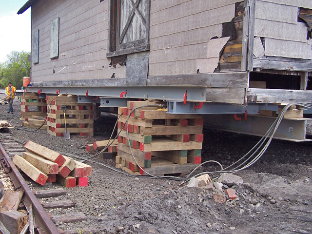

You are 100% right. I should have started with "Don't try this at home." I'll reiterate my earlier comments on this not being optimal and me doing a lot of yelling from a relatively safe distance. Should have had cribbing like this:
To be fair though - the shed was empty... :D

Just because it's 12' x 20' doesn't mean it weighs anything. Thin metal siding to boot!
1/2 it's weight is probably in the flooring and joists (cross members) Anybody want to guess on the over/under for 1500 lbs?
Was it tied down on trailer?
