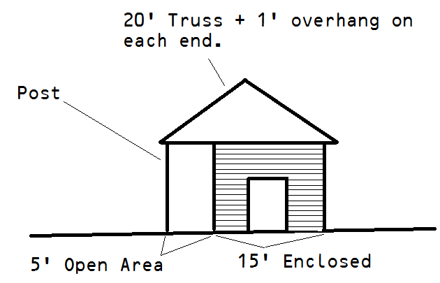

Hi,
I continue to plan my shed. I have an idea to include some covered area outside the shed. At first I was thinking about building the shed and adding a lean-to extension off one side... Then I started to wonder about getting longer roof trusses and extending the covered area that way. See my rough drawing for the idea.
Can I do this with normal (stock) trusses or do they need a special design?
I expect to put posts and a top beam to support the open space end of the truss, not a cantilever roof design.

As long as the post will be carrying the load I would think you could use normal trusses.

Sure it is not uncommon at all. I would suggest going 8’ on the large overhang (porch) with your 15’ enclosed and 1’ overhang on the building with a 24’ truss. Or enclose 16’ with 1’ overhang, 7’ large overhang and same 24’ truss.

The only way it would be a problem is if the truss was cantilevered out over the edge. Make sure you tell the truss manufacturer where the supports will be and they will happily make you a truss.

As stated above- no issue and it will use the same truss. Note the wider the truss the higher the ridge for a given pitch. That may not be an issue for you but for some it’s a factor. If it gets high enough they make storage trusses (no webbing in the middle) for lighter stuff.
As far as the posts and beams. Obviously the more posts the smaller and cheaper the posts and beams are. But the more footings and concrete. In general, posts that are 6-10’ apart seem to be the cheapest option. Of course you can go bigger or smaller depending on your needs or desired look.

Yes....you can use "normal" trusses but you will need a post under every truss, or a beam supported by posts upon which to rest the trusses.

When you buy, or order your trusses, you will tell them how far your span will be. The inside wall does not matter. So the distance from the wall on the right side, and the beam that will sit on the post on the left side is what they will need to know.
With that solid wall sort of in the middle of your span, you could easily build a rafter type roof with the center wall being load bearing. For me, this would be cheaper then buying trusses and then getting the trusses up there.

If you support the outer edge with a beam and posts you have no issue. If you dont want to do that, design the trusses to bear on the front wall and cantilever over to the front. Easier with the beam and post through.

Truss makers often have engineers on site that will work with your design. I had trusses made up to match an existing barn that I was adding on to where the overhangs were not even and were made with 2x6's. They made the new ones with 2x4's.
I see plenty of Amish barns with overhangs such as the one that you want with no outside posts. Never looked close though to see how the truss was made. I would think that with outside support, adding some 2x4's with gussets over the wall area would provide peace of mind if you just had a standard truss?

I would build the building with the 1' overhang, and add a reverse gable for your bigger overhang.
It looks better, and helps make the building look less like a barn.
As far as the trusses in the drawing go, any the interior wall should not be solidly attached to a truss.
The bottom chord of trusses need to be able to move up and down as the load on the roof changes. A truss clip should be used that is slotted so it allows the bottom chord to move up and down, where the walls are attached. Although, sadly many builders don't even know what these clips look like.
Attaching the wall solidly, can result in the trusses pulling the up on the wall, separating the joints in the wall, or pulling it off the floor, called "truss uplift".
The interior wall can also create an unexpected load bearing point on the trusses, if a roof load ends up causing the bottom cord of the trusses to sit on it. Ideally, the interior wall should be entered into the truss manufacturers specifications, so they can locate a brace there.
