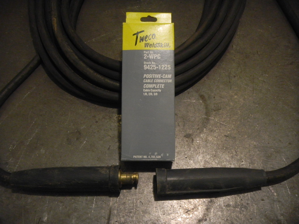

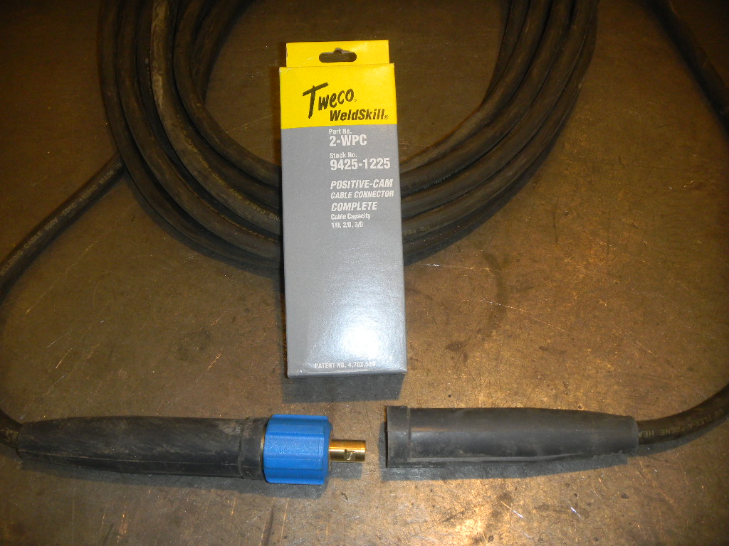

I use the Dinse to Tweco adapters.
   / ShieldArc's Amazon killer deal on Everlast??? #176
Dude!
Why all of yours tall and skinny when mine is short and wide?
   / ShieldArc's Amazon killer deal on Everlast??? #177
Do like Shield Arc and just buy Dinse to Tweco adapters to put on the machine. You don't have to buy genuine Tweco and you'll save a bunch of money. The Tweco style are all interchangeable and available just about anywhere. If they get loose, take a screw driver and widen the male plug. I've seen so many welders not realize that's what the slot is for and tape the darn things together.

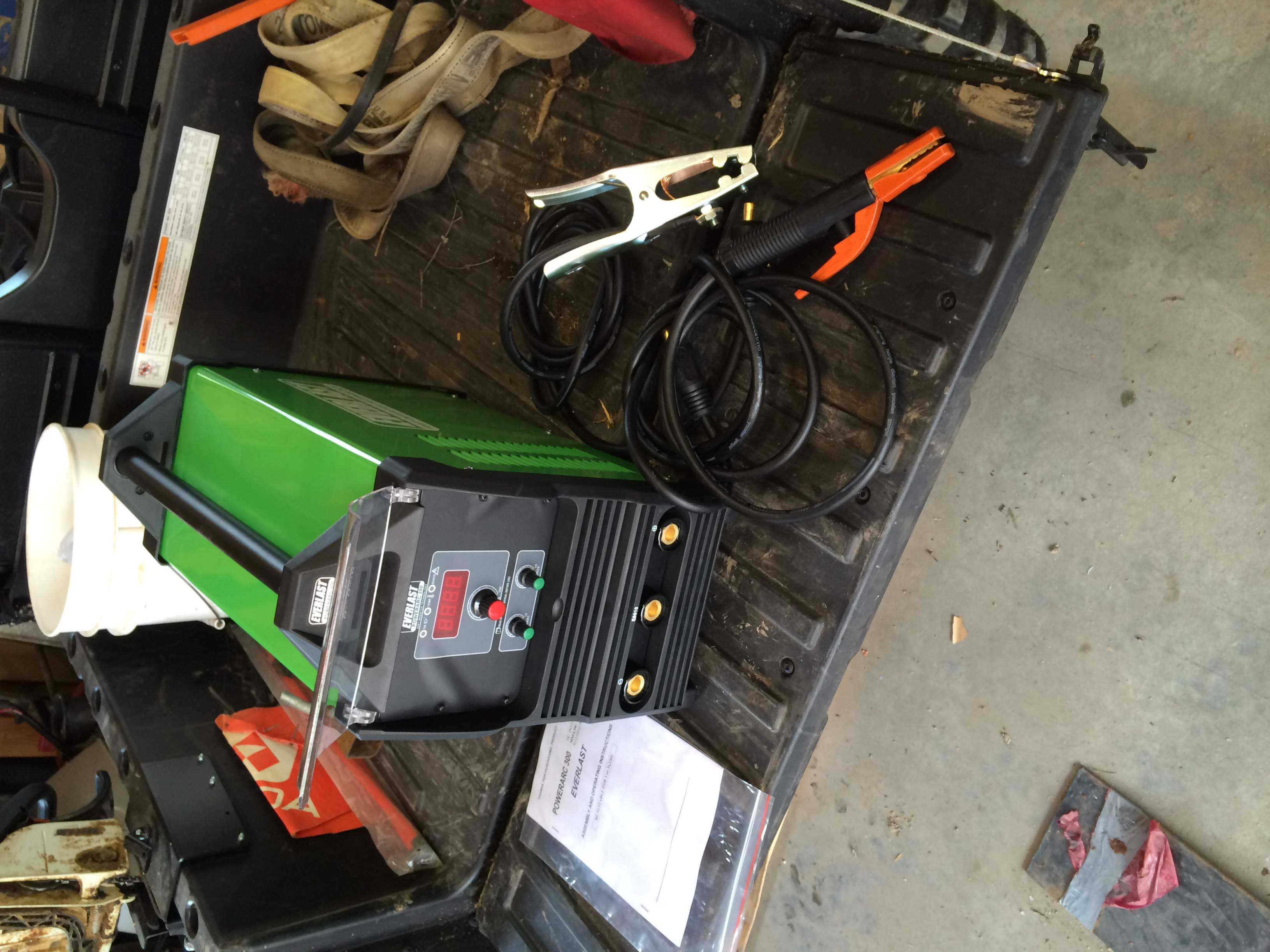

DUDE (It did work)
Tested 10/10
Inspected 10/16
