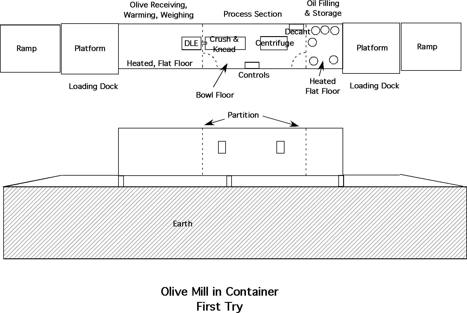

Here is my first cut at a layout for your mill.
I would elevate the container about 2 feet above grade, which means you can have a loading dock at each end, one for receiving olives in crates and one for shipping out oil in drums. You may want to use the ramps I show for your own olives, but if you process anyone else's they will probably bring them in by truck, and the loading dock will be very useful here. If you bring yours in by fork lift, the dock will work nicely.
I would put radiant heaters in each end, but not heat the process section where you would have four windows, two on each side to provide ventilation.
The most controversial part of this is that I would put two partitions, with doors, in the container. The partitions allow you to heat the ends of the container without losing all your heat through the open windows in the process section. The doors, and possibly the partitions, should have windows, so you can see what is happening in the process section without actually going in.
Olives are received and weighed on the left, and dumped into the DLE unit which washes them and augers them up, through the partition (I can show you how to do this easily later) and dumps them into the hopper of the crusher/kneader. On to the centrifuge and then the decanter. Oil comes out of the decanter in a pipe which goes through the partition, and a food-grade hose, with a shut off nozzle, is used to fill the drums. You will probably need a special filling station to contain spills, which I have not shown.
The finished oil is stored in the heated section at the output end. Again you have both a loading dock for putting drums into a truck or a ramp to pull them on carts.
The elevated container also allows access to the underside of the container for maintenance of the drain in the process section.
Let me know what you think of the concept before I add in details.
The only thing I am having trouble with is that I think the floors in the receiving and shipping ends should be flat, while the floor in the process section must be bowl shaped. This means there might be a tripping hazard going through the door, although I think we can minimize it. Maybe some of the guys in the trades can help out there.

The drain and the loading docks were the primary reasons I am thinking of elevating the container. With all the solids that are going to be washed down there, I think being able to get to it for maintenance is necessary. Especially when your season is only 6 weeks long. Any delay in fixing a blockage is going to be costly.
I am thinking the drain should be in the center of the floor -- put it at the side and you are constantly walking in it, in the center the machinery straddles it, and you can't walk there because of the machinery.
The size and shape depends on whether vinyl is OK. If it is, either your idea of sanding, or just splitting sheets of plywood and just using sleepers under them will work. Make the drain wide enough so that a standard shower drain can be installed in the flat bottom. The exact design awaits clarification from rox on the workability of vinyl.

Dave, I'm thinking the floor material will be dependent on what are the definitions of waterproof and fireproof according to local regulations. Of course, center drains will work, but I'm thinking the materials to be drained will not drop directly below the machines, but in the spaces between/beside them. I'm betting that in the open mills, drains are not located below machines, but in central open areas because working to get materials in a drain below the machines could be difficult. What do you think?
I like your design for segmenting the inside of the container and also raising it so that you can build an earthen ramp or just back a trailer up to the container like a loading dock and move the materials in/out without having to lift them, or only slightly lift them.
