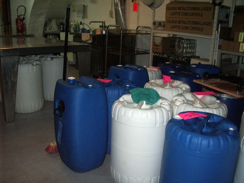

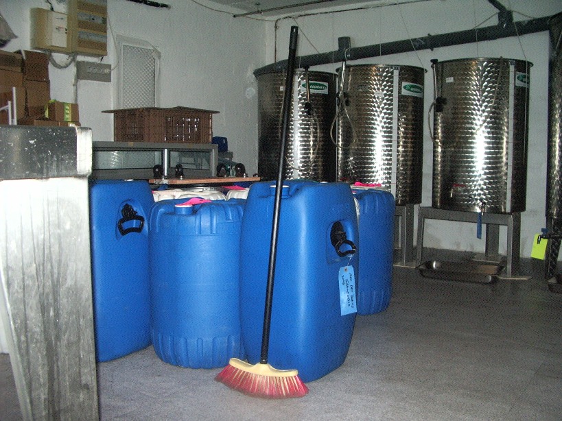

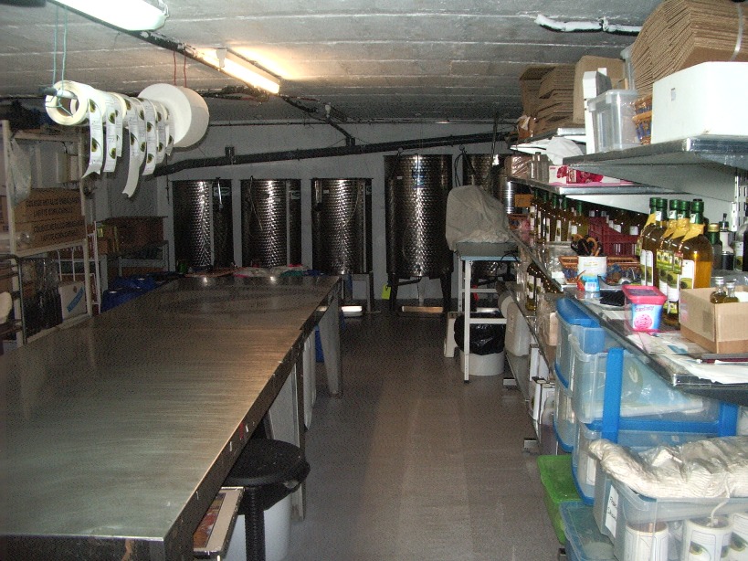

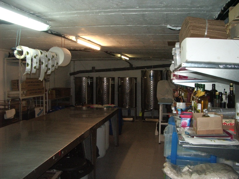

Dave If you look at the flow chart previusly previously posted I included a pic of a typical olive crate, it is yellow. Our mill will process about 240 of these crates per day. It will press 200 kilos per hour. The big question is the yield of the olives. Some olives yield 23% of their weight in oil, some 14% of their weight in oil. Figure on the attached pic we will produce 4 of the tanks plastic you see shown. I laid a broom on a tank to give you perspective. I hope everyone can see and appreciate how clean our olive work room is. It is spotless, we want to work in a clean environment!
