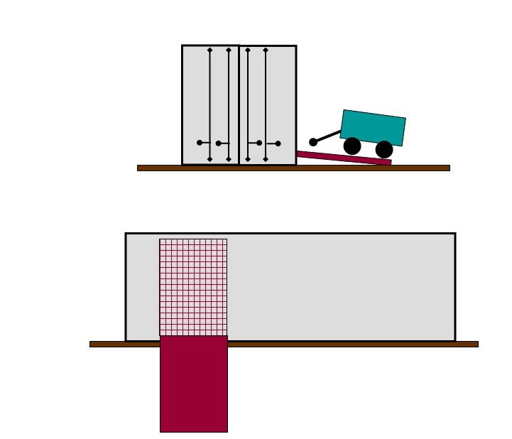

I'm also thinking of other ideas like fold-down doors on the side of the container that allow access as ramps and also provide more open area inside. If you had a fold-down door you could add a canvas canopy (fold-out) above and maybe curtain walls. You could enter or exit the container by these ramped enclosures. Raising and lowering the ramps could be accomplished with ropes, pulleys, and counterweights for ease of operation (not drawn). They would also improve your ventilation tremendously.

So far I've heard whatever is used has to have fireproof floors and walls and not be considered a permanent structure. It is also understood that the container idea is fixed!
So, assuming the container is so designed to be supported on the four corners and has a metal floor lined with plywood and no idea of the walls other than metal on the outside.
Locate the site. Install a piling for each corner. Cut out the floor area for the press and pour a cement foundation for it. Skin the floor using concrete and put the proper slopes and drains on it. [Not very hard to do and the container should be able to support this with no problem.. Just use ordinary high strength concrete with no rebar or wire mesh for cost purposes. Cut out the doors and other access points as required and use the cutouts for fabricating the new doors. Have the doors open out wards so they do not constrict inside space. Build dirt ramps for the access doors. Cheap.
Install several ventilating fans high up one at each end. Bathroom fan would work.Install one pressurizing fan at floor level in the center of the container. Again bathroom fan. If the walls require fireproofing use a stucco or cement slap on and trowel smooth product. Don't worry about insulation.

The 40ft Sea Container really does seem like the best fit for what you need. To make it work, the biggest issue seems to be the drainage of the floor. Figure that out, and the rest is pretty basic.
One of the problems that I’m having is how to slope the floor to get to the drain. Then installing the drain has me a bit perplexed. At first, I thought you would have to center the drain on the floor, which would mean cutting a hole in the floor and tunneling under the container to get to that location to install your pipes. I’ve realized that this isn’t the best way to do this.
I think Jim mentioned side drains, but I didn’t get it at first. Now I think I do. I would put in three drains. I would cut holes into the side of the container on the side where the sewer lines have to run. Those holes would be similar to the cartoon mouse holes that you always saw when watching Tom and Jerry, or some other cartoon. I would then create a catch basin at the bottom of that hole in the wall where the water will run down and into the drain. You’d have to work out a way to seal it up from the elements, but that shouldn’t be too difficult. The idea is that the water will run into the hole in the wall, and then down into your drain line.
This will allow you to slope the floor from side to side. A one inch slope over the 8ft width of the floor is now pretty simple to do with mortar or whatever is available there. I would contact your tile guy and ask them what they use when they do a shower floor. With three drain lines, you could easily have a barrier along the low portion of the wall that would resemble a big base board, which would help channel the water to the drains. With water on the floors, you will need some sort of waterproof baseboard all around the walls anyway. Maybe what you end up using for insulation will also provide a water proof barrier to direct the water to the drain lines?
With any drain line going into a septic tank or sewage line, there has to be a way to block the sewage gasses from coming back up that pipe. Traps are used to hold water in the lines and block those gasses from coming through. Be sure to include them in your drain lines, or it will be very nasty in there. With the drains being outside of the container, it would be allot easier, faster and cheaper to install them. You could also run your vent lines right up the side of the container. Again, it would be so simple this way that there really isn’t any other way to do it.
