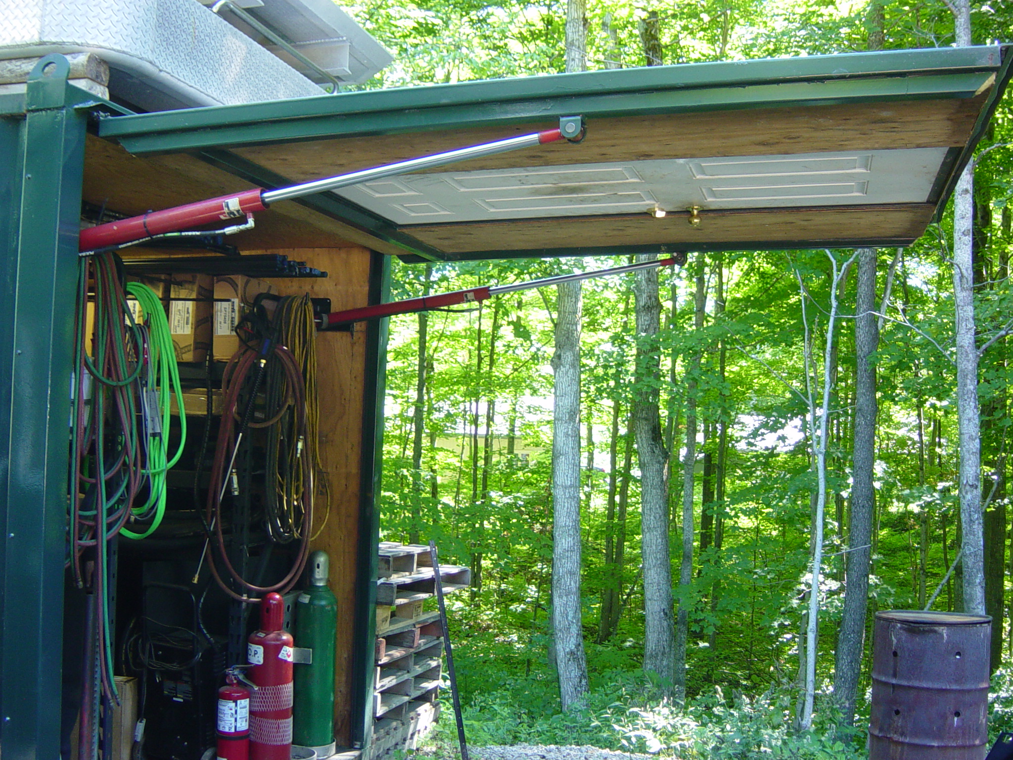

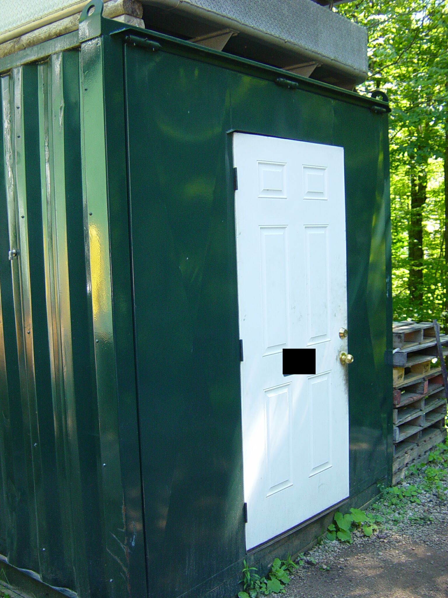

Pictures of my friends container as promised.
   / Shipping container for tractor storage #84
Nor a sadistic operator at the controls if you don't quite make it in on time. Cylinders are after all, double acting!
   / Shipping container for tractor storage #85
I wonder why he did away w/ the original double doors.
What he offers is a bit of shade over the steel double originals.
   / Shipping container for tractor storage #86
He cut down a 40 foot and did not get the end with the doors for one. Yesterday, he mentioned that having barn doors would get "OLD". Maybe it's hard to put a man door in one side of a normal door.
OR, I guess, because he can. He is an incredibly talented and capable young man who astounds me every time I go there.

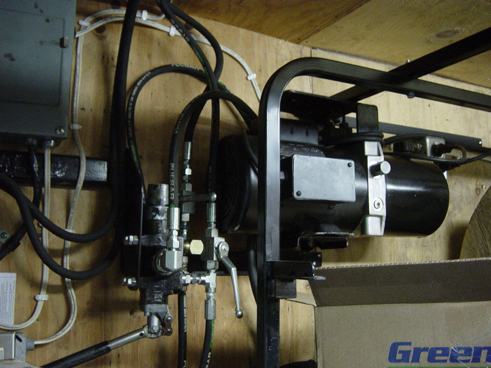

   / Shipping container for tractor storage #88
This young kid does hydraulic hoses, tubing and fittings. He has a better selection and stock than probably anybody in a 100 KMS radius. Maybe more. That helps! Shame doesn't begin to describe how he makes any of the "dealers" around here look! Remember, this is canada. He made me up some stainless hydraulic hose yesterday.
   / Shipping container for tractor storage #89
We think he has done a first rate job.
